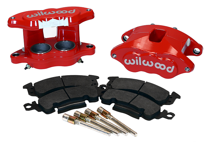

bigscaht Posted October 31, 2012 Posted October 31, 2012 ($404.99) ($449.95) Both kits are stock upgrades..both fit under stock rally rims & work with stock type pads and stock size rotors. Im surprised the SSBC kit is more expensive but which kit would yall choose and if theres any one with products by either company, how do you like the set up???? Quote

bigscaht Posted October 31, 2012 Author Posted October 31, 2012 yeah I like the dual piston look also..im thinkin bout goin with the wilwood set up cuz the calipers look better to me & their cheaper Quote

evman140 Posted November 12, 2012 Posted November 12, 2012 Didn't realize there was an option from Wilwood posted... They actually publish their numbers (saved me the work doing the math!) and they are competitive with the factory single piston surface area- Factory: 6.47in^2 Wilwood: 6.28in^2 SSBC: 4.49in^2 I think the Wilwood option is best; saves weight (also made from alu), maintains 97% piston surface area and looks better! Quote

bigscaht Posted November 13, 2012 Author Posted November 13, 2012 yeah that BMR set up is nice but a bit pricey for me..I think imma go with the Wilwood setup and some nice drilled & slotted rotors! and call it a day until I get the money to change the rear to disks! Quote
