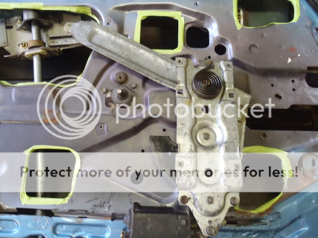

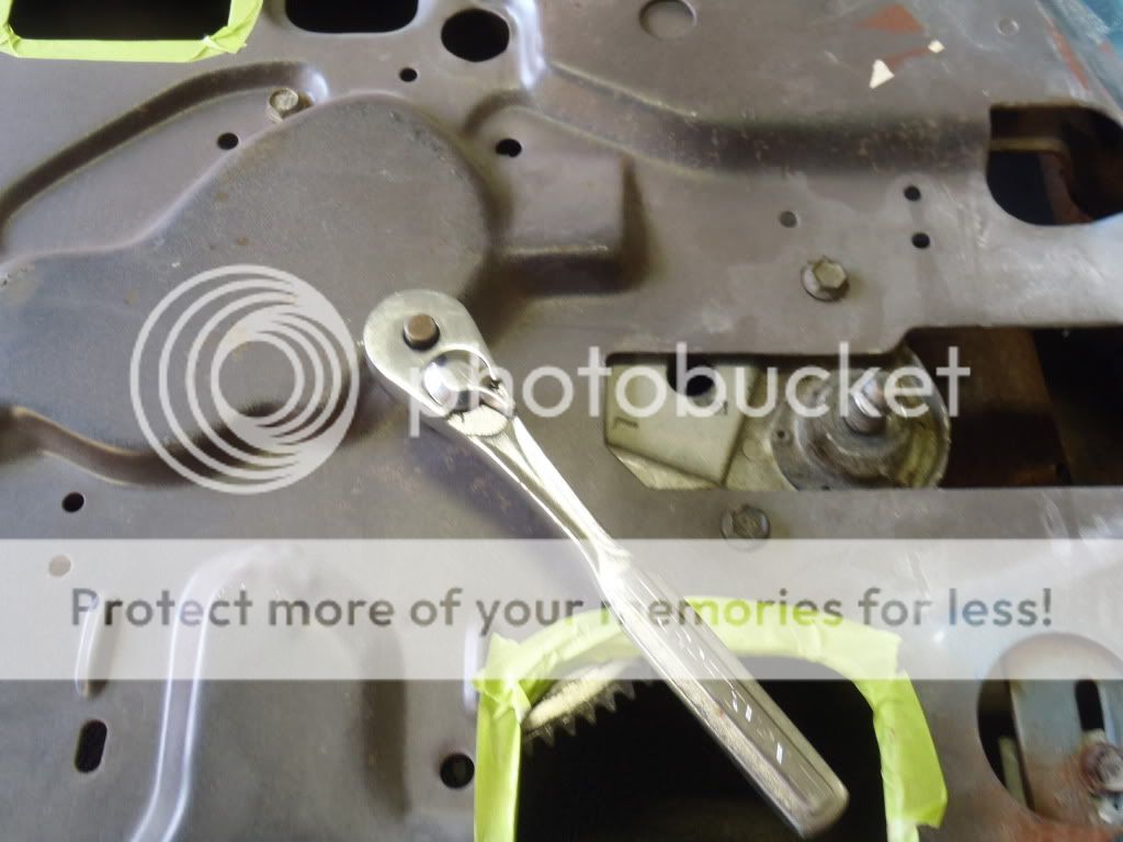

MCfan Posted November 1, 2012 Posted November 1, 2012 Hey, Bob, I installed power windows in my '70 last spring and took lots of pictures so I might be able to help, but honestly, I really don't understand everything in your post. For example, what do you mean when you said, "...the front I have in the rear nothing lines up ..." If you are asking about the four mounting hole locations for the electric regulators I can tell you they are NOT the same ones used for your manual regulators. Also, the holes for the electric regulators should already be drilled in your door, you just have to correctly identify which ones they are. You should NOT have to drill any mounting holes in your door and DON'T try to reuse ANY of the four holes that held your manual regulators in place - use the other four holes instead. This photo shows the manual regulator mounting bolts being removed. You can clearly see the four mounting holes for the electric regulator already in the door (2 above the ratchet and 2 below - left hand one is slotted). This photo shows an electric regulator positioned roughly as it will be once you get it inside the door. Look for the four mounting holes in your electric regulator frame and then look for four holes in your door that correspond and use them. Forget the holes that were used to mount your manual regulators! This photo shows the electric regulator mounting bolts being tightened. As you can see, they are in completely different locations from the original mounting bolts. Sorry if I am not understanding your question. Feel free to try again. Quote

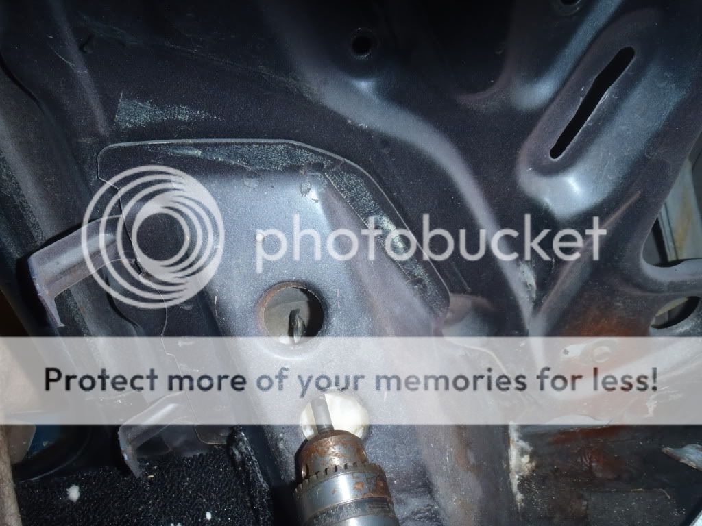

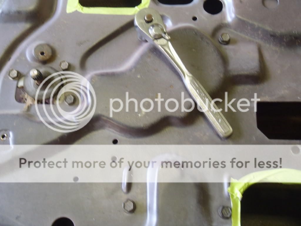

MCfan Posted November 2, 2012 Posted November 2, 2012 Okay, Bob, I think I got the part about your problem being with the rear windows and that requires a different answer and different photos. All three of the pictures in my first post were of the driver's door/window. Following are photos of the passenger side rear window: First, something you already know ... the bolt locations of the manual regulator. NOTE: you can clearly see the top two bolt holes for the electric regulator BETWEEN the upper and lower mounting bolts of the manual regulator in this photo. Do NOT try to reuse any of the four original mounting holes for your electric regulator. Next, YES, you will need to drill the two lower mounting holes and they are in hard-to-reach places as Darren has already replied. Look for the dimples in the locations shown in the following photos and drill the proper sized holes. In the first photo, you can barely see the dimple for the second hole to the right but there is also one under the tip of the drill bit in this photo. These two holes are for the lower mounting bolts of the electric regulator. There is one more hole you need to drill/cut down there for the wiring harness grommet as shown in the photo below. Now you can insert the electric regulator and bolt it up using two pre-drilled holes on top (NOT previously used by your manual regulator) and the two new holes you just drilled on the bottom. Everything should fit and bolt right up just fine. The hard part of this job as I remember it is getting the &$%#! electric regulator into place. I had to set a 12 V battery on the rear floor and use long leads to reposition the arm several times to get mine into place so good luck with that! This photo shows how the electric regulator is bolted in (the lower two bolts are barely visible) and how to route the wiring harness through the new grommet hole you cut previously. Hope this helps. I never got around to completing my photo journal last spring because I left Florida right after I installed the power window and door locks. I'll try to get that organized and put captions on the photos if that will help you out. Good luck, Bob, maybe you've done this before, but I found it to be a non-trivial project. Quote
