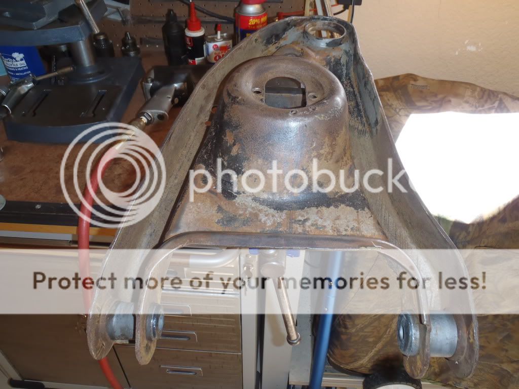

Hey, Scott,
In regard to your question #2, there are two weep holes in your lower control arm at the bottom of the spring seat (see photo below). As Carl has already advised, positioning the end of the coil spring in the obvious "pocket" in the spring seat will give you plenty of exposure of the weep holes. In the photo below, you can see the backside of the "pocket" (the shiny spot) for the end of the spring just to the right (counterclockwise) from the two weep holes.
Here's another photo showing the other side of the control arm but the light from the flash makes the "pocket" appear as a dark spot to the right (clockwise) of the two weep holes.
