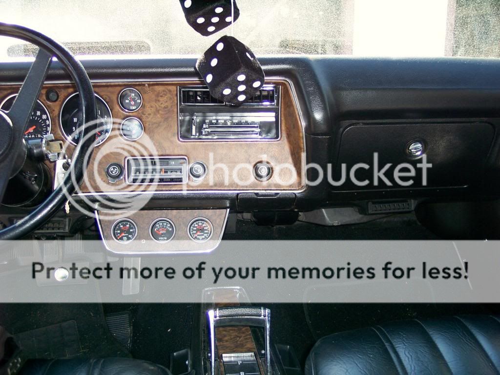

72-CLASSIC_RIDE Posted July 21, 2013 Posted July 21, 2013 After a few months of defining a Gauge Pod friendly to our 1st Gen Montes, it finally arrived though the mail yesterday! Was a little apprehensive as a whole lot of info and ideas were shared for this design. Spent a bunch of time discussing mounting location, Gauge Pod fastener concepts let alone determining the dimensions of Pod, under dash contours and Dash surface area available for mounting. Well today I can say it was a GREAT success! It is mounted under dash just waiting to be wired. I selected the location where I was most comfortable with, chalked out the borders and determined fastener location. Once satisfied I attached (2) Clips to underside of dash where face end of Pod will be secured. (This was a idea I had to make mounting a little quicker). A bridge was built just back from Pod face that spanned Pod face end and was located in such a fashion that to secure Pod to under dash, Pod is held up against under dash forward of clips and then slid back where clips slip under bridge aligning/positioning it while holding it securely. The Pic's are more explanatory. I also spent extra time creating a mount for my MP3 Radio Jack where I can plug in my MP3 player and listen from radio. Handy when there are no radio signals and your radio is stock! Spent about 4 1/2 total hours on it. Wouldn't have taken so long but because I wanted to take notes, pic's and evaluate concepts, this is the time spent. The depth of the Pod is deeper than would actually be needed but in light of having the Gauges / wiring hidden from view, I elected to keep depth as is. Â Here is what it is: Â These are the clips that secure, align and position Pod in location: Â Here is the Pod shown with bridge across face end that clips pick up when sliding Pod back toward firewall: Â Here is the Gauge Pod secured into position where it will be located: Â (Footnote) I haven't decided if I will secure "L" brackets to rear of Pod as yet. The clips hold so well, I am kicking around the idea of just adding some thin shims each end at rear of Pod adding more resistance for any possible up/down movement of pod when driving. Easy to remove / easy to replace Pod without using any tools! Â Tomorrow the wiring! Â Doug

72-CLASSIC_RIDE Posted July 21, 2013 Posted July 21, 2013 I should mention that I did not do the actual construction. I just helped figuring the dimensions, provided technical input for the final design. The guy I convinced to build the Gauge Pod was making them exclusively for 68 / 70 Cutlasses. He also did custom Pod Housings for Radio's etc. I thought what he made for the Cutlass was so 1st Gen Monte Carlo looking, he should consider expanding to include our cars as both Chevelle and El Camino share the same Dash Configuration. Pretty large market for those that like Old School! This Gauge Pod is the result! Â Thanx for the Props. I really like it!! And as of today, I can say its a one of a kind! Â Doug

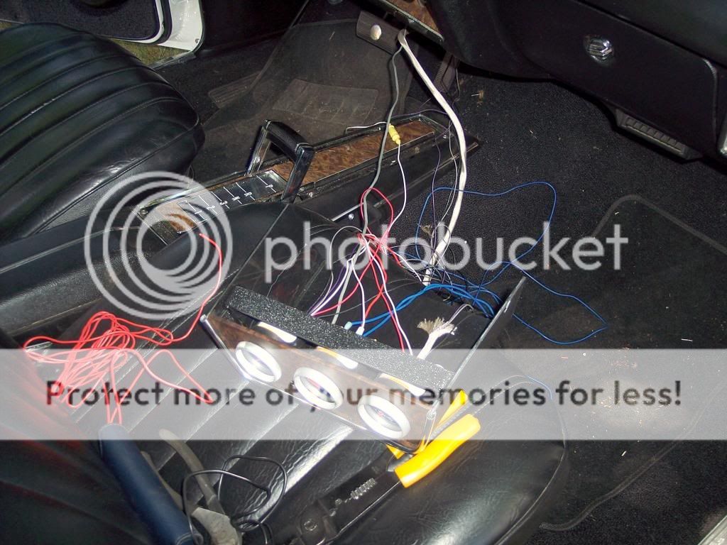

72-CLASSIC_RIDE Posted July 24, 2013 Posted July 24, 2013 Spent Sunday plumbing the ole girl for gauges. What a pain. You could not make a move without something in the way. Was very frustrating! Â Took Monday off to recover! Â Today strung the sender wiring from engine bay into cabin. Again, very frustrating due to lack of workable space! Â Tomorrow I should have wired and functional. Studying instructions tonight and design a plan to make for a final seamless install. Yeah, Right! But when it's done I just need to get over the nightmares from tackling this project! Â Doug

72-CLASSIC_RIDE Posted July 25, 2013 Posted July 25, 2013   Finished installing gauges today Turned into a larger project than had anticipated but all gauges now fully functional. Nice to be able to read actual oil pressure Pic's another day. I am exhausted and ready for a cool shower. 89 degrees today  Doug
72-CLASSIC_RIDE Posted July 25, 2013 Posted July 25, 2013 Had to figure out how to recover pic's from camera to upload finished project, so here is a pic wiring threaded through firewall and attached to gauges then installed with gauges operational. Whew!! Â Â Â Now to clean up the mess made to the interior. Â Doug

72-CLASSIC_RIDE Posted July 26, 2013 Posted July 26, 2013 Originally Posted By: 72-CLASSIC_RIDE Â What is the wire for between the gauges? Â Shown is a MP3 player Jack with Zune plugged into it. Comes in handy for those low/no radio signal frequencies. Â Doug
