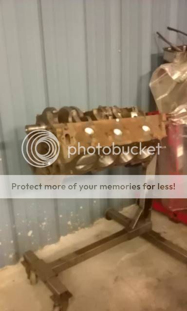

stickshift Posted January 19, 2013 Posted January 19, 2013 Hey guys, been a while since I posted (like two years or something), but I am finally making some progress with my big block. I should have it in the car and running in a few weeks. We have it sitting in the Dyno room ready for start up. The combo so far consist of a 60 over 454 block, big dome Mahle pistons,Lunati Voodoo camshaft Duration 276/284, Lift .554/.572, noisy gear drive, roller rockers, oval port heads with 2.25-1.88 valves, and an RPM Air-Gap intake. I still have to get a water pump, distributor, Headers, and Carb, It will be on the dyno, I am hoping for some decent numbers. I am posting some pictures, Let me know what you think. Any last minute advise you guys can provide will be greatly appreciated. Thanks. Quote

Mike 57 Posted January 20, 2013 Posted January 20, 2013 Looks really good! Flat or roller cam? What made you decide on the noisy gear drive? looking forward to some numbers Quote
502ci Posted January 20, 2013 Posted January 20, 2013 Welcome back. Glad to hear you are getting the Monte running, that's one radical cam you listed... Â Any last minute advise you guys can provide will be greatly appreciated. Thanks.[iM Change the "noisy" gear drive now to a quiet one (those are still noisy) while it's still easy... Quote
stickshift Posted February 1, 2013 Author Posted February 1, 2013 Thanks guys, I'm running a flat tappet cam. I have a Pete Jackson noisy gear drive in my small block, and I love the way it intimidates people when I pull up at cruise ins so I decided to run one in my big block. I cant wait to hear how it is going to sound. I went by the machine shop a few days ago so that we could start it up in the Dyno room, but they had a small block stroker motor that they were trying to finish. I will continue to keep you guys posted. Also, will my Super T10 tranny and 3:55 10 bolt be enough? If not what would be a good replacement for the rear end and tranny? Quote

72 LS5 Posted February 6, 2013 Posted February 6, 2013 Looks great! Do you have the cam specs at .050"? Decide on a carb yet? Quote
Machtuck Posted February 10, 2013 Posted February 10, 2013 That's LUN pn 60204. Peak power on the 468 should be right around 6000. Maybe more if your using the lunati springs ( pretty high seat and open press). Looks great! Nice choice on those Mahle pistons....light weight and strong. Do you have the pn on those? Quote
