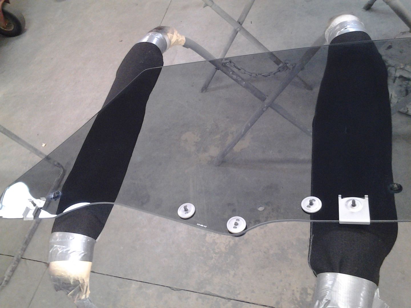

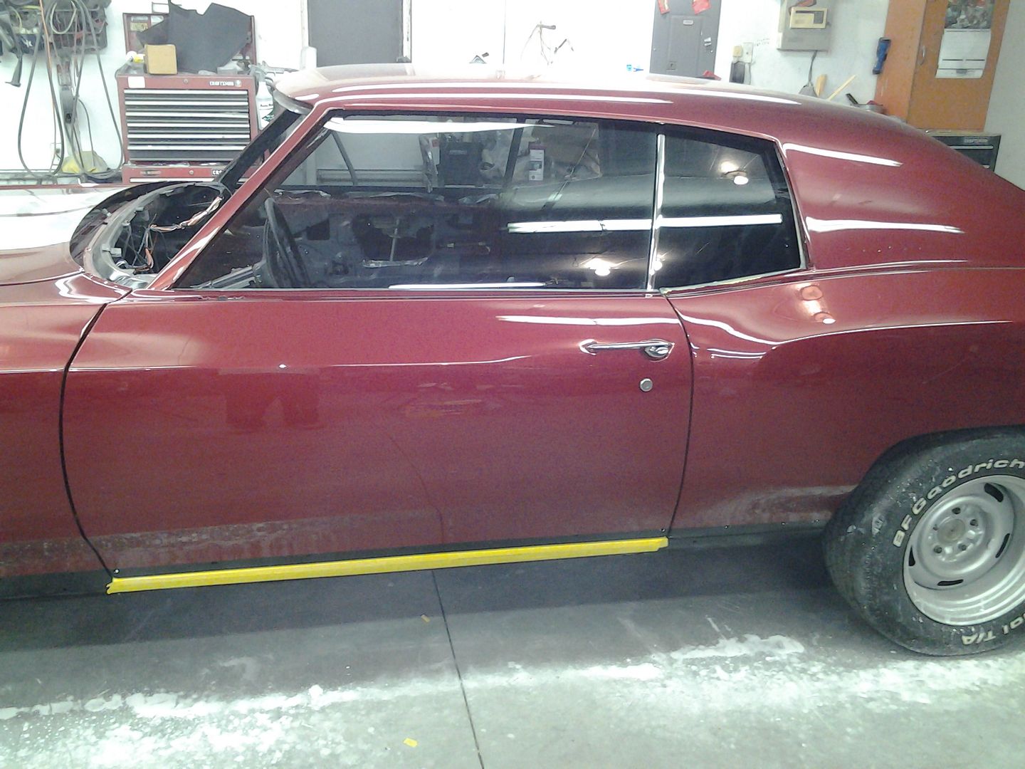

Got a few things done today, put in all new locks & got the door glass, power window regulators, & the rest of the door guts in. Moving right along with only a few pesky (is that a word?) things fighting with me. Glass is looking good cool

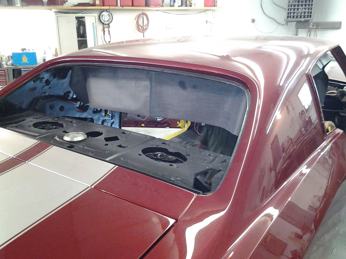

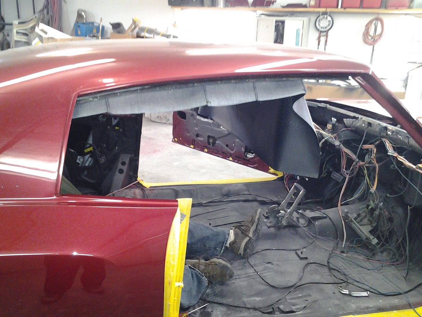

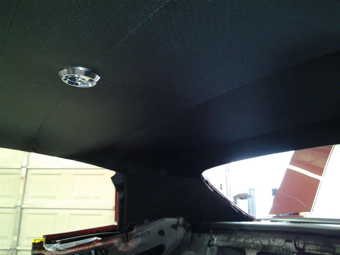

Got the headliner & package tray installed, currenty still putting stuff on headliner/roof interior etc. Took a break for a minute to eat dinner & post some pics, will go going at it till 4 am or I fall down whatever comes first tired
good picture of Gary my healiner guys feet, hes a little camera shy. Great guy coming out & helping me on a holiday weekend, hardly drank any beer & didnt even charge me double lol
Some things should just be left to professionals, I dont have a clue how to install a headliner, well now I do smile

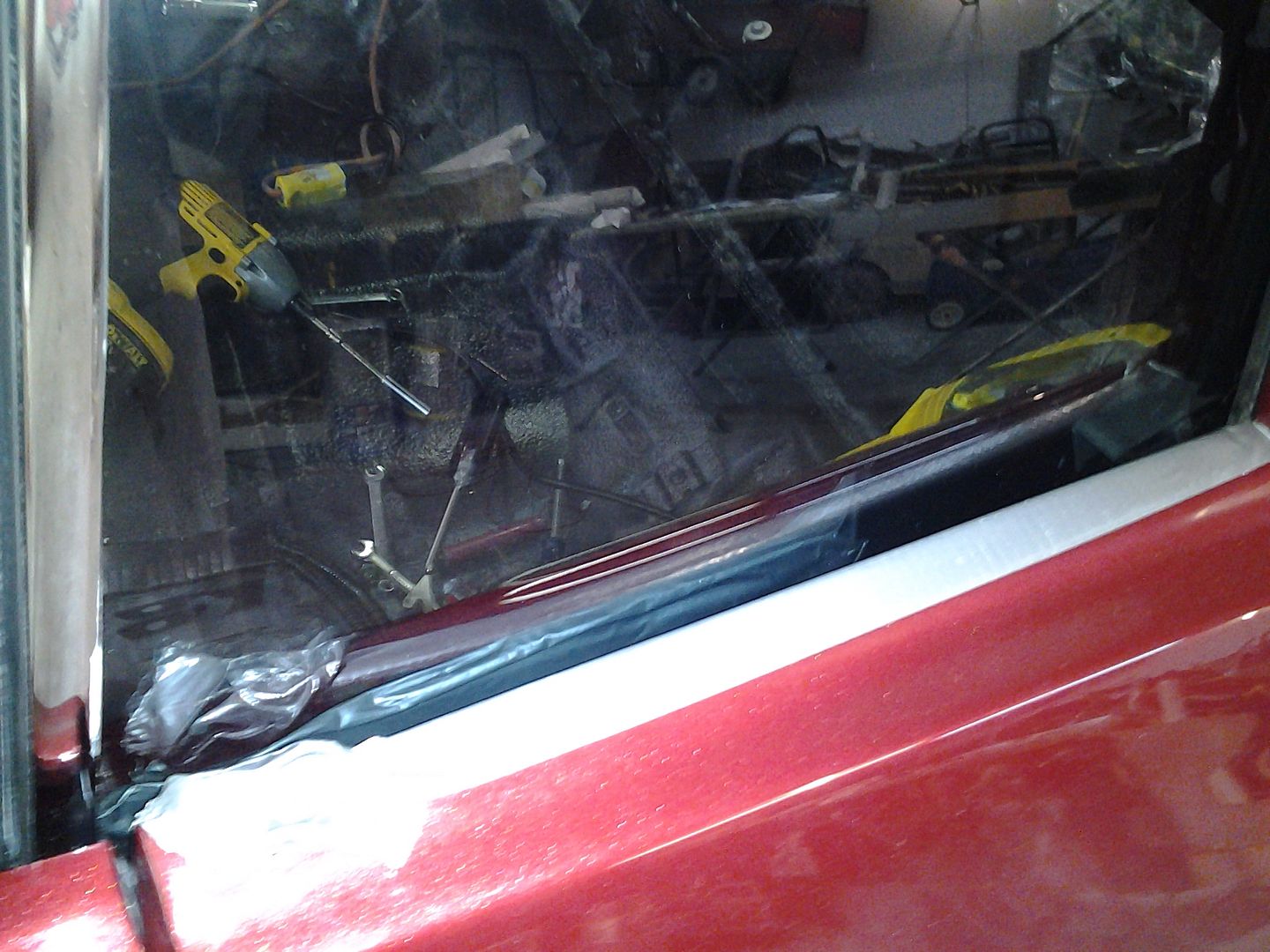

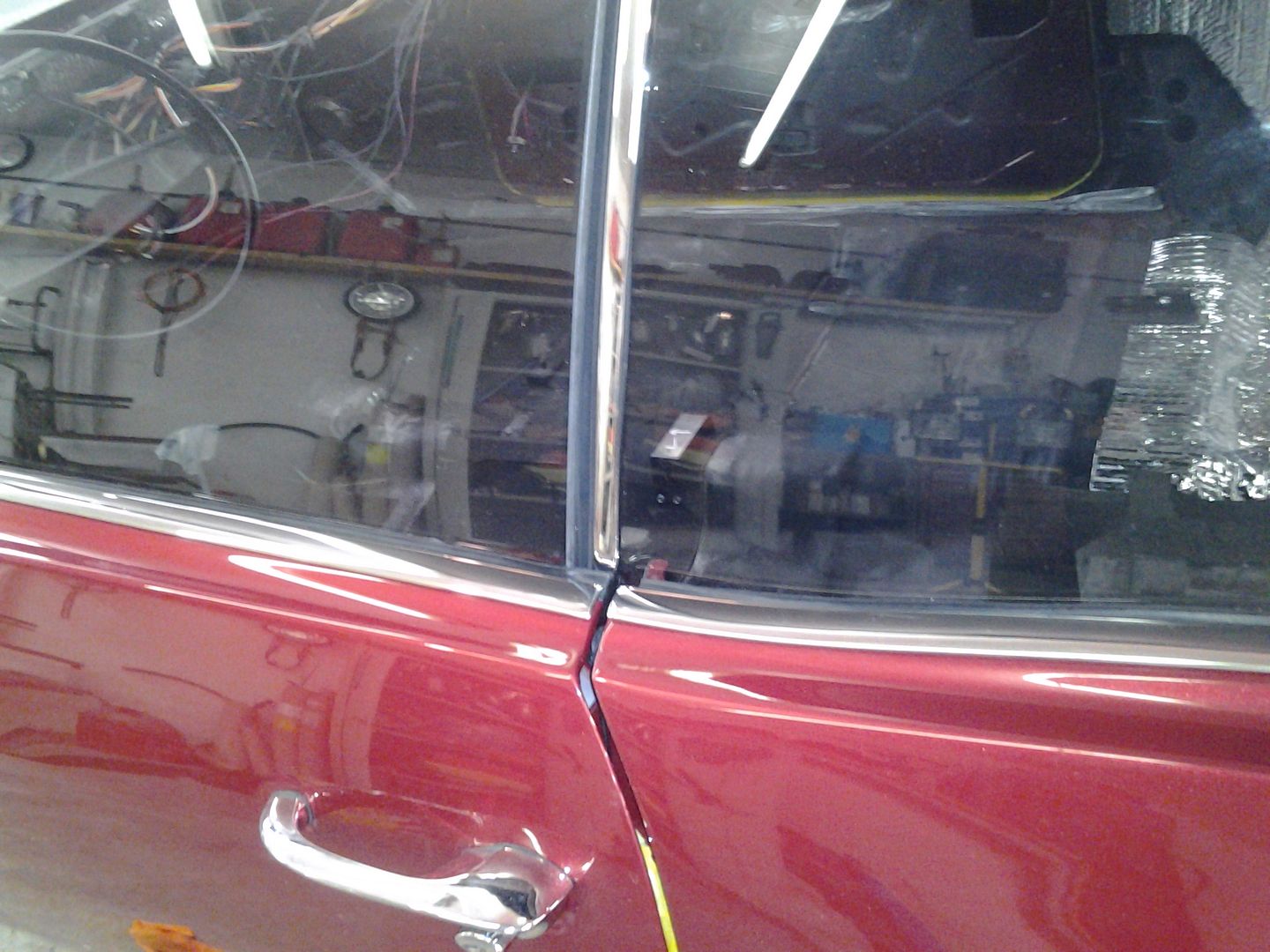

Not much exciting so far this week as far as progress. Seems like I have done nothing at all, but yet have put in many hours. I Dont really even have any good pics to show you guys frown. Got my door & quarter glass adjusted properly, put some seals in, fought with some inferior window felts, put some trim on. Was buttoning up the quarter glass stops & adjustments so I can move on to installing carpet & rear seats & rear inner panels. Had a catastrope yesterday, one of my qtr glass rollers broke while adjusting, it was the last window I was messing with & I was just about done when I heard a loud pop, then saw the roller had busted in two. Pretty devistating, anyone that has ever installed all the quarter window guts & spent hours adjusting things would know. This is a bad thing especially after all the seals & headliner are in, the quarter glass essentially can not be removed without partially removing some of the headliner/sail panel. Fortunetly I was able to change out the roller with the glass still in the car, but was a time consuming deal for sure.

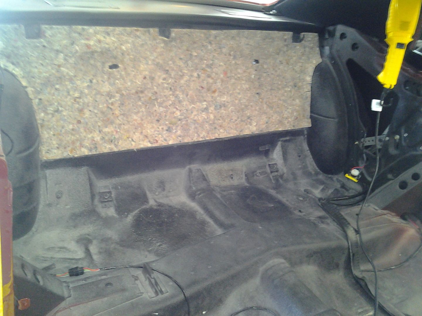

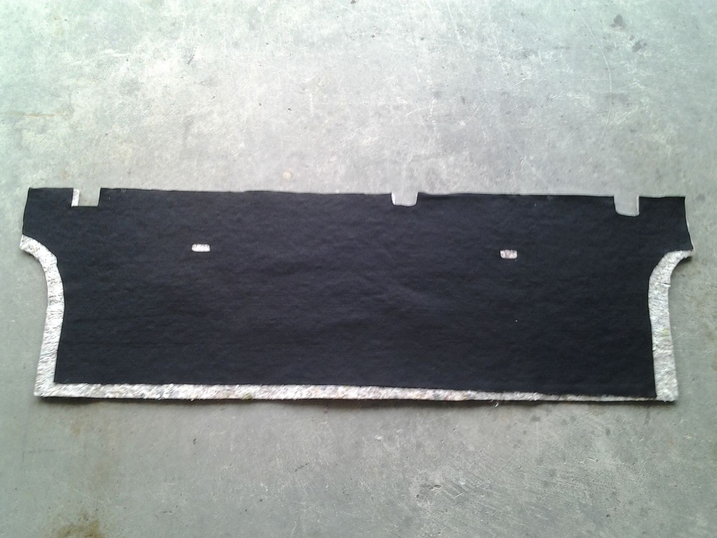

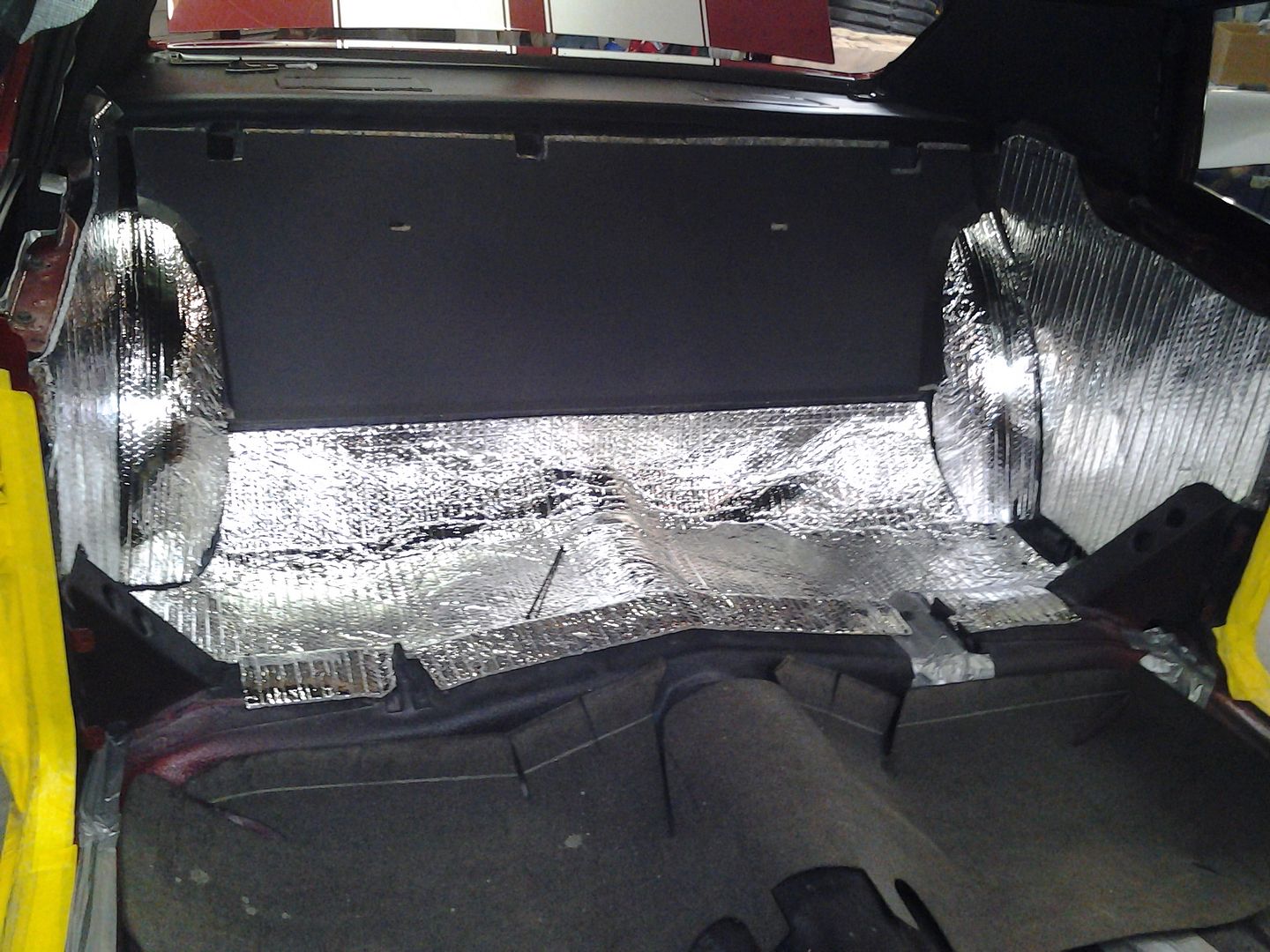

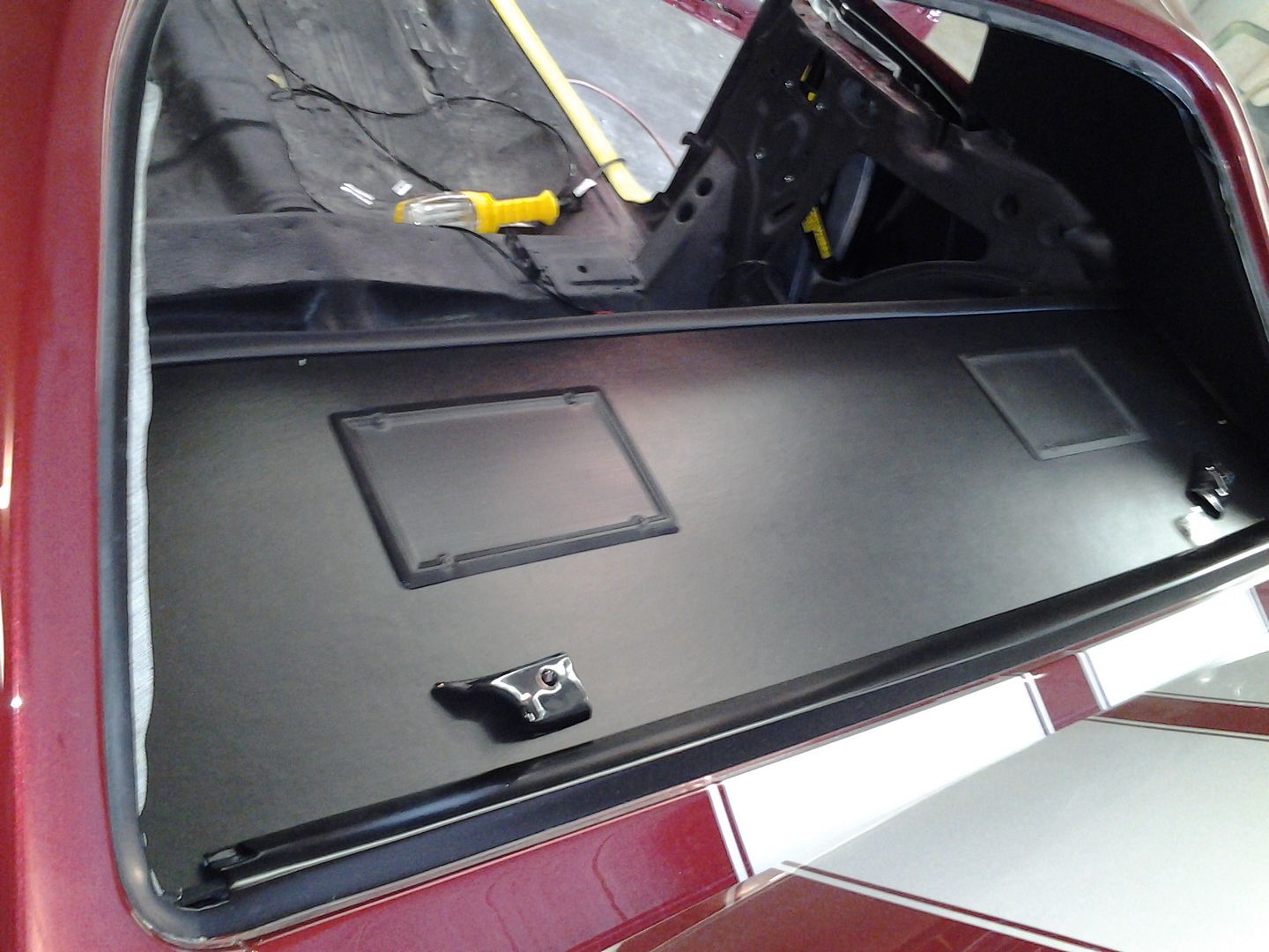

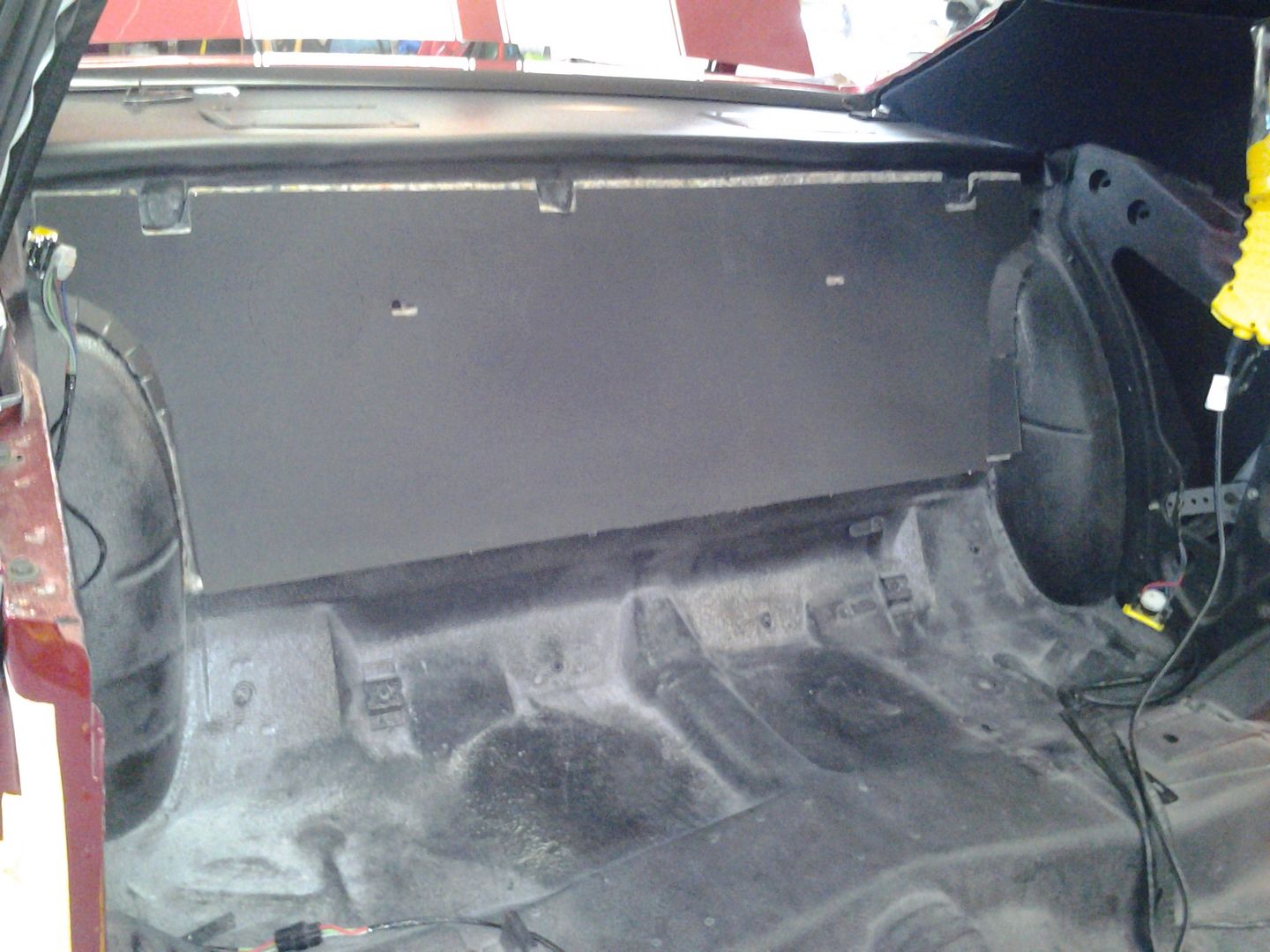

I wasnt real sure what went on first, the jute or the board for the trunk divider blush I figured if the board went on first it likely might create a rattle vibrating on the metal structure. I didnt like the look of the jute showing in my trunk either, not very pretty, so I cut and glued a piece of black felt to the jute first, then put it all in. Dont mind the trunk its a little dusty & dirty right now, so is the car, things are kinda ugly at the moment.

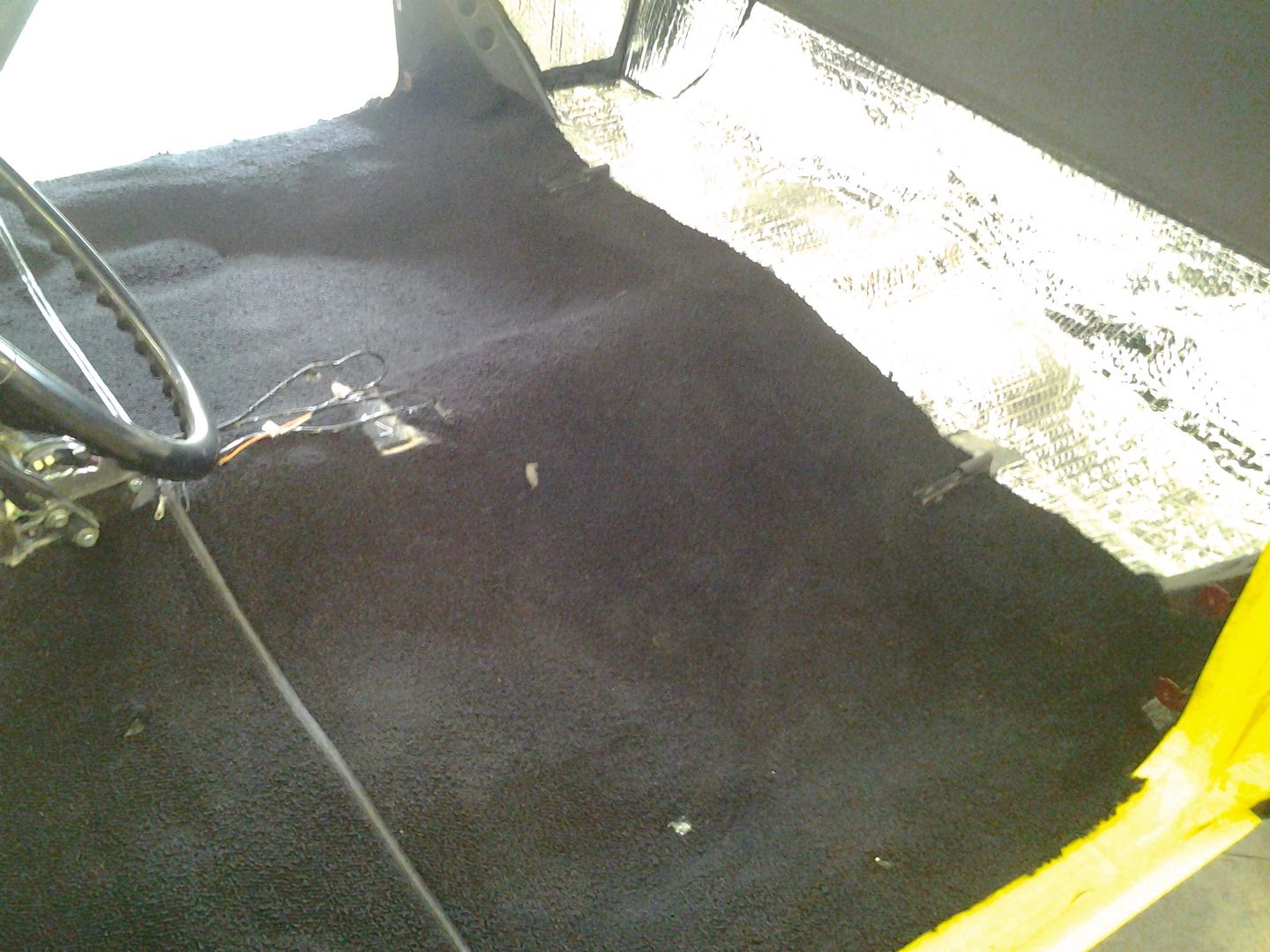

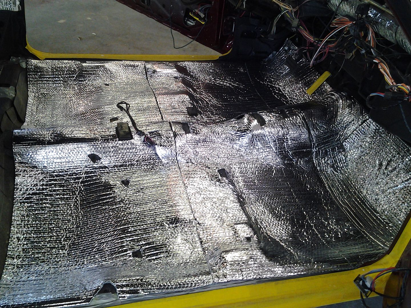

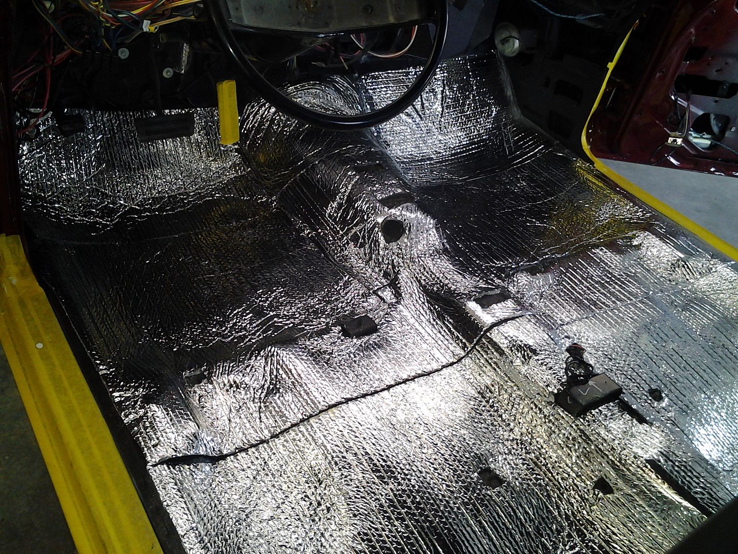

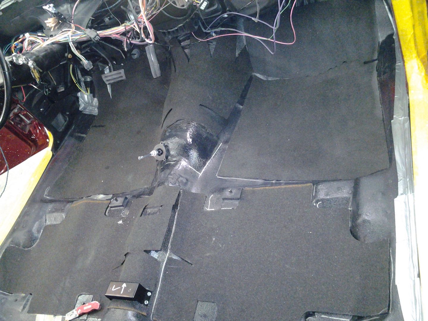

Started putting down the TAR PAPER and some insulation, im putting the tar paper down first then going over it with a poor mans dynamat substitute lol. Prepping for carpet install on Sunday, still have more Po' man dynamat to install before carpet goes in but heres the start of it.

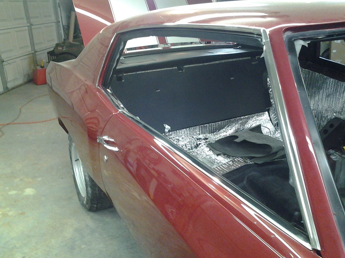

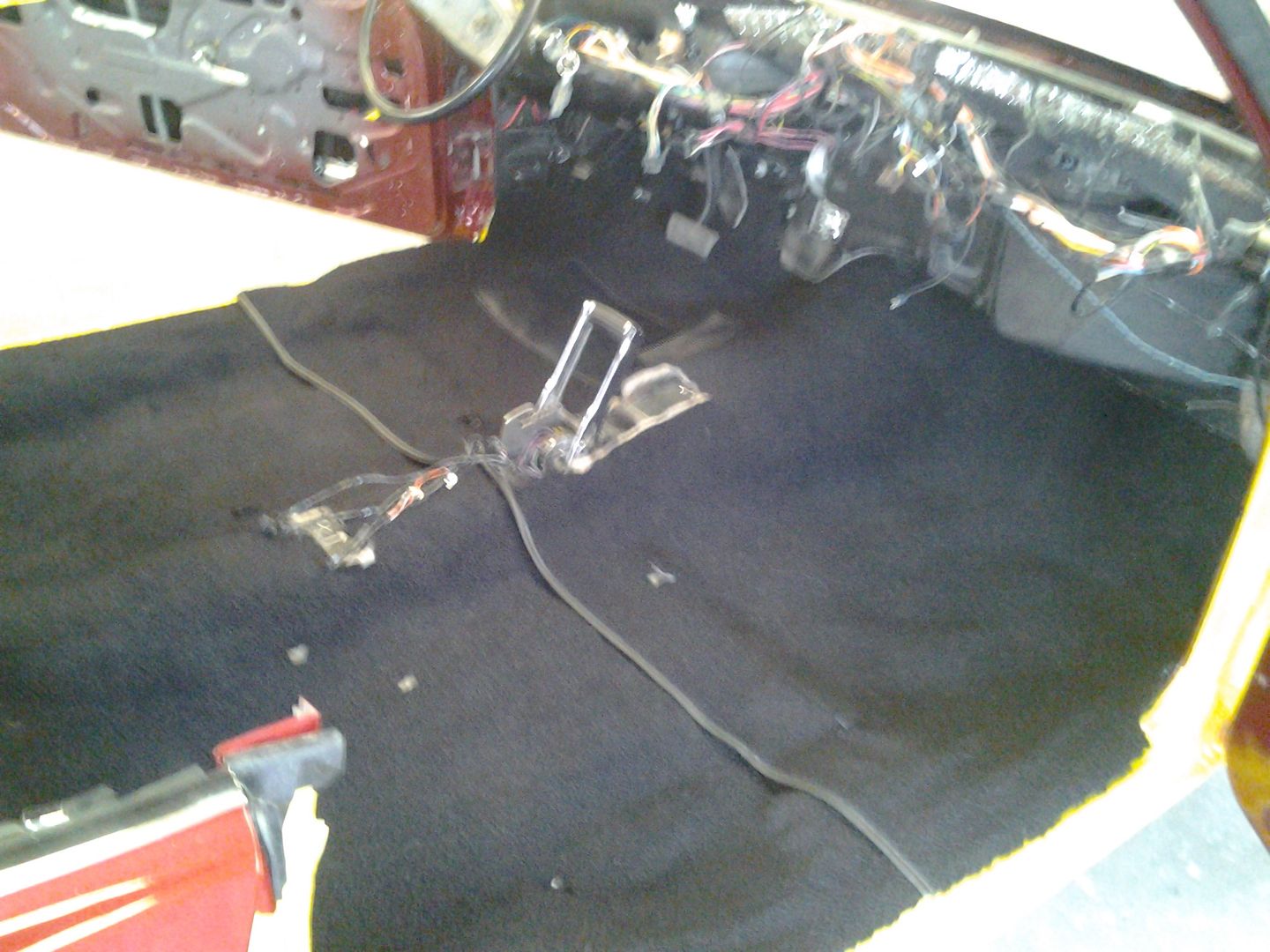

finished up the poor mans dynamat today & got the carpet installed. Im certainly no expert carpet guy, got some help from my interior guy Gary. Looks good to me, I wouldnt know a bad carpet job from a good one lol Never stared at anyone's carpet long enough to critique it or even care what it looked like, ITS CARPET! smile

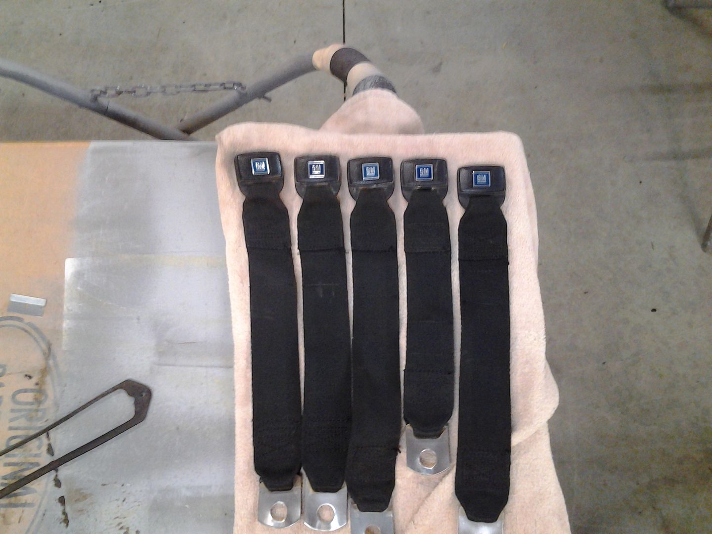

Seemed like a very non productive evening, almost like I accomplished nothing frown cleaned up my seatbelts not very rewarding but necessary. Took steel wool to the stainless & chrome to clean those parts of them up. Power washed & scrubbed the webbing /fabric with a stiff plastic bristled scrub brush. What I really needed was some oxy-clean with its miraculous cleaning power lol .Came out as nice as any 41 year old seatbelt could, not really worthy of posting a pic though.
Last few days have been pretty boring with what seems like almost no productivity, but working on the things Ive been putting off for forever. Cleaning up parts Im forced to re use, sifting through used parts & deciding which ones to use, reconditoning whats going on the car, putting on some seals, doing some detailing along the way, etc.
Heres the gratuatis seatbelt shot, a few of them anyway. Power washed, scrubbed with a tire brush, etc.

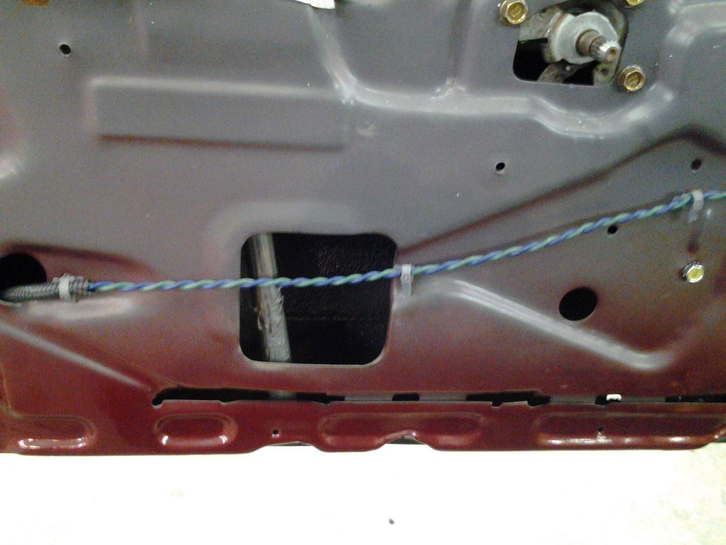

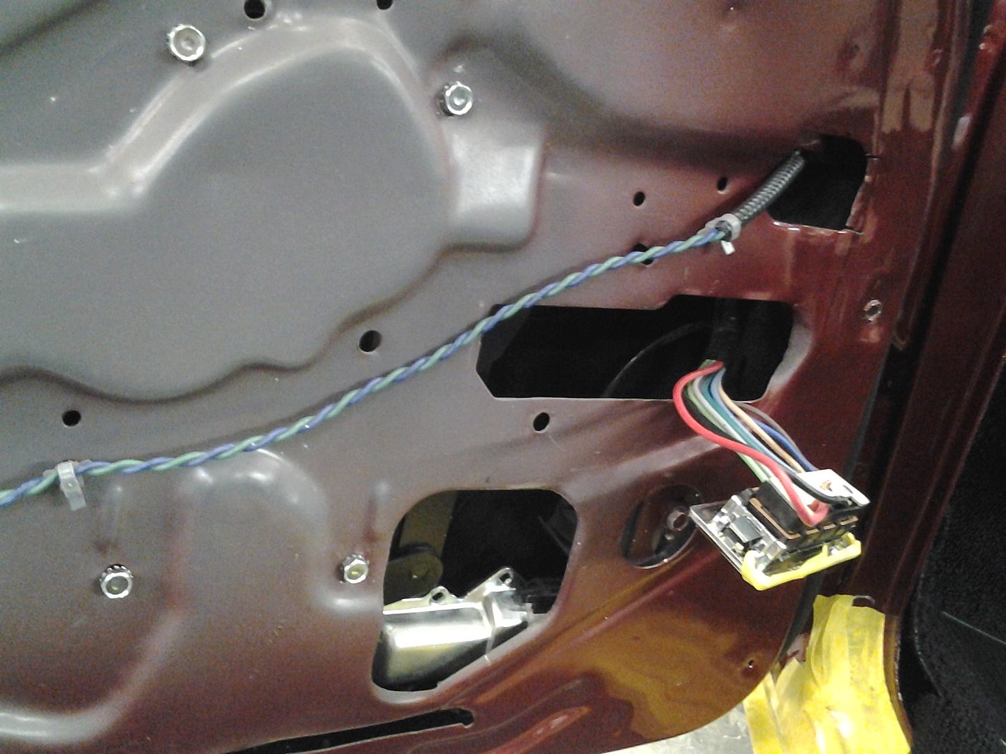

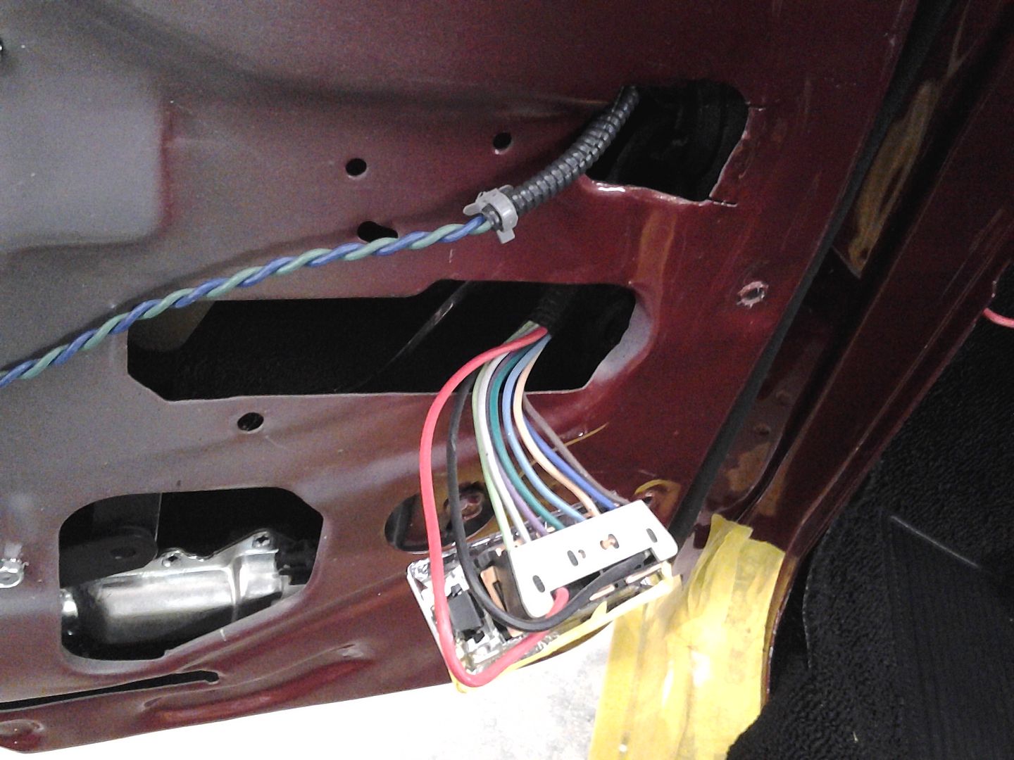

Finally wiring up my Klassic Keyless system & fitting "assembled door panels" tomorrow, oh boy heard horror stories about these door panels shock , cant wait. Anyhow found a nice zip tie to fasten some wires into pre existing holes on inner door shell to make things nice & clean looking for the Klassic Keyless wiring, sorry Tom Im modifying your kit a little. So far the Klassic Keyless stuff has been a breeze to install. I DIDNT HAVE TO TAKE ANYTHING APART TO DO IT! lol Everything fits great and am totally satified so far with it, yet to power everything up.
Heres some nice zip ties to use for this, push in end goes right into existing holes.
A few pics of how I ran the wiring
