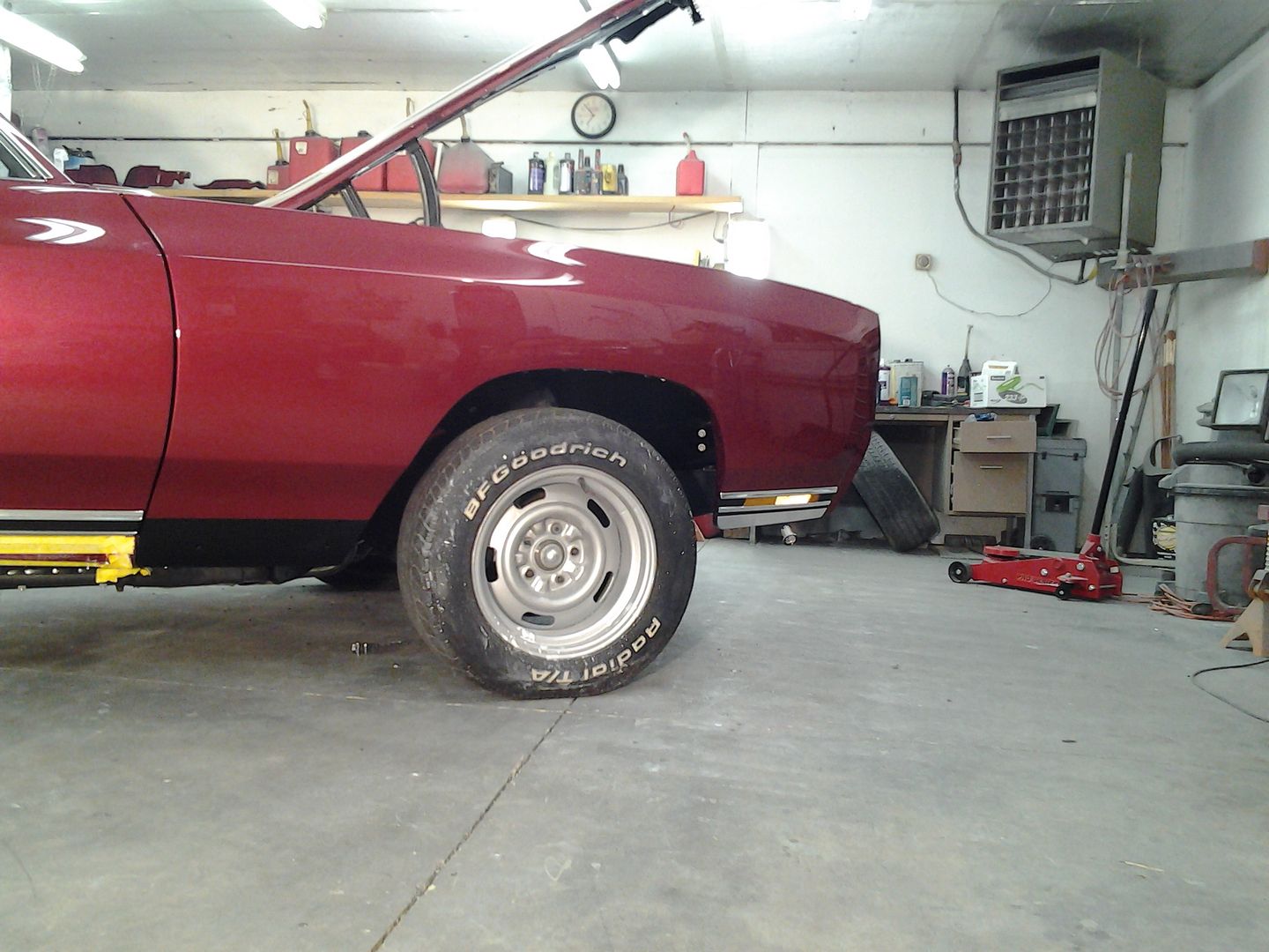

These are some tools you should have on hand prior to installing your repro lower trim & wheel lip moldings. Take your time & look at each piece carefully. All four corners of all the pieces should be ground/filed down to debur sharp edges from the manufacturing process, JMO & just a suggestion. I also had to "shorten" both ends of all my repro wheel lip moldings because they were too long on both ends and hitting lower trim, would damage lower trim if installed like that. A few of them I cut off nealy 3/4 of an inch shock. Test fit by hand & check everything out before actually attaching any. Debur & cut back all the edges & you wont scratch or gouge your paint, I havent "YET", couple of pieces to go...
Most of my new trim had dents & scratches on them right out of the package shockcry2
Uh oh you forgot the fender trim has to go on before the fender to reach the nuts mad

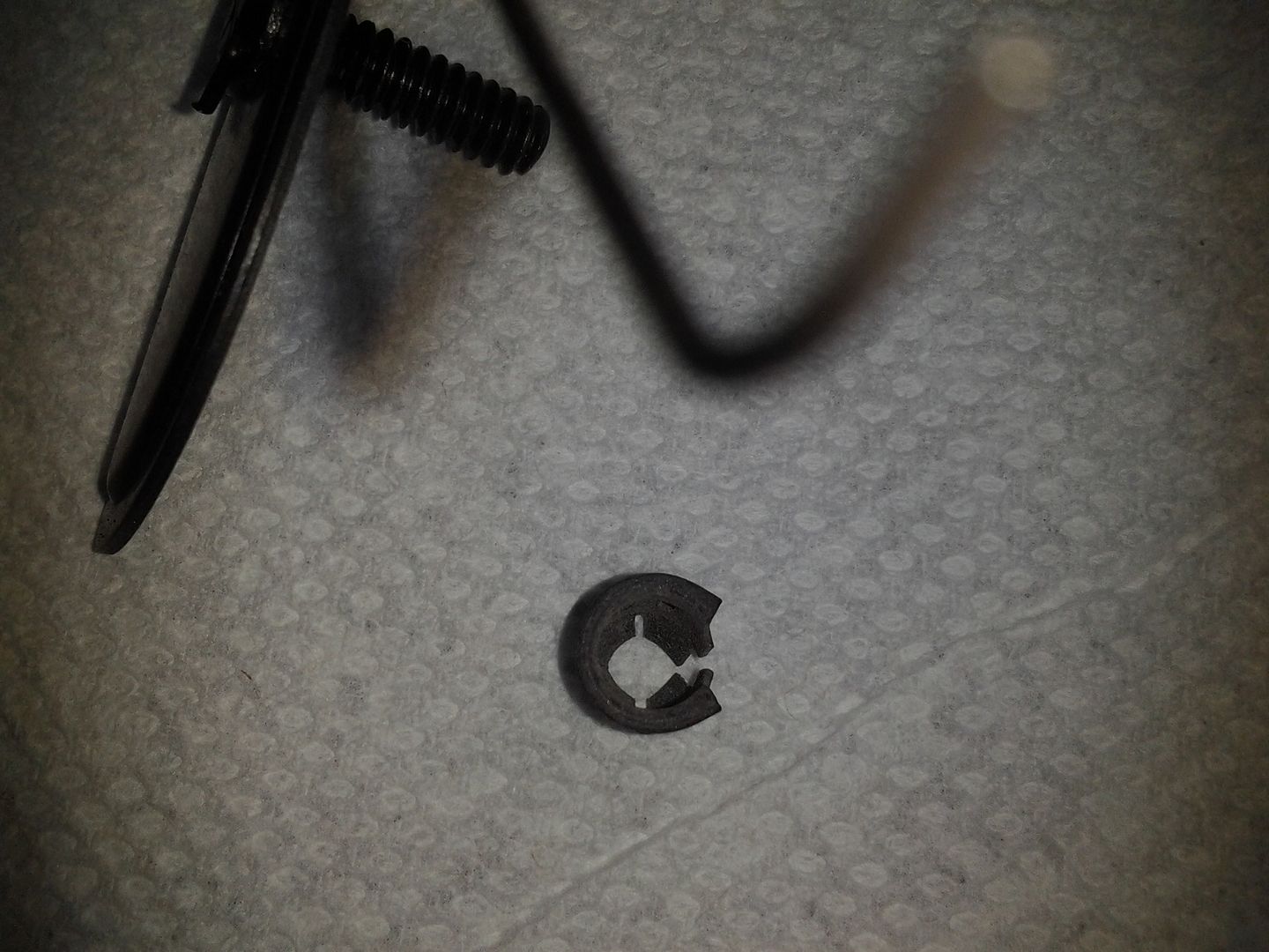

If your not aware already the rocker molding clips that come with the aftermarket moldings don't work! I have part #s for ones that do I'm sure you can get being in the business. It's looking awesome Cory your making great progress and lots of pics is a bonus!!
he's already has a great plan for that molding Tony, wish I would have thought about it, that would have saved me a major headache!
barrel clips!!!!!
Well, Im pretty sure I asked you if you wanted some of these when I sent you the clips & I think you said no you were just going to use nuts. crazy
Heres what you should use, course any way you do it, they will be extremely difficult to get back off if you ever need to. Lets just hope they dont ever need to.
barrel clips!!!!!
I figured he had something planned! He's no amateur!
Just saving the easy ones for last Tony lol
See above post for what I used on those. cool

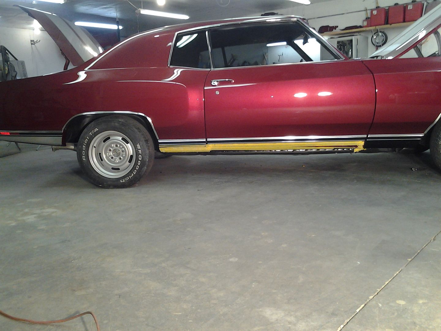

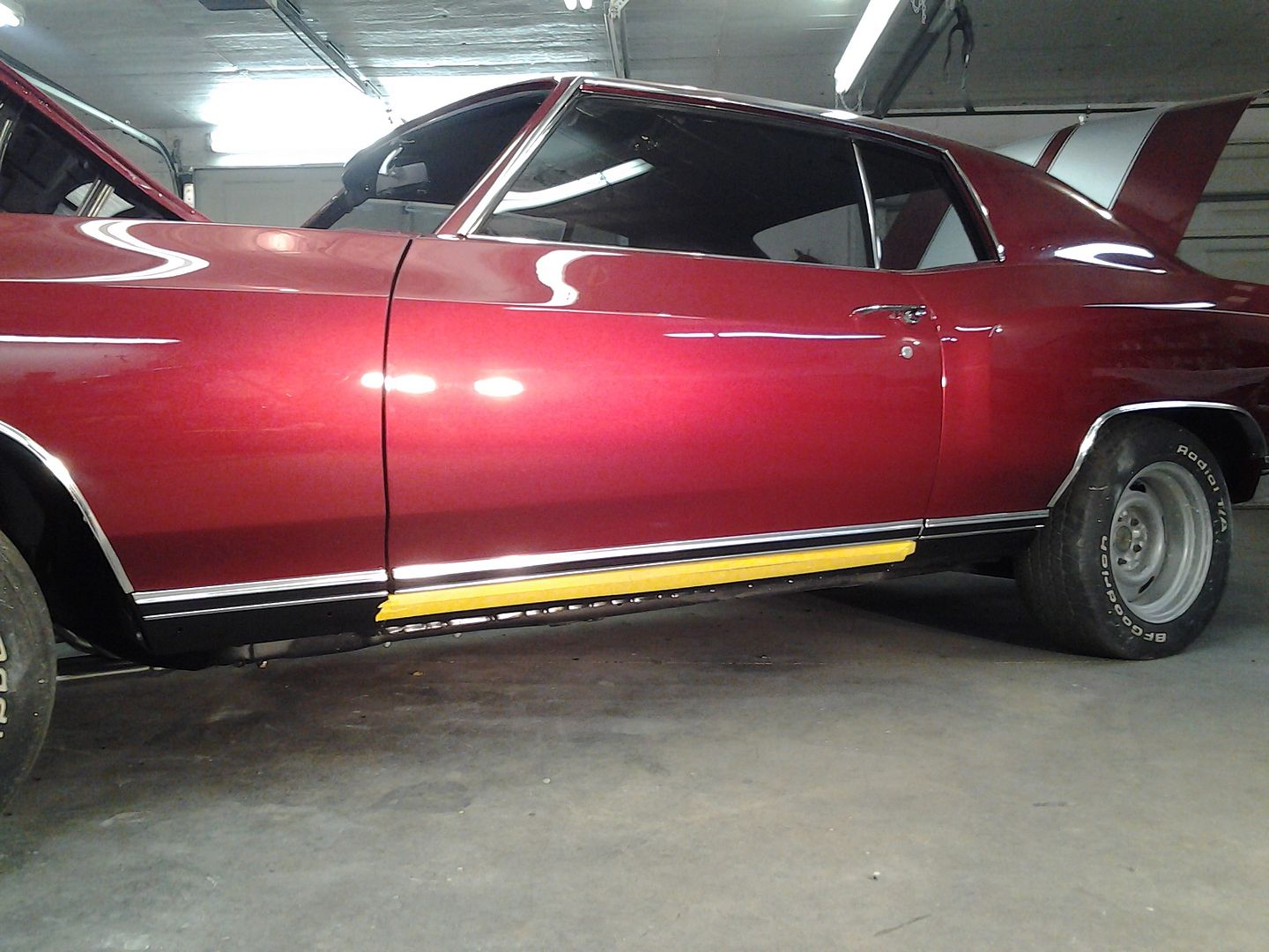

Got the rest of the side trim on tonight, less the rocker moldings, those will not go on until near the end and the interior is completed. Yes you can install the fender trim at the rear of fender near door without taking the fender off the car, ask me how confused But I dont know how a rear view mirror map light works? lol NOTICE IN PICS - thats actually installed now & not on my list cause its DONE!

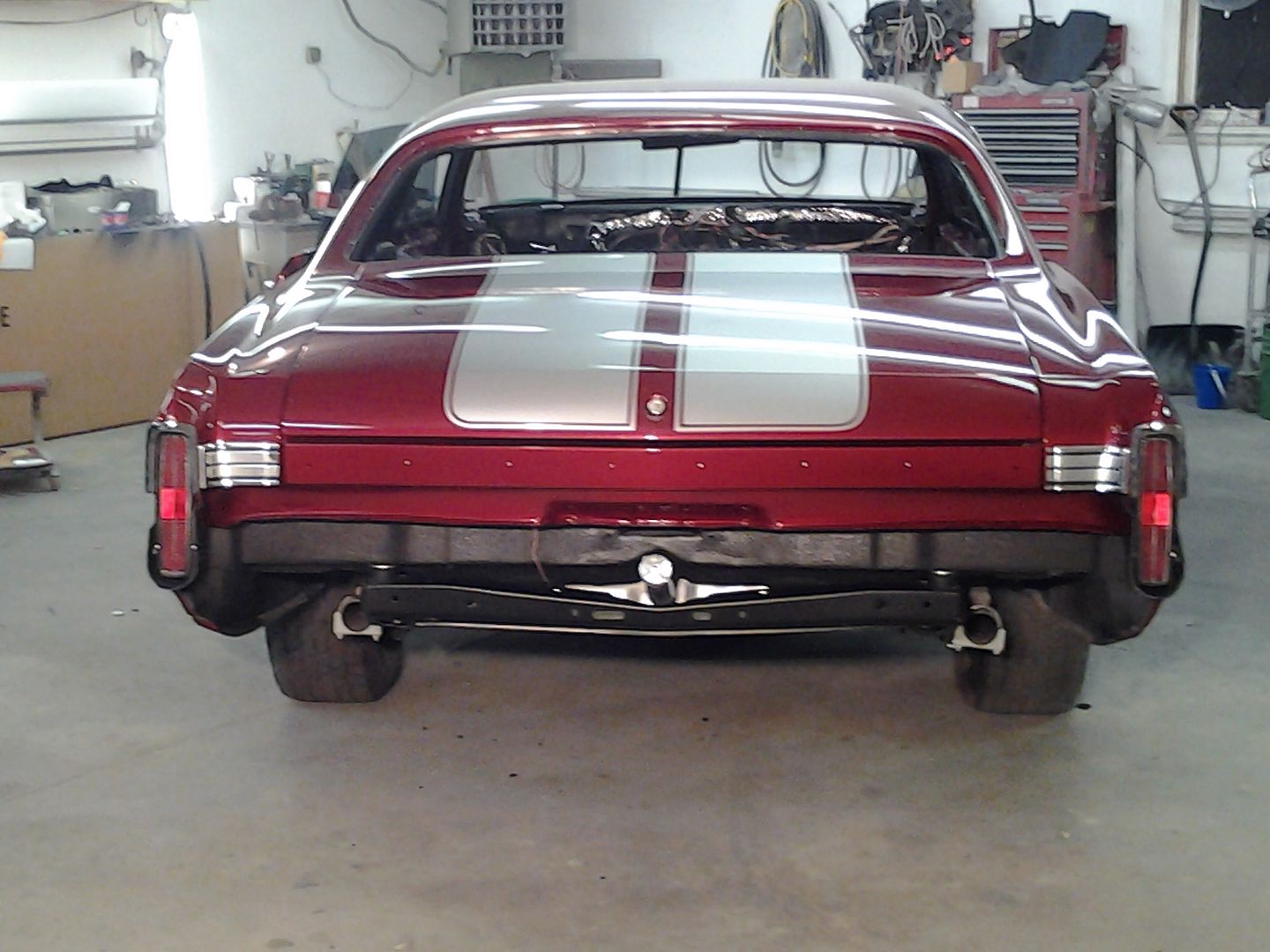

Knocked a few things of my list today, most importantly I ended up with this. I know the car is pretty dusty & dirty at the moment. Gotta get ugly before it gets pretty.
12 days......tick tick tick.....looking good Cory....now get back to work lol
It's amazing how every little piece you put on at this point is like finishing up a piece of the giant puzzle, seems like you make huge progress every day as opposed to doing bodywork.
Looks great Cory

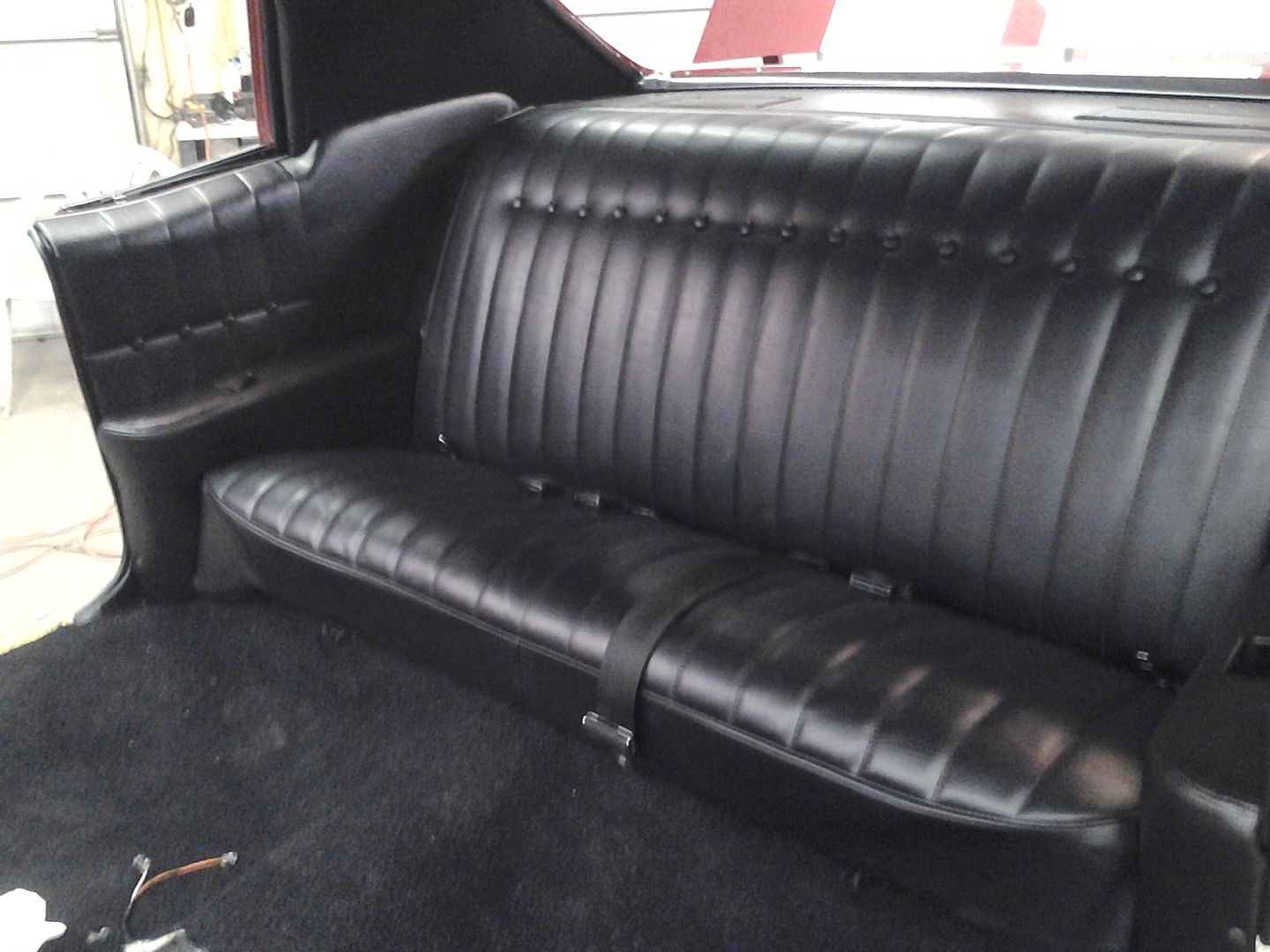

Got the rear interior in today! Also knocked a few other things off my list too. yay Looking pretty good I think. Notice no window cranks or switches for the rear, I wanted a super clean look so Im concealing the switches & tying them to the bottom of the ash tray if I ever need to pull them out to mess with a single switch or wiring for some reason. The other reason being I have a 2 and a 4 year old, both boys, that I dont want constantly messing with the window switches no
Good idea but it will work for about a day. Those inquisitive minds are going to open the ashtray for curiosity sake.......and as soon as they see the button they are going to try it. Unless of course the switch will be under the ashtray ..... then dad will never open the windows either. Young minds are like sponges.
Dan
I suspect Cory put them under the ashtrays and will use the front gang switch on the driver's door to put them up and down. smile
Car sure is coming along nicely. Its gonna look great once its done.
Where did you get your interior kit from?
Thanks in advance
Abe
Correct Larry, Im drilling a hole in the bottom of my ash tray & going to run a zip tie through the wires on the switch, & loop it back into the bottom of the ash tray. Then I can pull the whole ashtray assembly out & pull the switch up with it, if ever necessary to mess with it for any reason. Otherwise it will never be used anyway cause I can control all windows from the drivers door. I dont think the kids will figure this out for quite a while, if ever. They are at that age right now where they mess with everything.

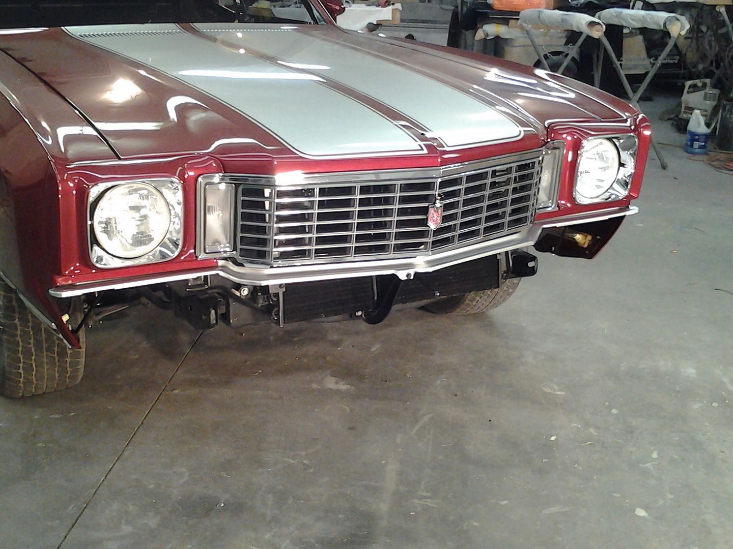

Enough of that & moving on, front bumper went on easy & fits great, wonder why?
