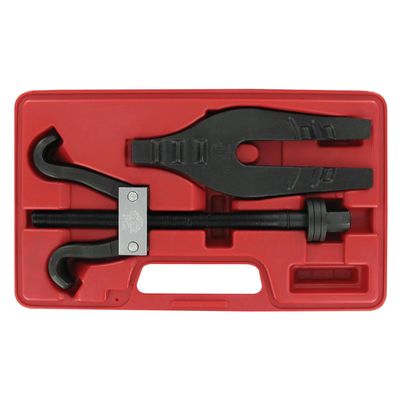

jvssmail Posted June 7, 2013 Posted June 7, 2013 I purchased an internal spring compressor to get the coil springs back in my 72 MC and all went pretty well , compressor worked perfectly spring went right in and I attached the upper and lower ball joints then proceded to dissassemble the spring compressor, removed long threaded rod then the lower fork and now I have the top piece of the compressor with the 2 hook arms stuck inside my spring. How the heck do I get it out? is there a trick or something Im missing ? I realize I can enlarge the hole for the shock on the lower arm but they look so good all powder coated and clean that I hate to start hacking into them. Please help..... Quote

jvssmail Posted June 7, 2013 Author Posted June 7, 2013 Great idea Murphy. Ill definately try that on the other side once I get this upper piece out. My compressor consists of a long bolt that attaches to the upper portion which is a retangular block with a long and a short hooked arm at each end that hook onto the spring then theres a forked shape piece that slides through the spring and catches the bottom end of the long bolt. As I said in my first post it worked great just cant get the upper piece out from the inside of the spring. Going to try releasing some of the spring pressure today and see if I can get it into a straight position to drop out of the bottom, But on the other side Im using Murphys idea. Quote
jvssmail Posted June 7, 2013 Author Posted June 7, 2013 Heres a link to the compressor Im using if anyones interested http://contentinfo.autozone.com/znetcs/product-info/en/US/grn/27035/image/4/ Quote
Murphy Posted June 7, 2013 Posted June 7, 2013 I got this internal compressor from Eastwood..... http://www.eastwood.com/coilspring-compressor-internal.html It works really well, I just added a couple big washers at the top of the bolt..... Quote

footballubet Posted June 8, 2013 Posted June 8, 2013 My compressor is like the one Murphy posted. Never used the one with the bottom block. But the top piece looks the same. If it's not stuck in between the coils it will come out. You may have to rotate it down a couple coils to get it flipped around and in position to go out the bottom hole. Quote
jvssmail Posted June 8, 2013 Author Posted June 8, 2013 I know what I have to do I just have to release some tension on the spring so I can flip the hooks over then it will straighten out and slip right out the bottom. Had me baffled for a while trying to figure it out. Heres a pic [img:left]https://skydrive.live.com/redir?resid=5273BFAC1F9AEA0C!107&authkey=!ALXW_Oiw0bFHYbs[/img] Quote
