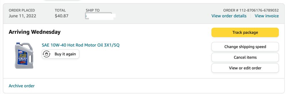

36 minutes ago, sbarnette said:
Okay, I ordered Lucas 10W40 Hot Rod and Classic oil from Amazon 2 weeks ago and it’s still not here. They gave me the option to cancel my order, so I did. I have found these options locally, but I have used conventional oil in my 71 for 43 years and I don’t know that I want to go to a synthetic blend. Just looking for options. Thanks!
Sam,,, I just ordered 5 quarts from Amazon and it will be here Wednesday … I keep a couple of 5qt containers on hand at all times … I also use it for my lawnmowers and other equipment
Ed C
Ed C
Ed,
Let me know if it arrives. I ordered mine two weeks ago on Sunday. It was supposed to arrive the following Tuesday but never came. If you get yours on time I’ll order again.
