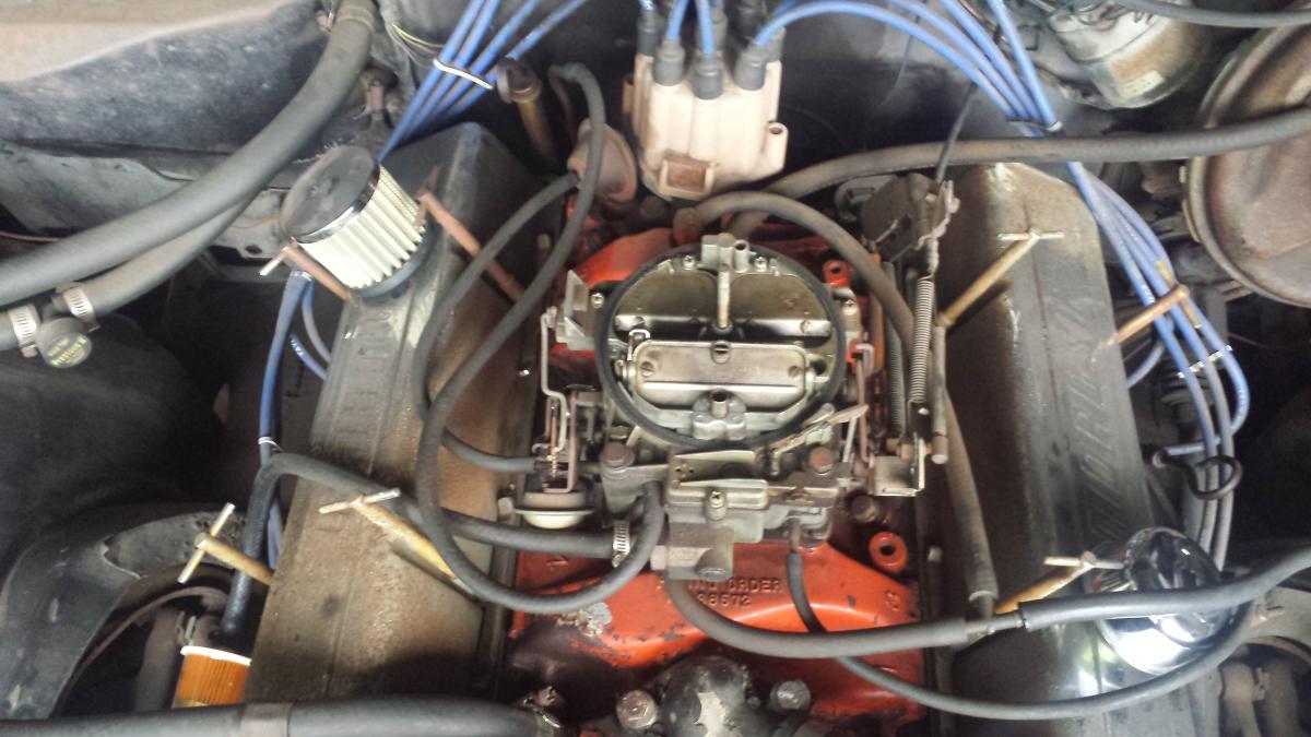

71MonteCarloMD Posted July 2, 2015 Posted July 2, 2015 Aaron - I was searching for pictures to modify my '71 as it didn't have stock valve covers nor air cleaner - I wanted to bring it back to stock as I bought stock valve covers from Cory, it's ready to be installed - your pictures surely help but can you tell me 2 things: 1) what kind of "hose" that goes from hole (on passenger side) to air cleaner breather? 2) Where does the PCV valve hose goes to from the valve cover? 3) What else do I need to have as I bought stock air cleaner from Jared? here's picture of mine what's looks right now - I need to correct them somehow, need you guys help Quote
stangeba Posted July 3, 2015 Posted July 3, 2015 In 71 Chevrolet small block engines started to use a "push in" rubber plug, for the oil fill at the rear of the driver side valve cover. Rick, 1) The hose on the passenger side to the air cleaner is a metal tube. 2) From the factory there is a T and it directs the vacuum from the ft of the carb and the emissions canister on the drivers side ft rad support. 3) Heat tube from passenger side exh manifold is one thing. Link to some 71 4 BBL pics https://picasaweb.google.com/110808817090254771768/1971QuadrajetAndAirCleaner?authuser=0&feat=directlink Bruce Quote
71MonteCarloMD Posted July 3, 2015 Posted July 3, 2015 Bruce - thanks for sharing - am wondering if the metal tube is reproduced? And in your picture, I don't see black tube from rear mainfold connecting to PCV? Rick Quote
stangeba Posted July 3, 2015 Posted July 3, 2015 I don't know if it is reproduced or not but someone in the club will chime in where to look. Leo may have a good used one. My OEM 71 350 4BBL has the PCV hose from the ft of the carb going to the ft of the driver side valve cover where it is "T'eed" into the emissions canister. Many of the emissions canisters (AKA charcoal canisters) were taken off years ago. The rear of my carb or it may actually be the intake manifold, has a tube that is used for the power brake booster, partially seen in one of the pics. Bruce Quote
71MonteCarloMD Posted November 22, 2015 Posted November 22, 2015 Guys - I am preparing to switch out the valve covers and make correction to the hoses as I don't think it's set up correctly, need your help on directing the hoses as the yellow path is what I will do with hoses and need to know the red circles as I am not sure what they are and how I should connect them? If I am not correct with the yellow lines, please let me know. Rick Quote
stangeba Posted November 22, 2015 Posted November 22, 2015 Rick, I believe the yellow lines you drew are all the correct way to go. The one sticking out the right (passenger side) of the carb (now attached to the vacuum advance can on the dist) is for the snorkel on the air cleaner heat pipe door. Perhaps review these pictures, but I think you are OK. https://picasaweb.go...feat=directlink Quote
Sam (Bones) Posted November 22, 2015 Posted November 22, 2015 your proposed one for the vacuum advance is incorrect, vacuum advance should go to the red circle with the "7" Quote
stangeba Posted November 22, 2015 Posted November 22, 2015 Sam, Is that ported vacuum? If you have a vacuum gauge, you can always test the different ports. Quote
Sam (Bones) Posted November 22, 2015 Posted November 22, 2015 that should be manifold vacuum no matter what others say, GM always used manifold vacuum for vacuum advance, and that's the correct way also ported vacuum is the one on the drivers side of the carb Quote
71MonteCarloMD Posted November 23, 2015 Posted November 23, 2015 Bruce and Sam - thanks as I updated the proposed drawing, let me know if it makes sense as I am not sure why previous owner set this way? Rick Quote
