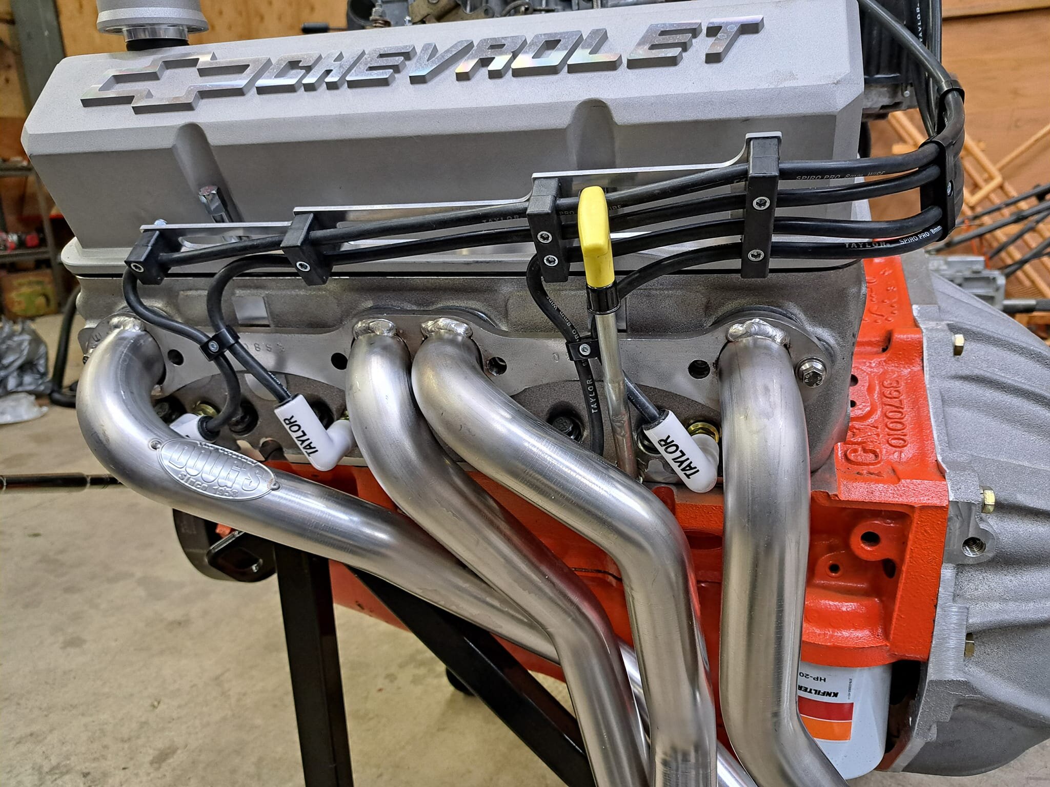

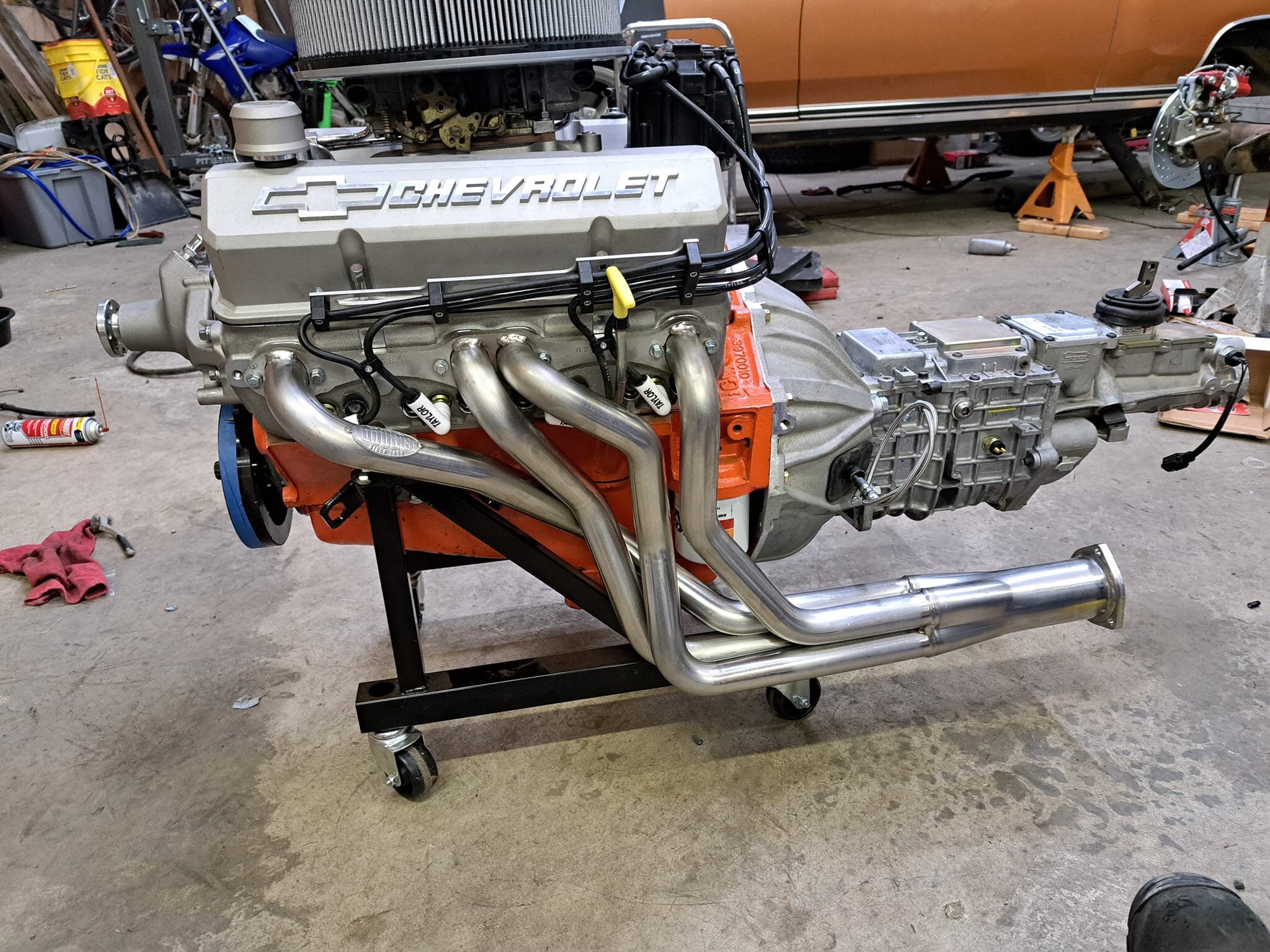

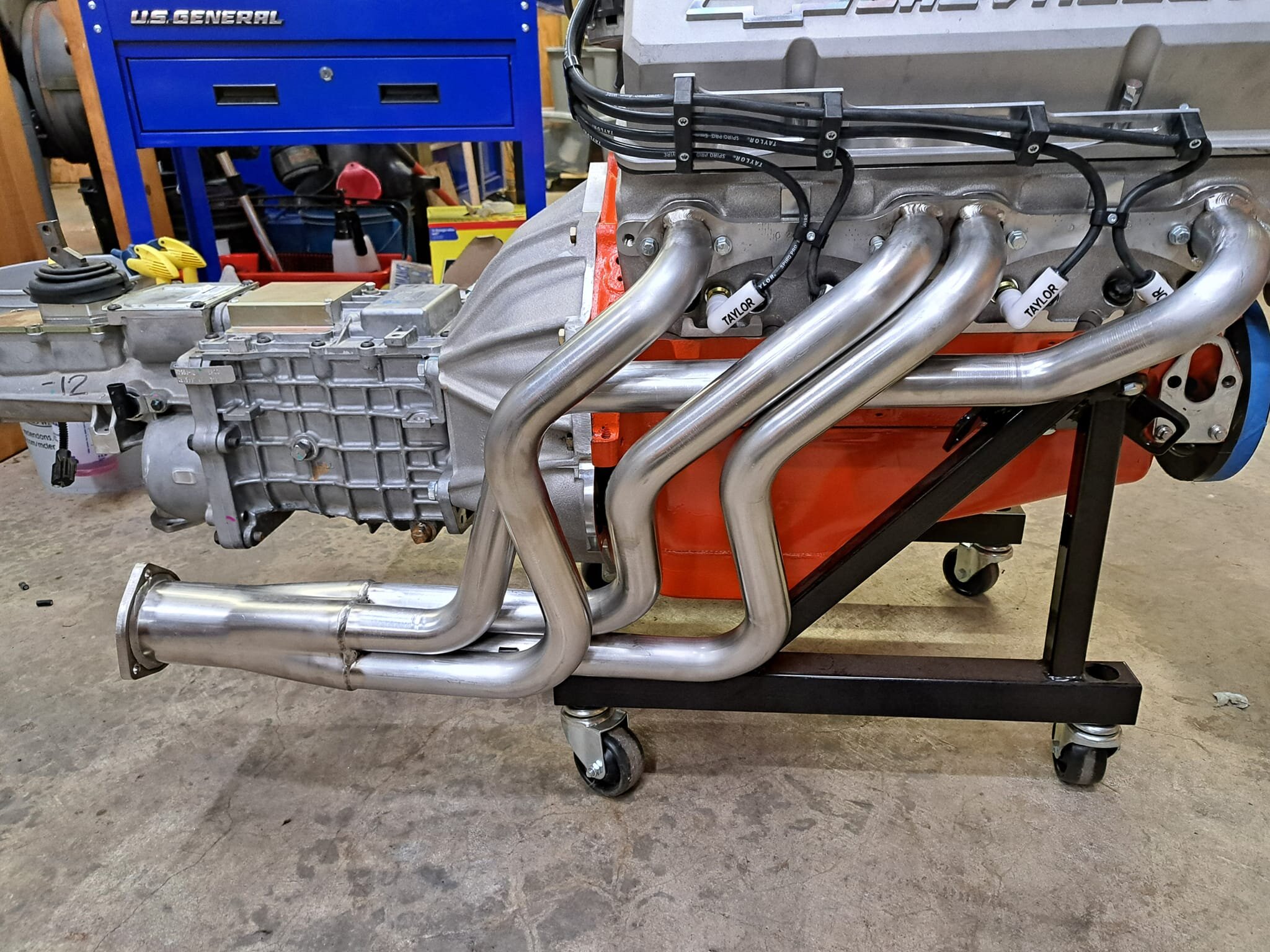

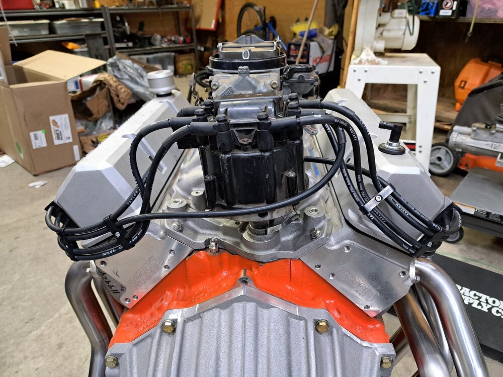

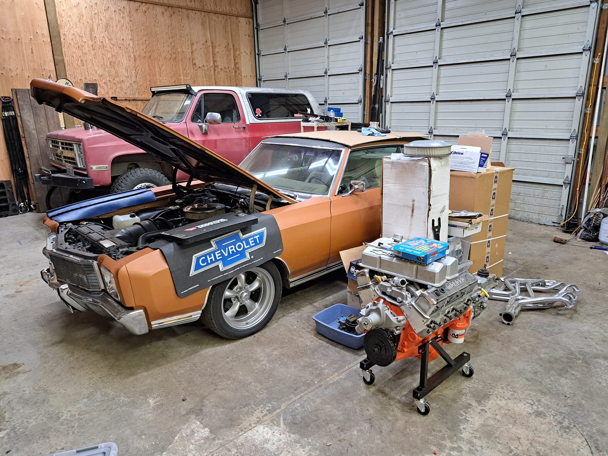

Well over the last couple of days I test fit the new headers, indexed the bell housing, installed the clutch and 5spd and made up the plug wires and neatly routed them. Next up, finish the work on the rear axle and get it back under the car. -

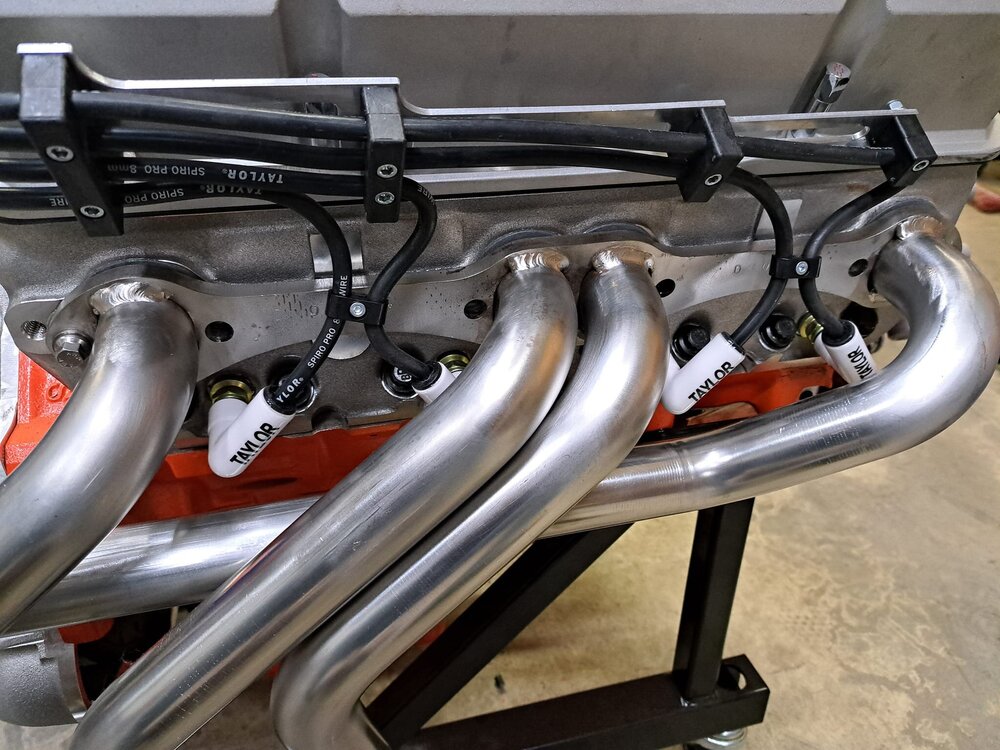

Well I tried to make the Summit Racing branded headers work but in the end I was still not happy with them. I got them to work with the plugs and wires, went to Accel shorty plugs and Taylor ceramic boot wires, but there was a significant difference in the collector heights. Drivers side was level with the ground while the passenger side pointed upward. I bit the bullet and bought some Doug's Haeders. Much better fit and quality

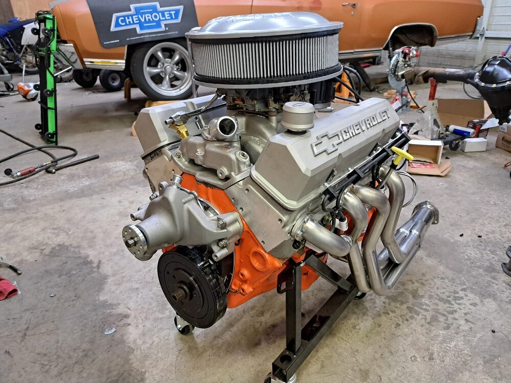

I'm in the process of getting my new 355sbc ready to go into the car and hit a snag. The Summit Racing long tube headers i bought fit terribly with the plugs and plug wires specifically #6 though #5 isn't great either. I just ordered some shorty plugs but if that doesn't take care of the issue and massaging the pipes don't work I'm cutting my losses and getting a different brand of header. I'm open to just about any brand and would like to stick to long tube but open to mid length as well. My budget is $1k and less.

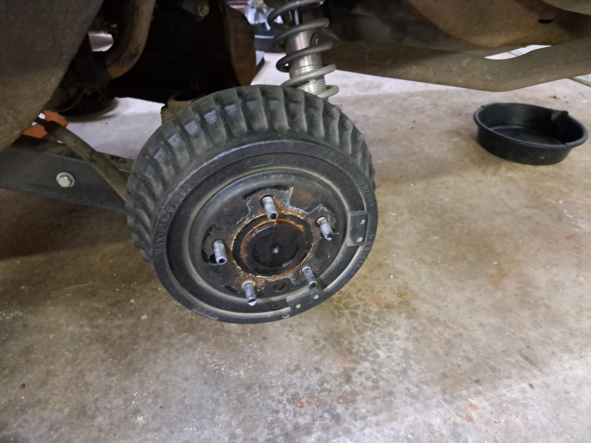

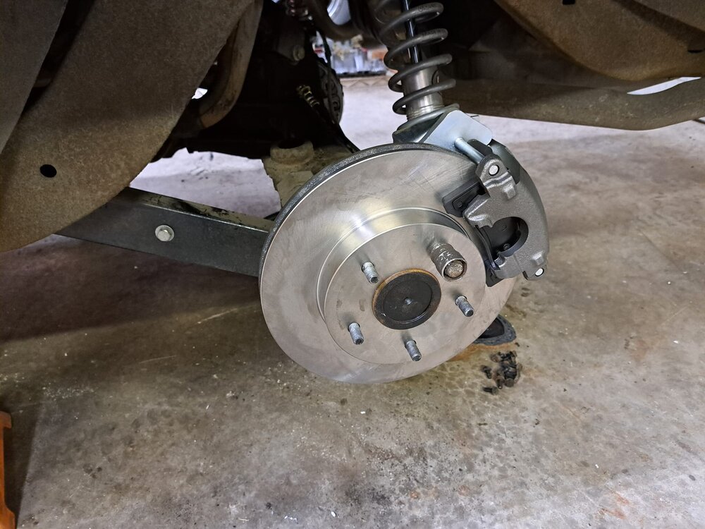

Yanked the rear end out to replace the bushings and make new hard lines without crawling on the floor to do it. Just waiting on the new soft line to do that. -
