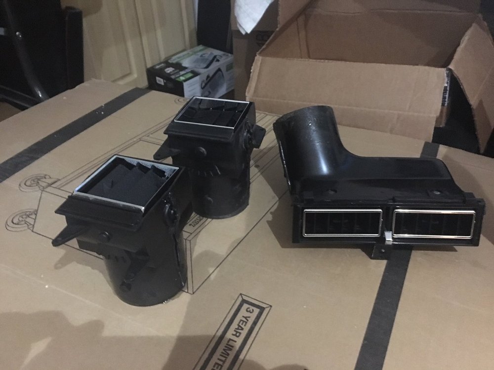

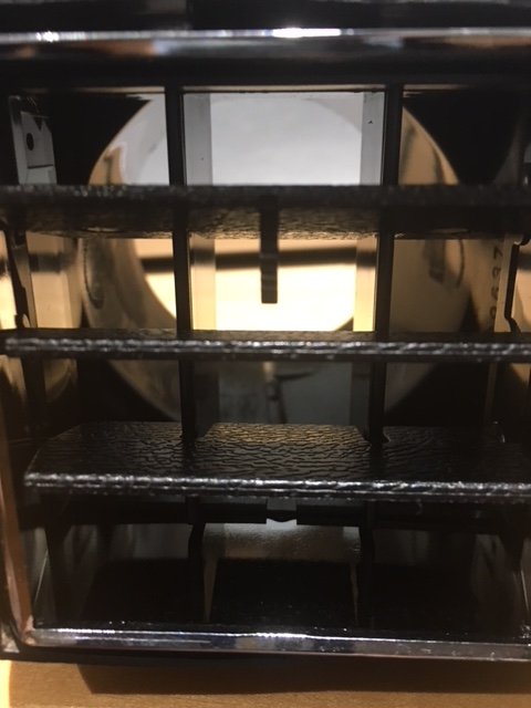

  24. I was pretty sure that they were on top but would have hated to find out later they are upside down which I've done before on other projects. Thanks! Tony, I wonder if yours are upside down? Didn't see your comment initially. It's easy to happen as they fit either way.
