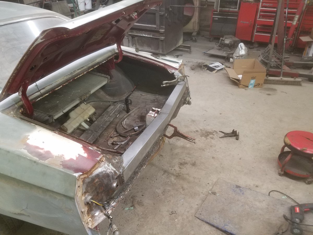

Needs to be finish welded and cleaned up, but everything seems ok. Need to order new weather stripping, but the old ratty one fits real nice

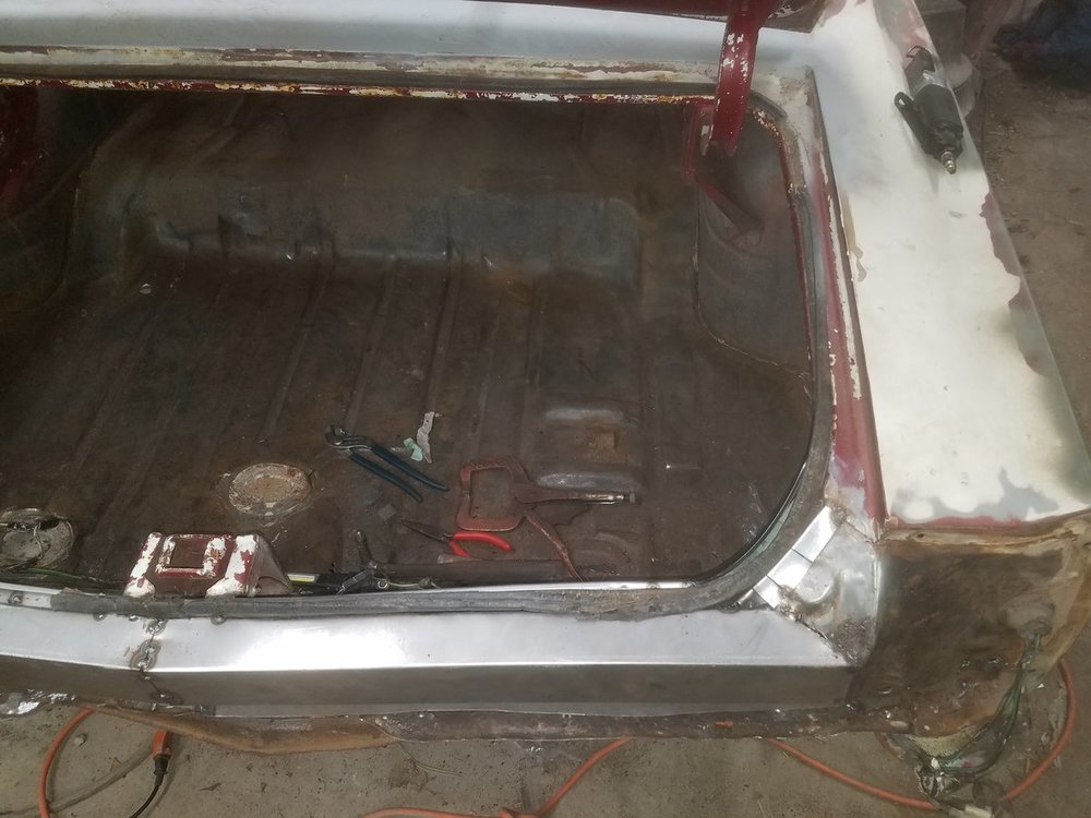

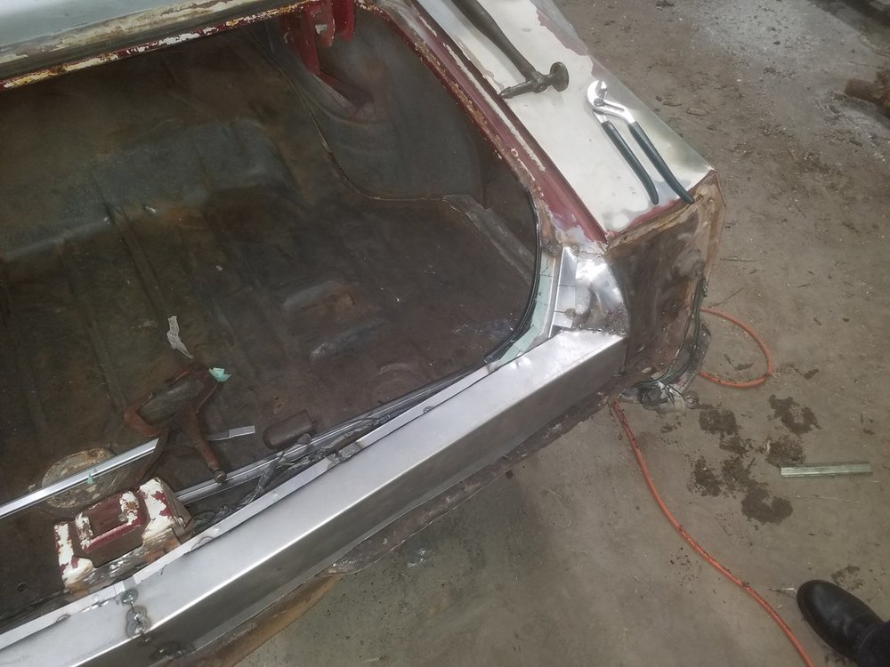

Corner gutters placed. Working on the lip for the gutter. Corners are being difficult but I think its coming together.
Got channels in, started measuring and bending for the lip to weld to it. Sunday I should be able to get something tacked in.

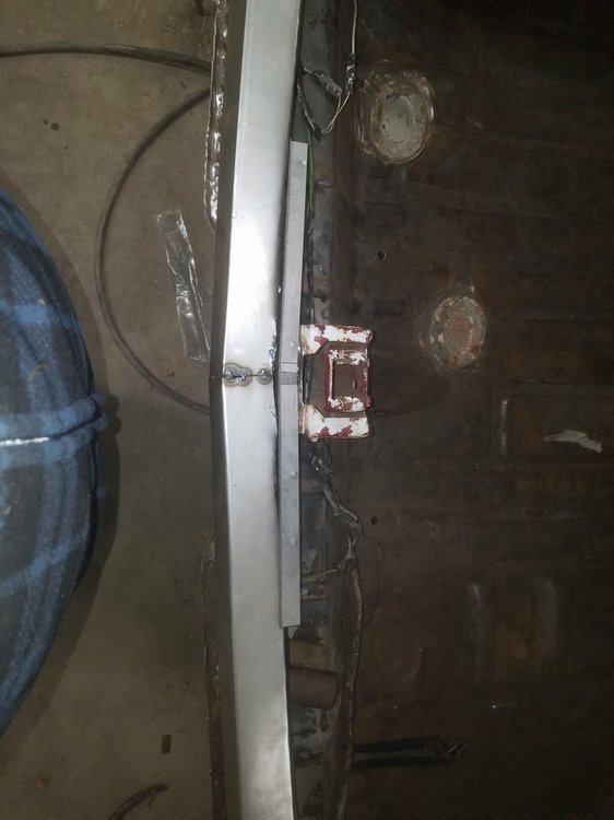

I'm pretty sure I know where this goes. Right behind rear bumper? I'll take a pic of mine tonight when I get to the shop though I think mine is twisted.

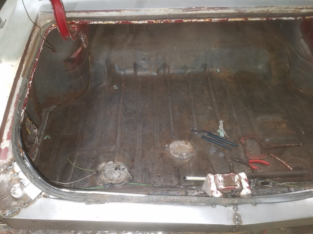

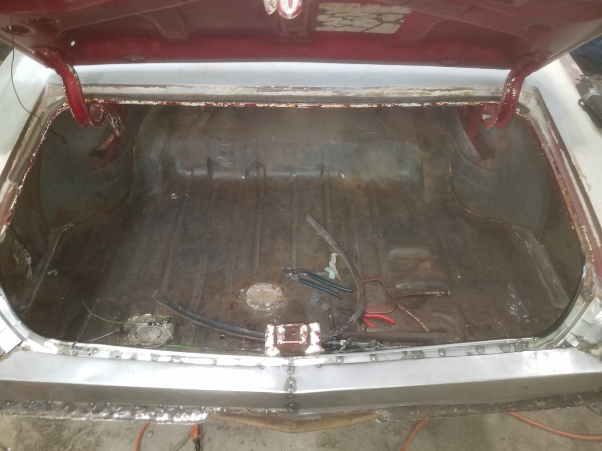

Waiting on parts to do more work to my tail panel, so started on the floor and trunk pans. Really only 2 spots that need patches. Made 1, the other might need to be purchased. There are some spots with some pitting, but the metal is very sturdy, so think I will be ok just treating those areas with ospho. -

Well trunk gutters came in. Sadly I only need the corners, hopefully I can convince belden to sell me the lower gutter.

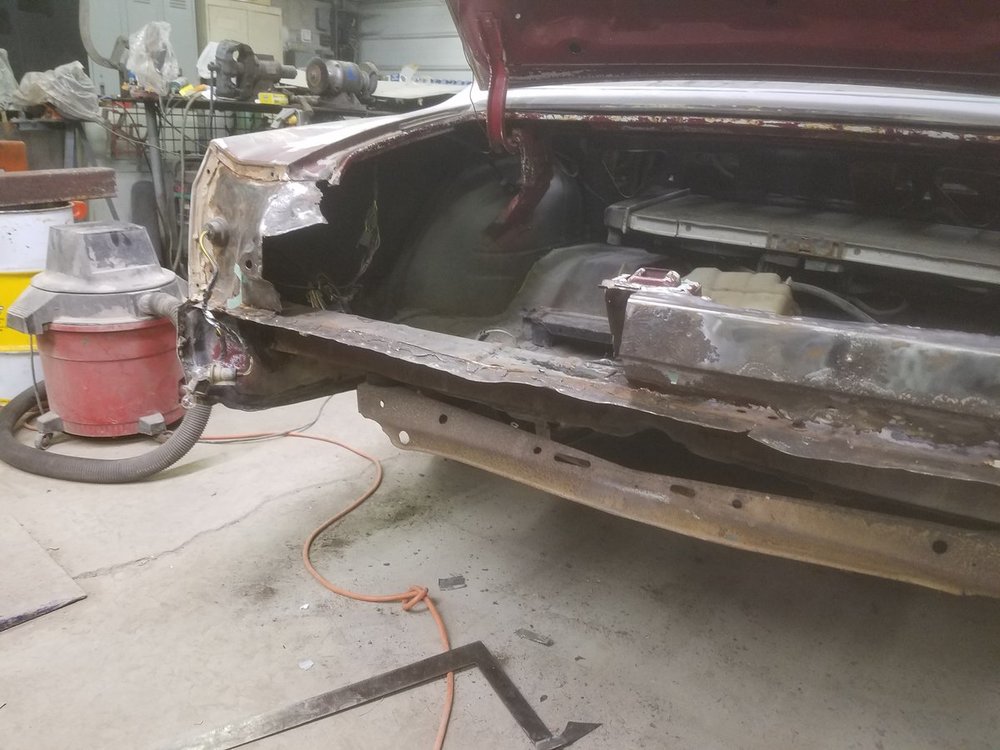

Small update. Haven't done any new work to this area yet, but I got a hold of Beldenspeed.com and they don't want to sell me their gutters, because they don't think they will help me. I can totally respect that! They said their gutters stop right at the curve, so they don't have the corners. I also don't have the necessary "lip" on my new pieces for their gutters to weld to...which I haven't put in place yet...because i want to make sure they are in the right spot...and I was going to use their gutter for placement lol. So now I have 2 options. First is to buy the AMD or Goodmark reproductions. They appear to have the bottom corners, though the scant reviews I've seen have said minor adjustments to turn radius might be needed. I was hoping someone here would be able to give any sort of review on wither of these products. If they have the corners, I can match to whats left of my gutters to the reproduction piece, and then use the piece to postion my trunk latch. Option 2 would be to basically fabricate everything myself, or at least do the corners myself, so that I can maybe purchase the pieces from Belden. I do have the old corners, they are just all rusty and covered in filler...but could probably used as a guide at least. So let me know what you guys think! When I get off work tonight I might try getting something done.

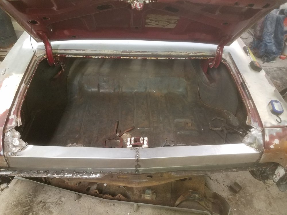

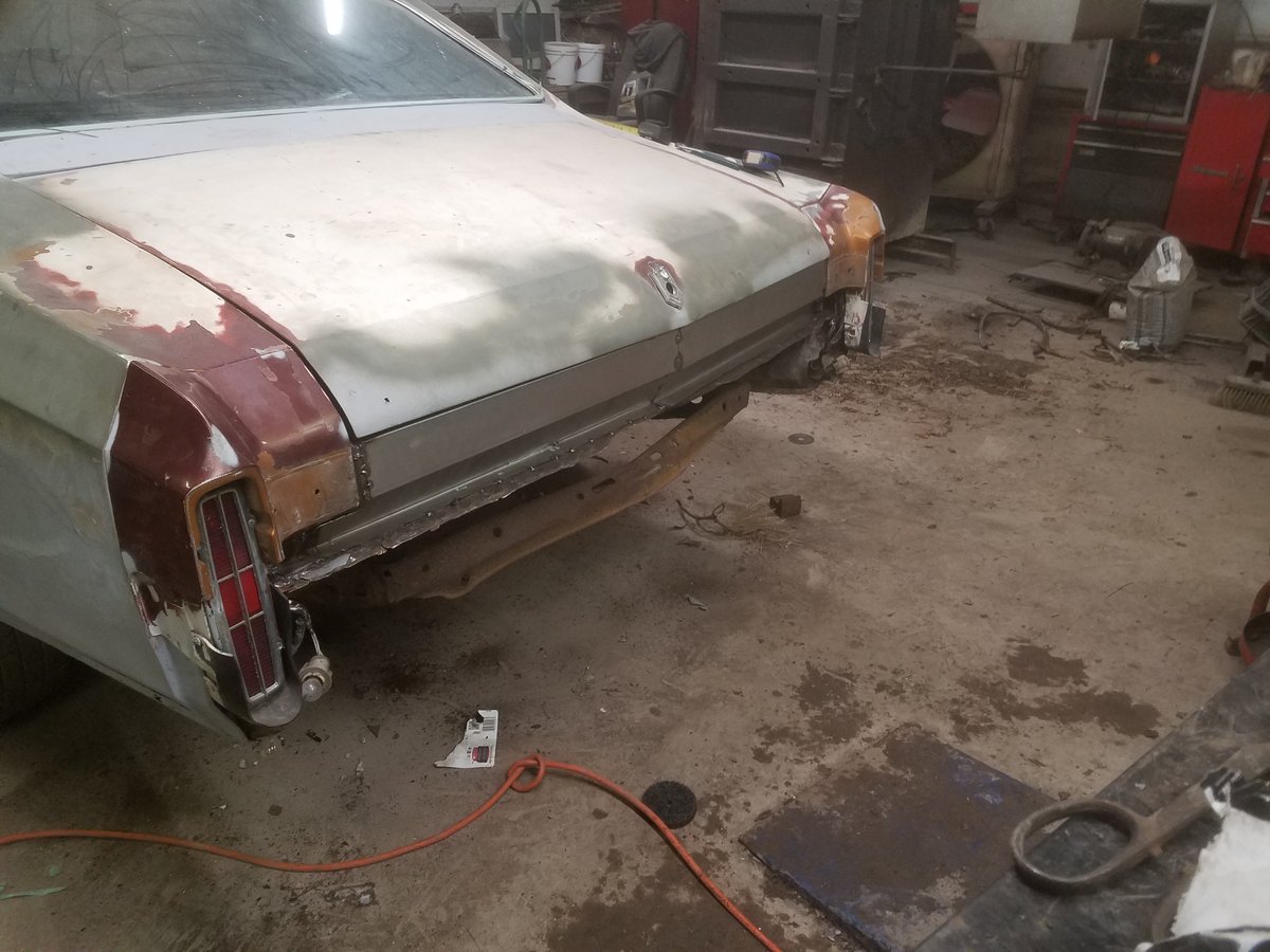

Passengers side is in. I think it looks good! Still have to put the bumper on, but it looks ok holding it up. Waiting to clean the welds/ re weld until I've got the lower trunk gutter. Want to make sure I don't need to re do anything.

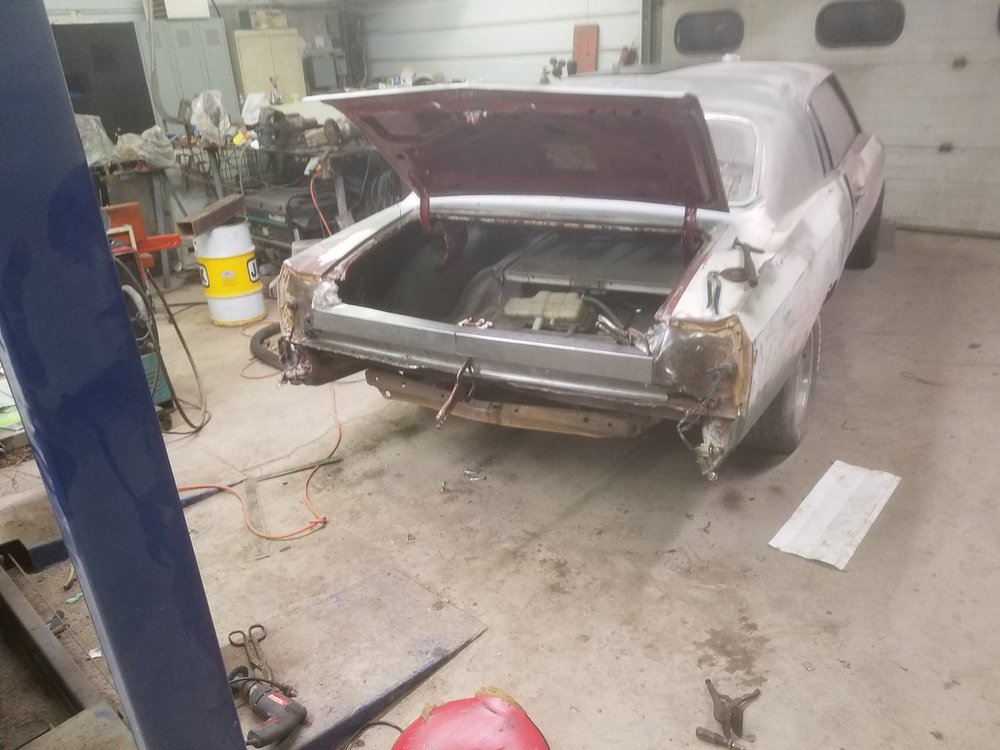

Tail light extensions on., cant put bumper on until its tacked, but I think it looks good. Measures the same on mirrored sides, so I should be even.

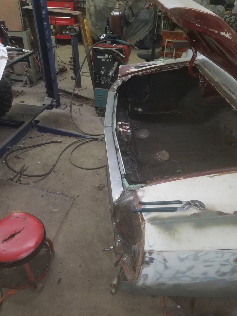

Last night I trimmed the passenger side and got it clamped in. Waiting to tack til I have a second set of eyes and hands lol.

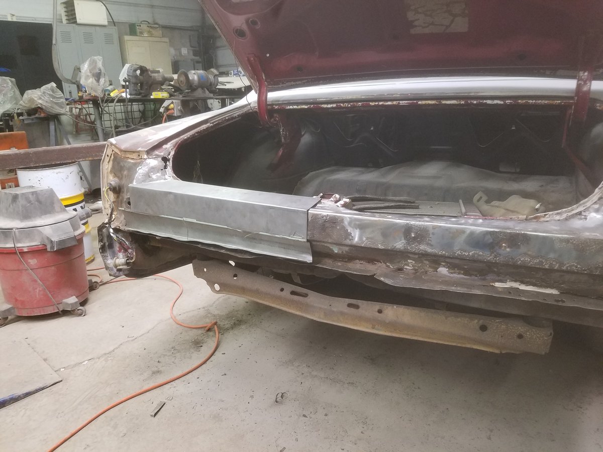

Well I spent the week slowly but surely making 2 identical pieces. Today drivers side went in. I think it's looking good! Definitely have some issues that I'll have to make sure to address. I'm thinking I might buy the lower section of the gutter from beldenspeed.com. that way I can line it up with remaining gutter(upper half should be salvageable) and then know where additional patches should go. It may not look exactly stock but it will still look good! Let me know what you think!

20. I have a sheet of 18 but with the bends 20 is very sturdy . I started on attempts numbers 2 and 3 . Took my time and did everything to both pieces simultaneously to ensure they matched this time...they are identical enough for me now. They need to be trimmed a bit still before tacking in. Hope to get at least the one side in by Sunday.
Well we will call that first one the practice patch lol. It actually went in extremely nice after cutting out that half of the original...but it turns out one of my bends was slightly off making the face of the panel a tiny bit taller. This wouldn't have been such a big except I already did the first few bends on piece number 2 and they are spot on with the original. So next thing to do will be cut another piece and bend it at the same time as the other, so I know I have identical bends. More to come!
I'm having some fun. Not there yet but looking better and better. Going slow but I have enough steel for a few attempts. I've talked to Leo, and I'll cave if I think I have to. I think this can be done ! It just wont look exactly like factory but I don't think it needs to.
