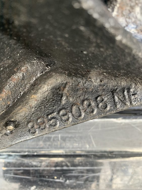

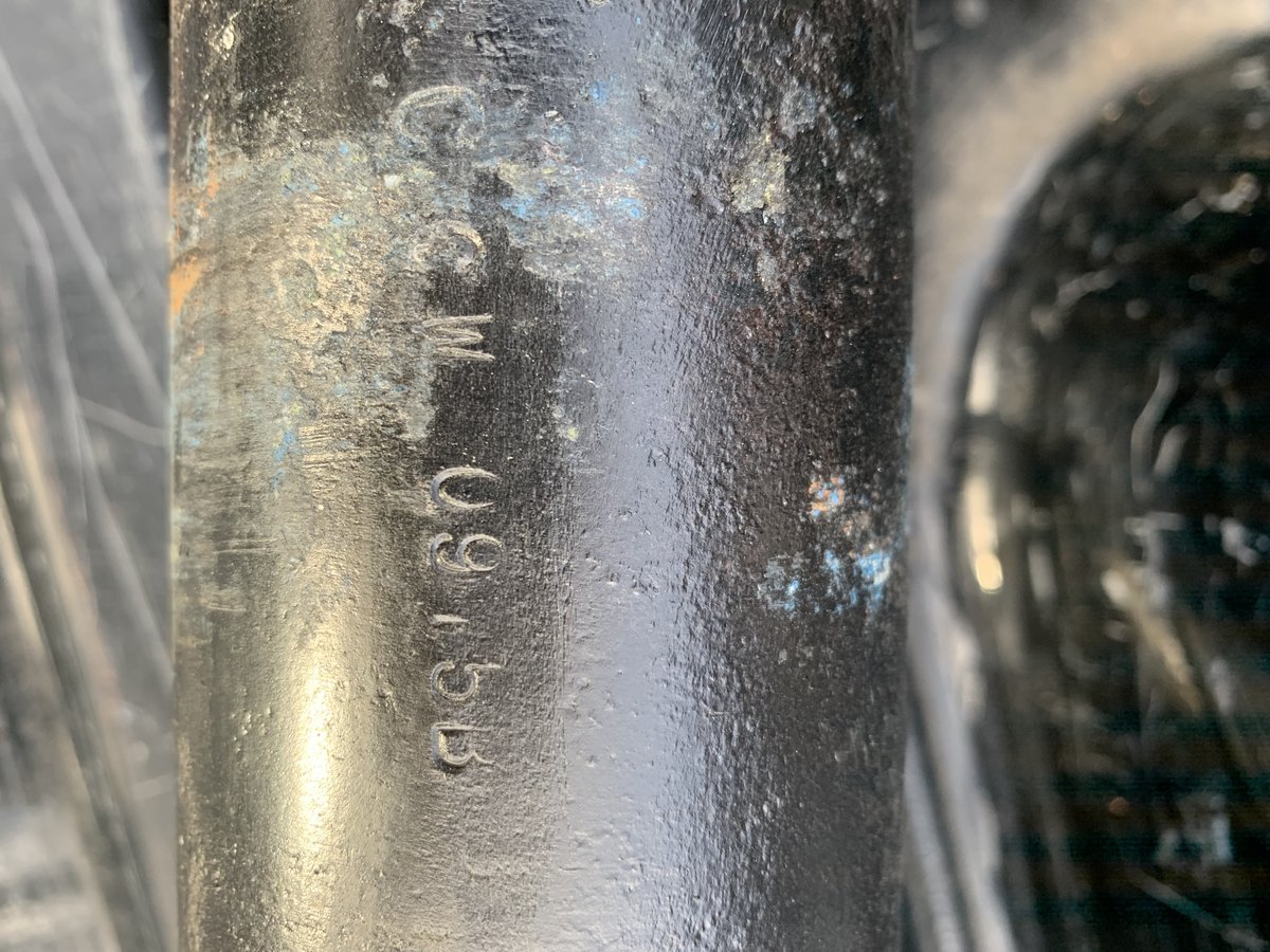

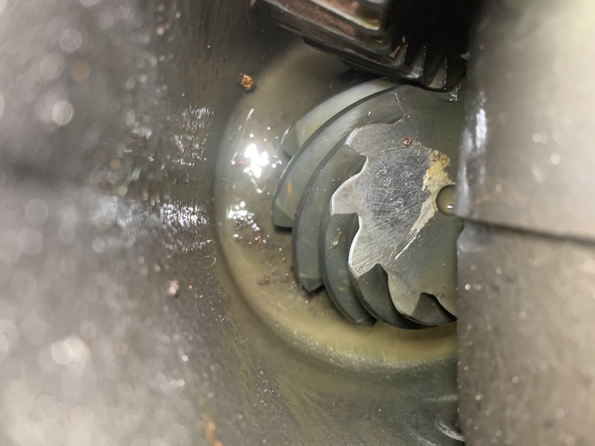

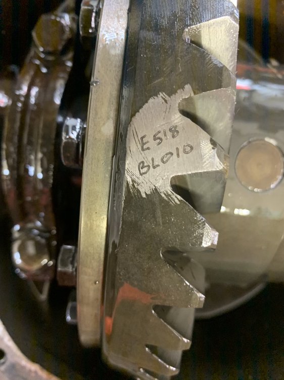

I lucked out and found a 12 bolt on craigslist. It’s out of a 1970 Chevelle with an axel code of CCW 09*5B, and a casting #3859038MF. If my research is correct it originally had a ratio of 373 and was an open rear. The seller told me he thought it was a 331 posi unit. Upon opening the rear it has Richmond gears and after counting the teeth it was a 354.54 ratio or as Richmond confirmed 355, and is a posi unit. After reading multiple threads here I’m a little confused, some say that the upper left control arm will have to be changed, others say it will work fine. Has anyone done this type of exchange and did or didn’t they have an issue with the control arms? Thanks J

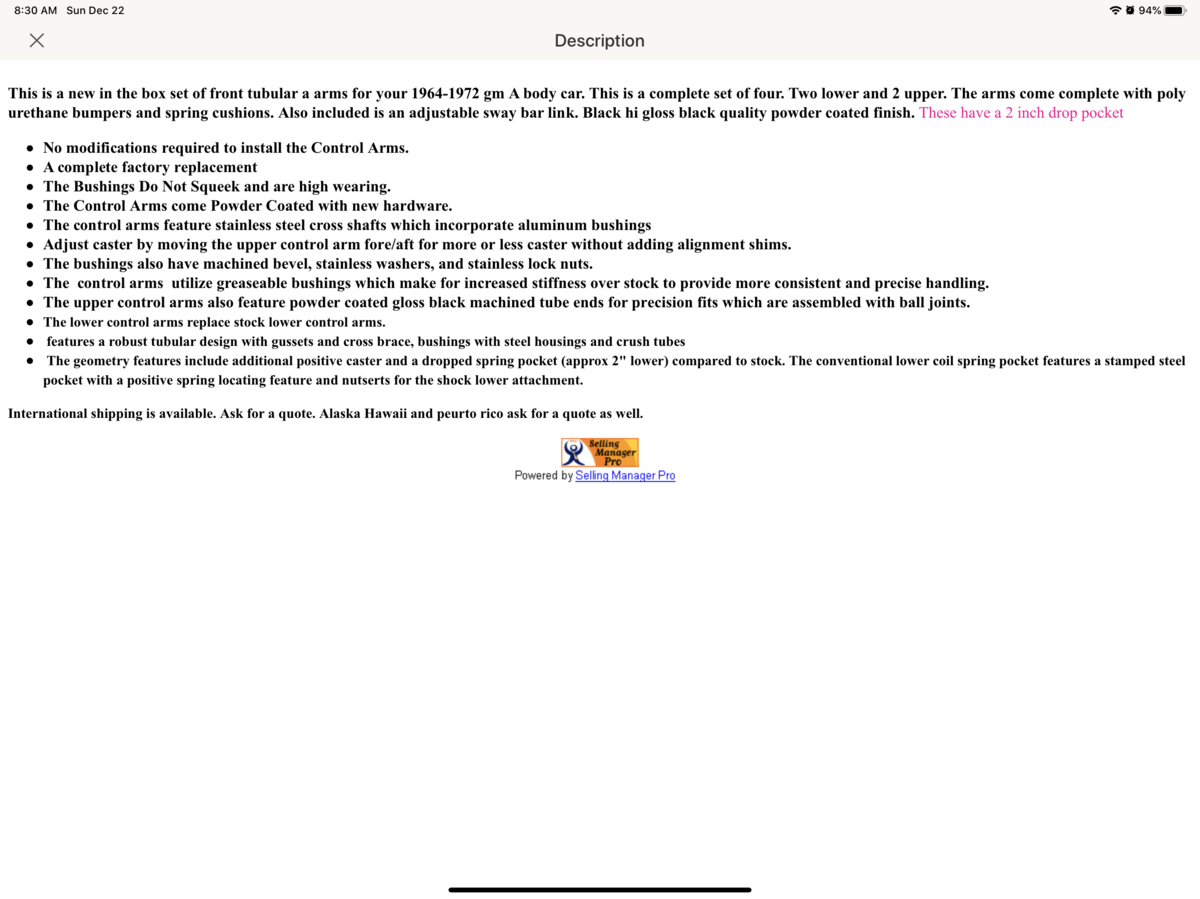

Good morning all, Since I have to replace the upper ball joints and springs in my 71 MC I have been investigating tubular control arms. There is a set for $219 on eBay. Has anyone used these and if so what was your experience? I have two concerns, the first is “you get what you pay for”, considering that they are half the price of brand names, are they junk or OK?, The second is the rule of unintended consequences: when considering that the lowers have a 2” drop pocket, it seems to my uneducated mind on this subject that this is a significant change in the geometry that could cause binding or sever angles, am I correct? If so is it something that can be overcome and how would I correct the problems it may cause? 1” could be OK but I’m not sure if a 2” drop is something reasonable. I like the idea of better caster and camber angles as what I read suggest the dancy nature of the steering.could be addressed. With this change I plan on going with QA1 or Viking (depending on the best deal I can make) coil over shocks, and I think these shocks have enough adjustment to compensate for the ride height, but does moving the shock down so low cause other issues? Thank you in advance for your replies.
