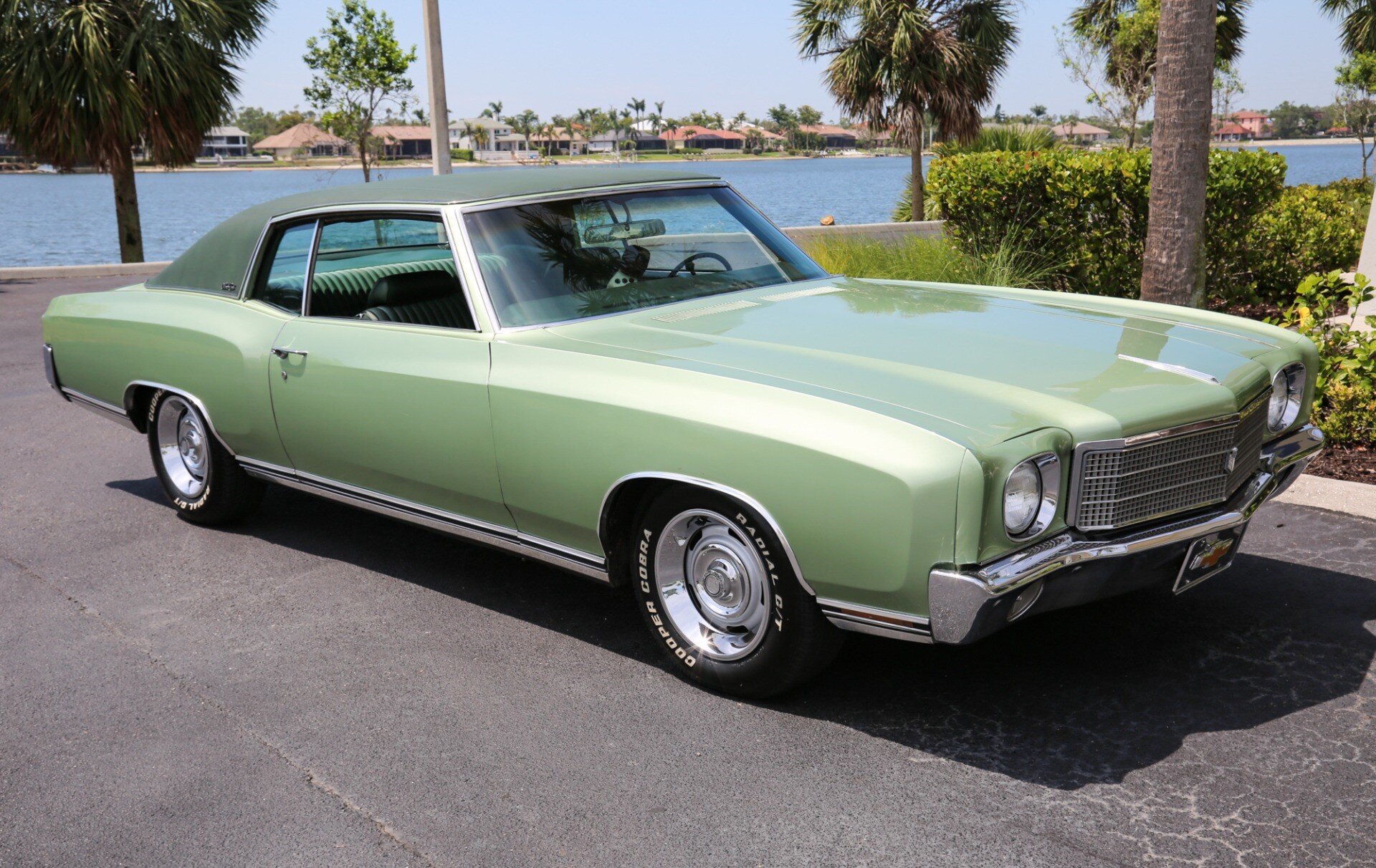

    My 1970 Monte
    Picture of as purchased in 2023 with bench seat, column shift, 350 4bbl, turbo 350 and 10 bolt rear. Now has Scat 90 buckets(just got a pair of strato buckets to restore) floor console, full QA1 level 2 suspension and a 12 bolt 4.11 with c clip elim and wilwood rear disk brakes. New master and booster with all new lines. New 275-60 r15 Mickey Tompson. Installed new Tanks gas tank with in tank fuel pump and 10AN supply with 8AN return for soon to be installed LS3 bored and stroked to 427 Blueprint crate motor with built 200-4R 2600-2800 stall. Trying to run 11.5
