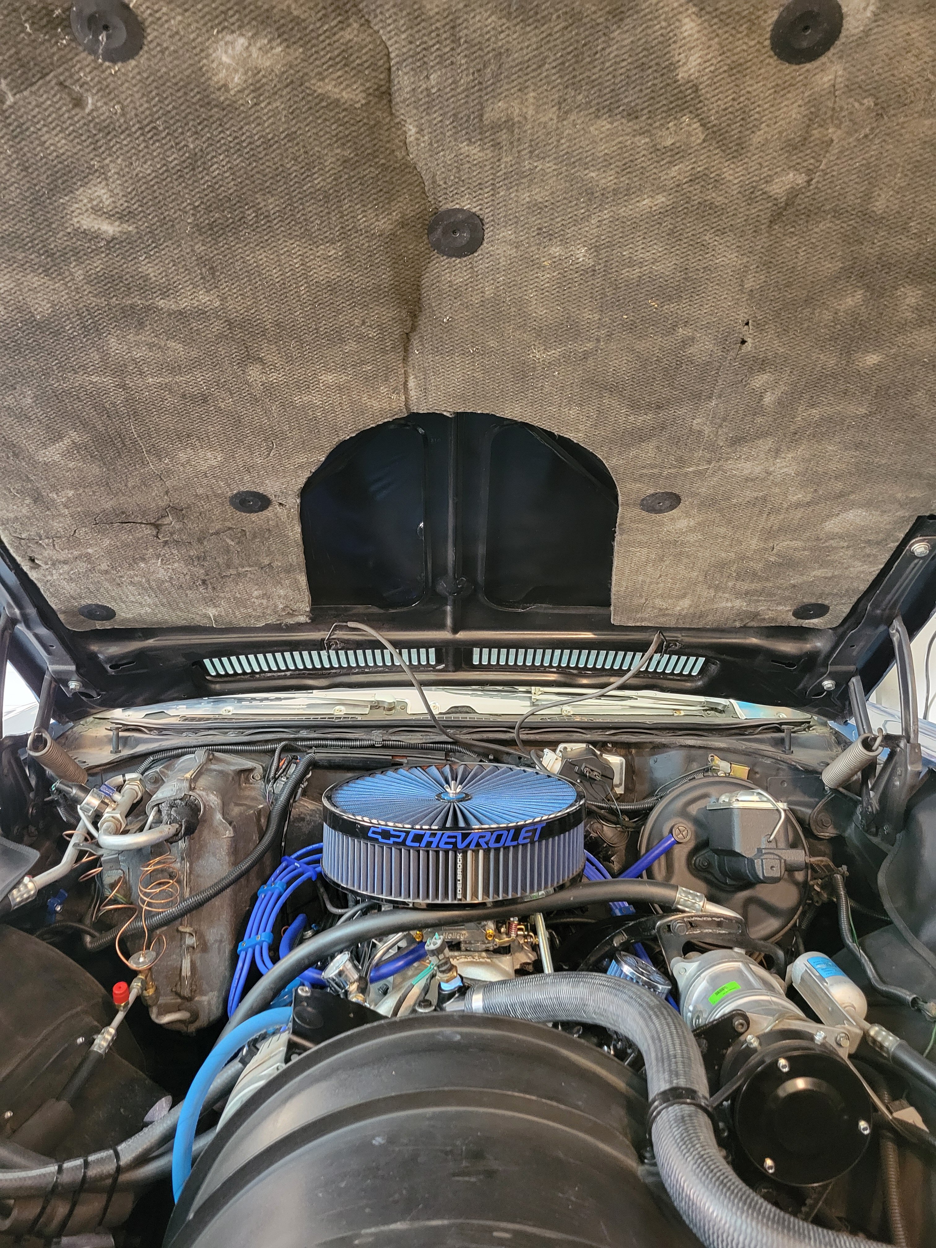

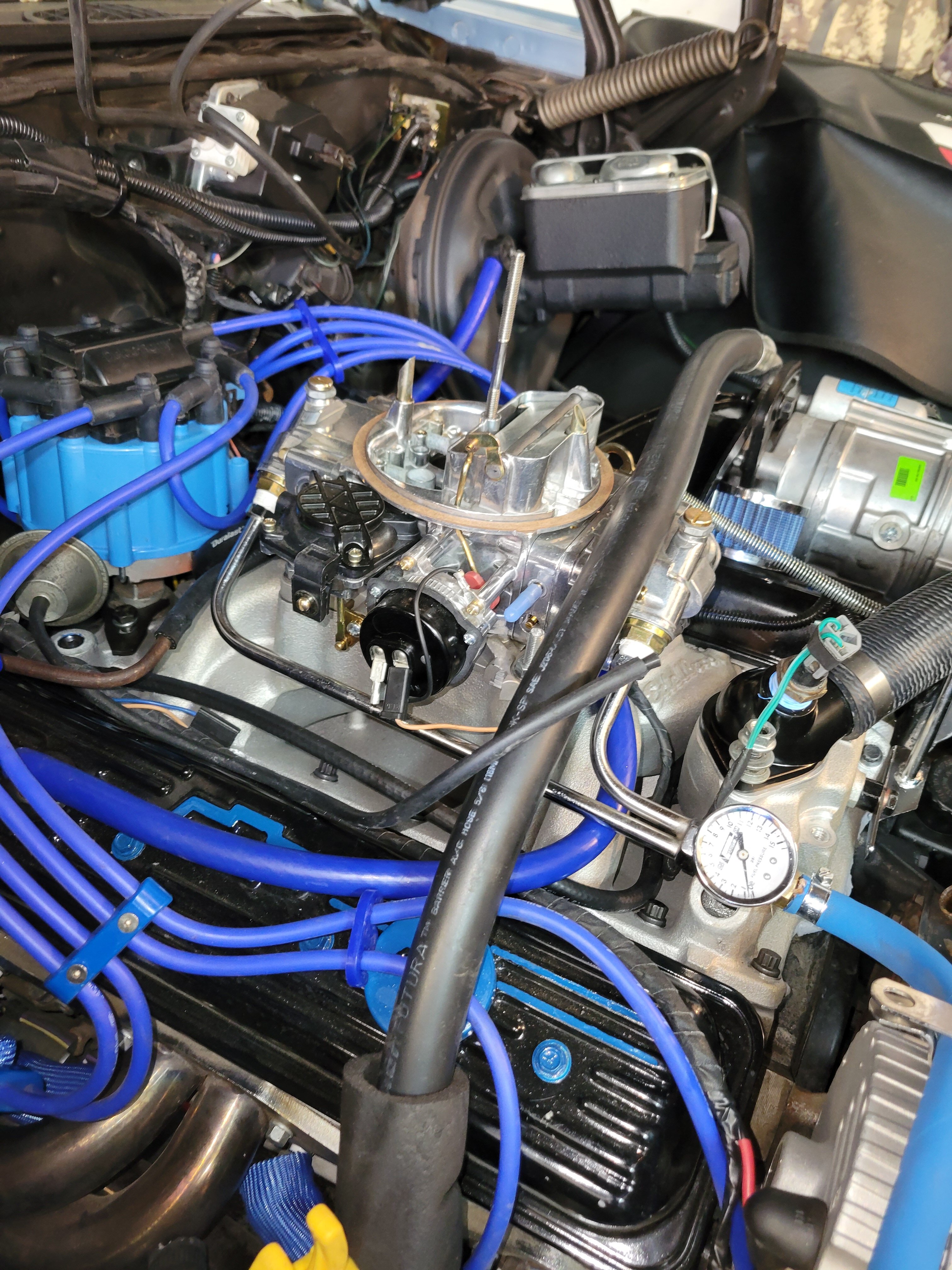

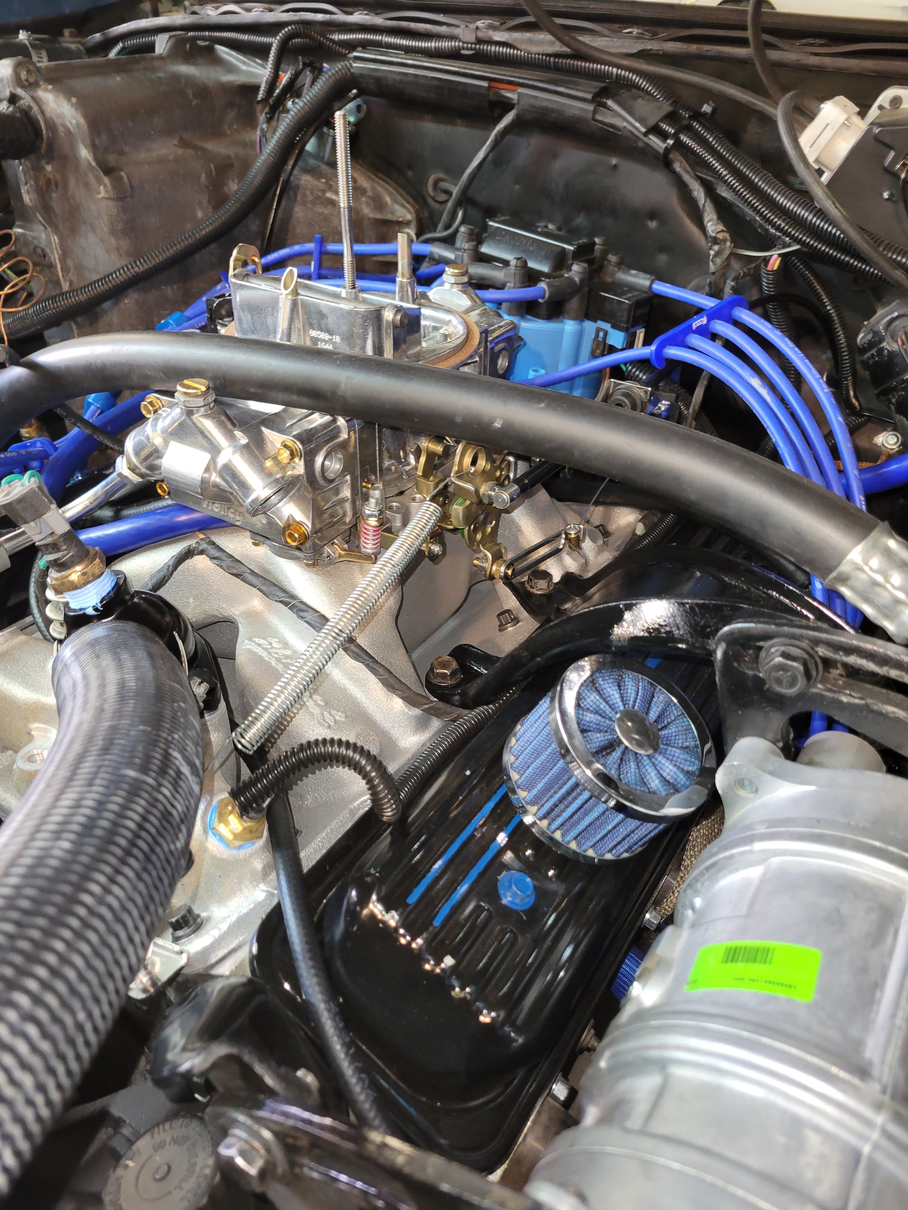

Okay, a couple of weeks ago I finally yanked the undersized Edelbrock Performer (2101) manifold and installed a proper Edelbrock Performer RPM Air Gap (7501) on the 406 CID Small Block. Man did it make a big difference too. And yesterday (8/31/25) I installed a Holley 12-327-11 fuel pump (110 gph) to replace the stock Carter pump that was on there, both mechanical. That also made a difference, been wanting to do this for a while too now. Thanks,Matt Here are some pics: -
Excellent pictures and thank you for sharing! Great looking Monte's Thanks,Matt

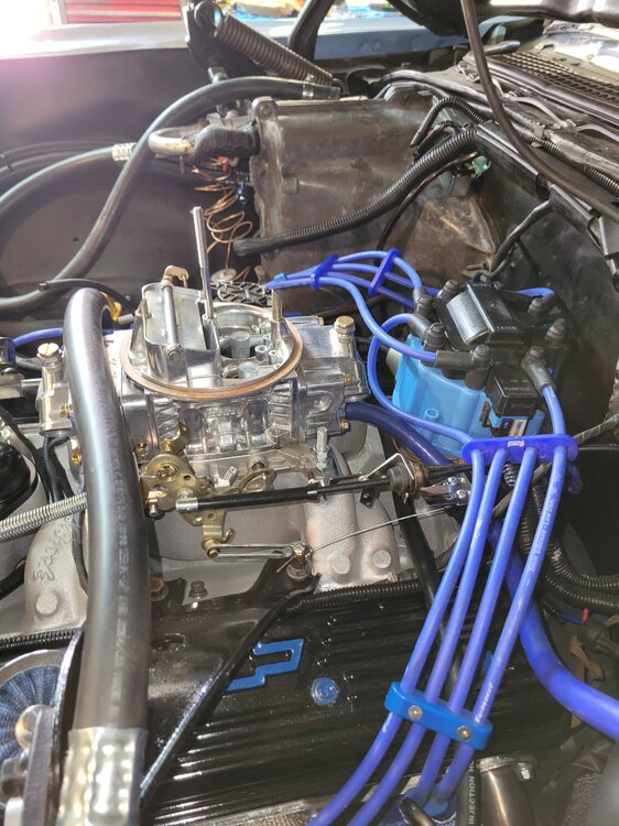

Ok I did a couple things here recently: 1. Wednesday July 30th, I had a 2300-2400 RPM stall converter installed, flashes at 2700 RPM (no pictures of it, but what a difference, it sure needed it, the stock was way to tight) - huge difference, immediately! 2. Friday and Saturday, August 1st and 2nd, began and completed the intake manifold change out from a standard Edelbrock Performer 2101 to a Edelbrock Performer RPM Air Gap 7501 and 160 thermostat, new coolant etc. - man did this make a huge difference coupled with the new stall - other manifold was way too small for my 406 CID small block 3. Changed the vacuum secondary spring from the standard natural color to the next lightest Purple spring - it needed that too, now it's matched perfectly and opens up the secondaries when they are needed and not delayed 4. Installed a transmission cooler today, Sunday August 3rd, topped off the fluid accordingly - this will keep the tranny temps in good shape along with the new stall converter. Thanks, Matt Here's some pics: -
