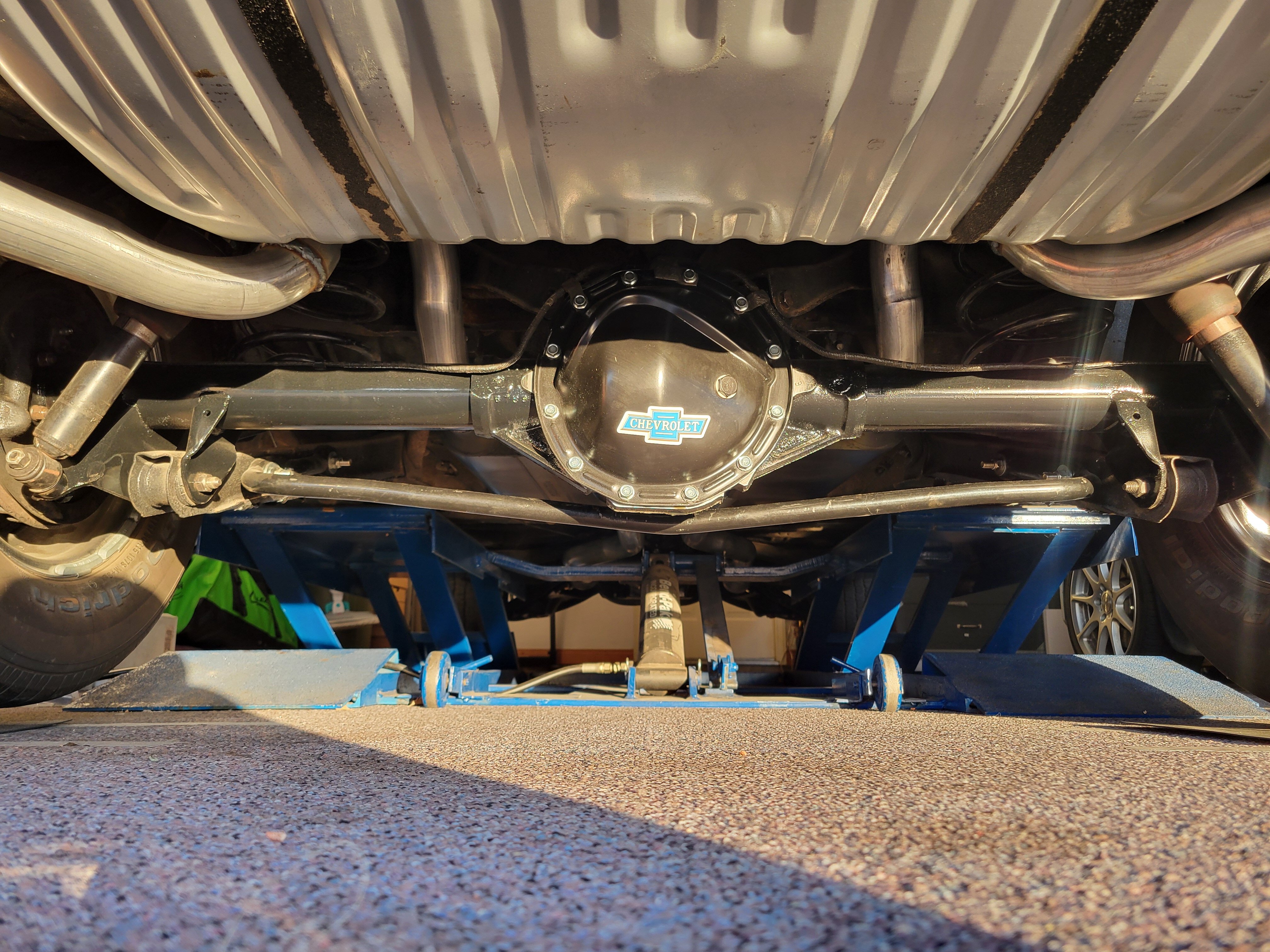

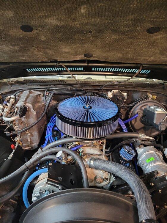

I know that it's not Carlisle material, and I can't wait to see more from your trips there (as I am following eagerly),but I ditched my 2.73 gears yesterday in favor of some new 3.08 gears in the 12 Bolt, Hoopers did an amazing job as always, completely cleaned and painted the rear end too (1 day turn around, in at 7 AM and out at 3:30PM) - I really like them a lot! Additionally, I put on a flow thru air cleaner lid: Upcoming To Do's (soon): 1) Install correct speedometer driven gear to correct speedometer reading 2) 2400 stall converter 3) Edelbrock Performer RPM Air Gap intake 4) Gear Vendor overdrive Keep the Carlisle updates coming and pictures, I really wish I lived closer (California ughh) Thanks,Matt -

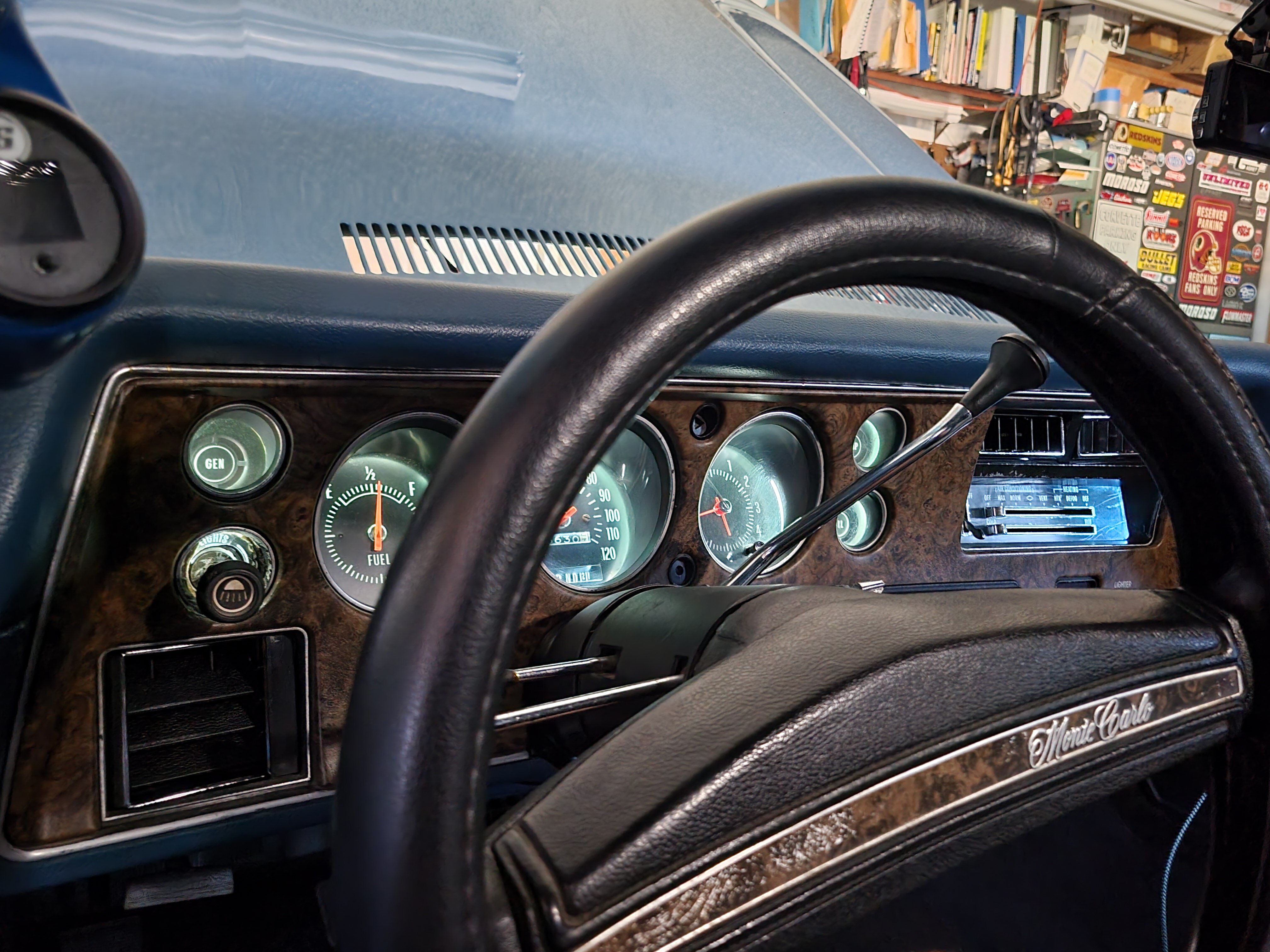

Thank you - Yeah that is no joke, that had to be by far my biggest challenge and thankfully Tina has small hands and arms and it was a breeze for her! And now I can aim my A/C vents in the direction that I want and they will actually stay pointed in that direction - LOL Thanks,Matt -

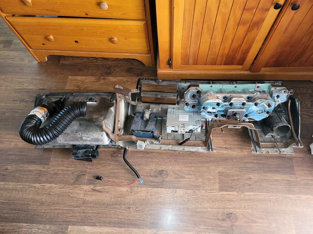

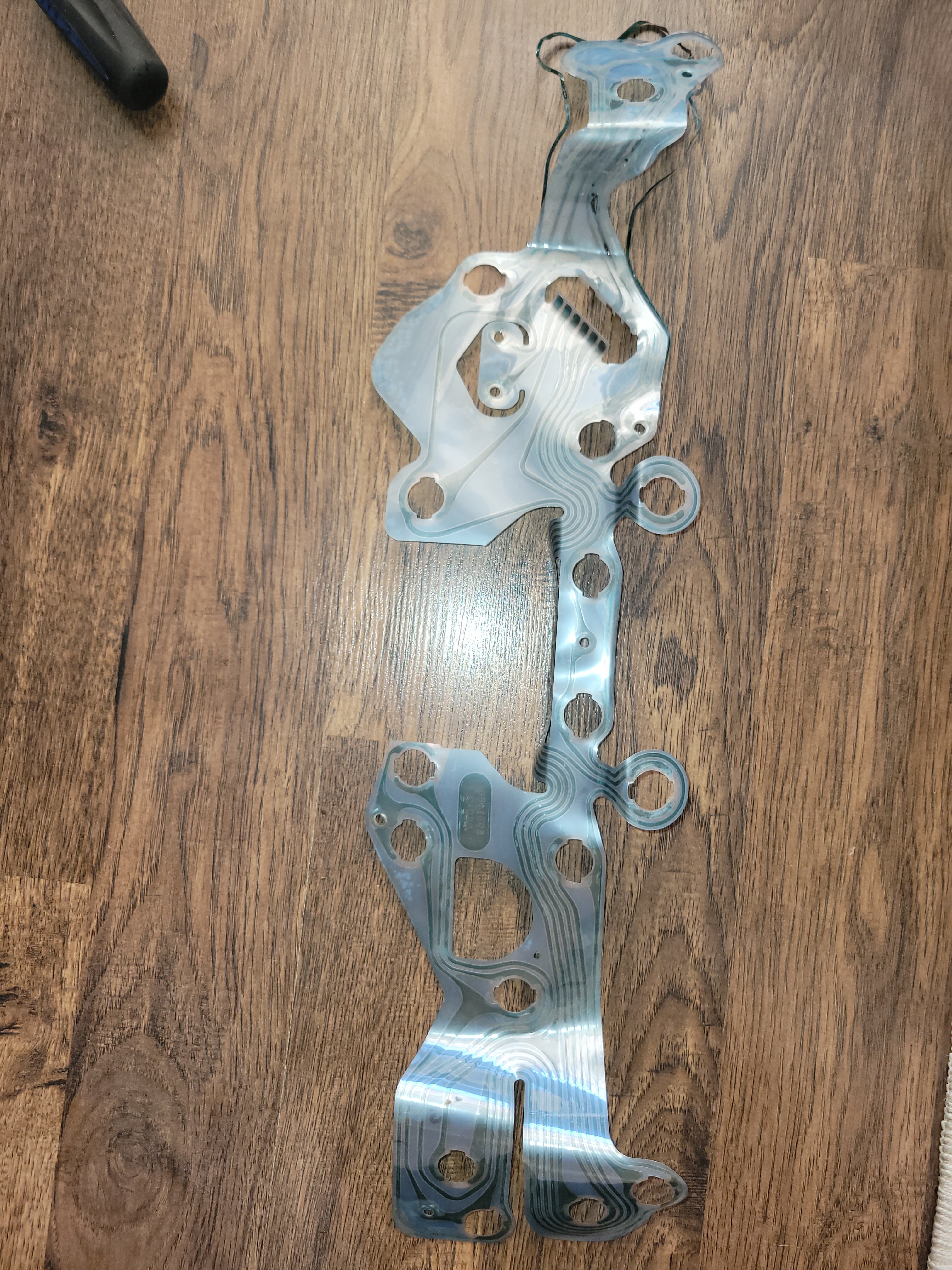

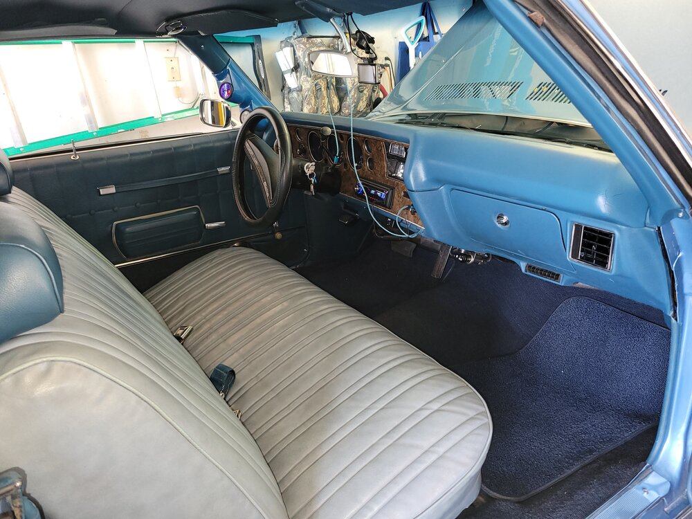

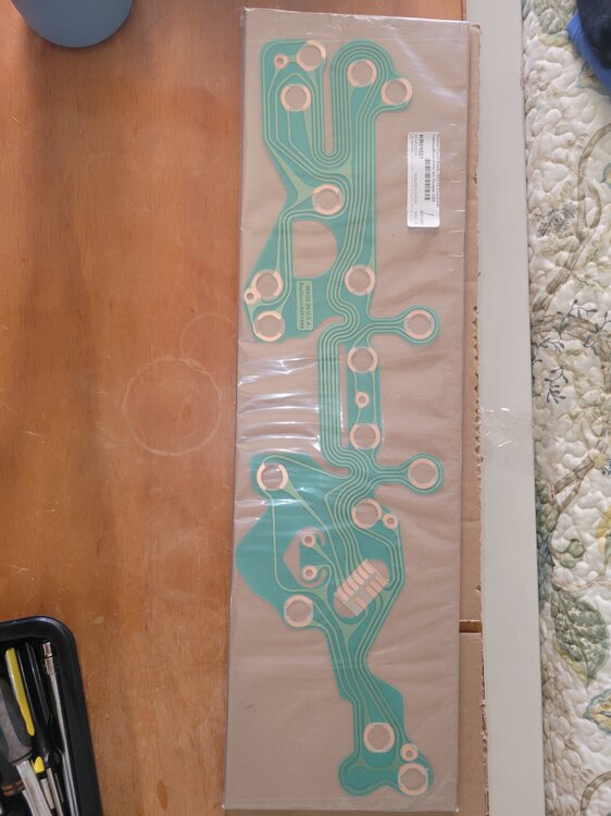

Been working on the Monte the past few days replacing: (1) Dash Clock - New quartz movement (works flawlessly, really happy with this fix) (2) Gearshift selector indicator - (works flawlessly - my fault, I broke the stock one, ughh!) (3) Replace all dash lights with "White LED's" - (looks fantastic) (4) Replace the Printed circuit board - the old one just was too brittle and practically fell apart (5) Replace all main A/C vents (middle, driver, passenger) (6) Go through all the A/C ducting and seal the joints from previous owner (just wasn't done correctly) (7) Clean everything and put it back correctly and replace any and all missing parts from previous owner (8) Lengthen the grounds for the headlight switch and the other two lower grounds that go to the support brace and install male/female connectors to make removal and installation easier Try not to pass out in the triple digit heat here in Palmdale, California - LOL Note: My wife was kind enough to come out there and assist with the re-installation and "She" is the one who re-installed the SPEEDOMETER Cable - I just couldn't get my big ol' hand and arm back there - LOL. Tina did it in one try and click, bam, done! (Credit where credit is due) Thanks,Matt
