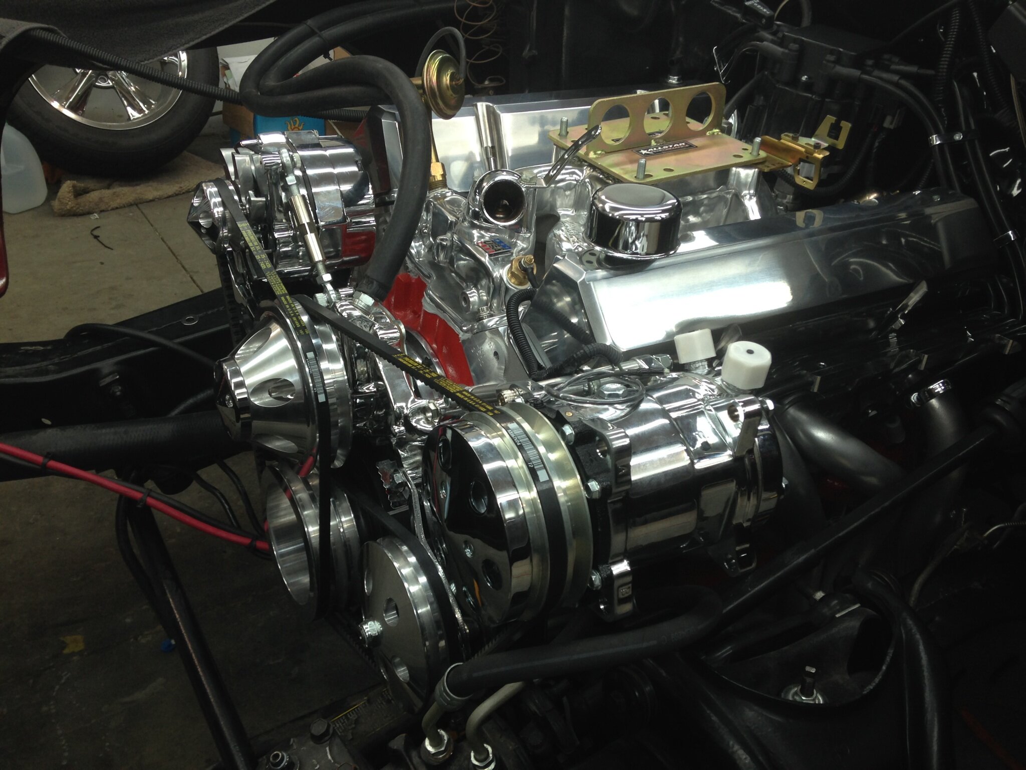

  5. I have been meaning to get back here and update you all once I have had some road time in. Sadly I havent had much time to drive her. Ive managed to put on only 80 miles in the last month since getting the engine in and working out several gremlins. Should have been a simple engine swap LOL, due to changing sooo many things I had several issues. As always in my case the car loves to fight with me and seems I must beat it into submission. But I managed to get past her stubborness and actually get her down the road. I will have to update again once I rack some more miles on but for now heres what I can tell you. Not sure of fuel economy yet, but doesnt seem very good LOL. A bit of a learning curve driving her with the new power level, I find myself going sideways sometimes (when I didnt mean to). I used to think my tires had plenty of traction (Nitto 555's 255 50 17) come to find out they spin like mad even at 3/4 throttle LOL. Quite happy with the results so far and looking to gather more data for you guys in the next month as I plan on getting more road time with her.

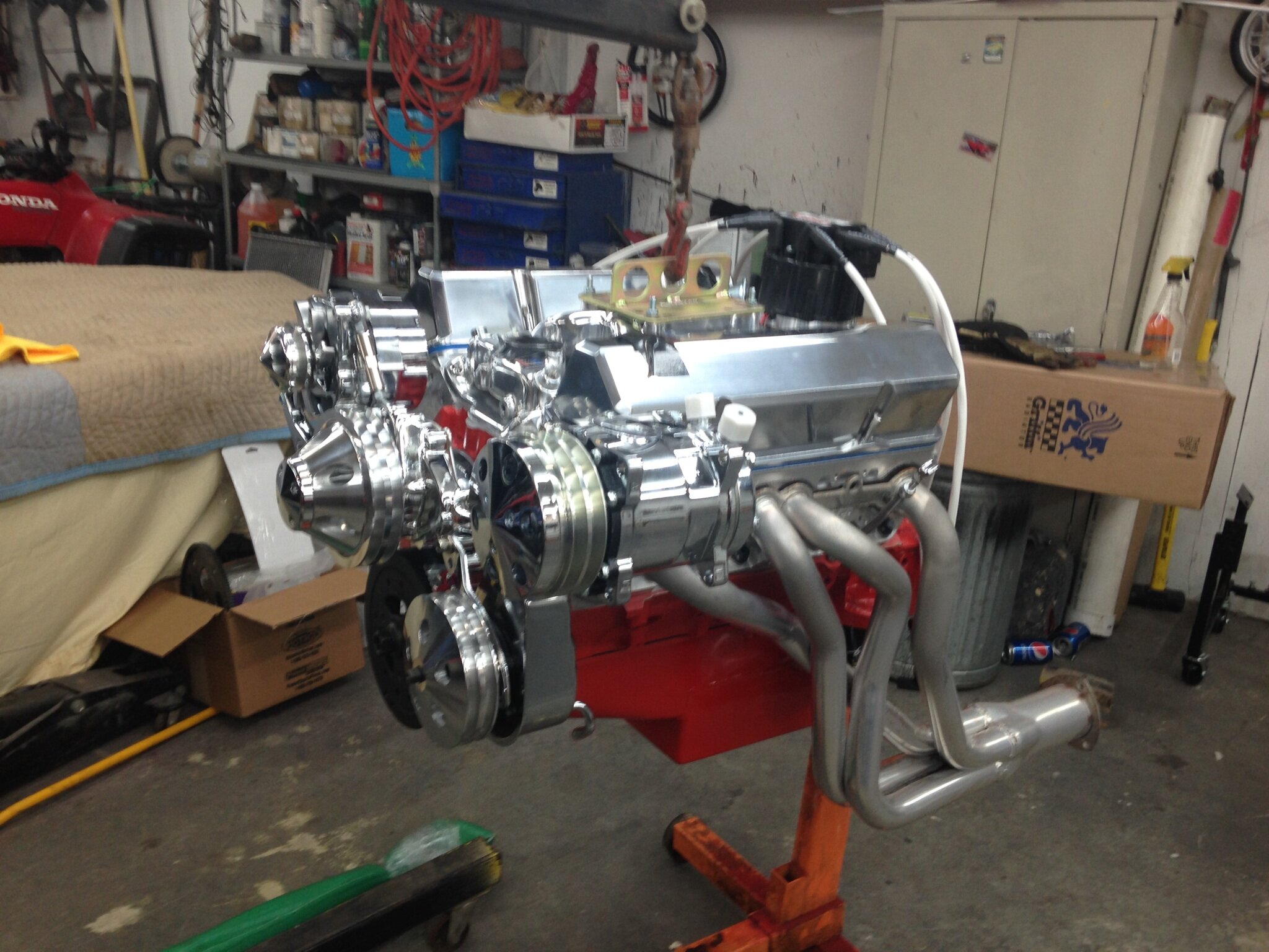

  12. Not today but last weekend I pulled the old engine (not real old, only 4200 miles on it LOL) in preparation for the new stroker.

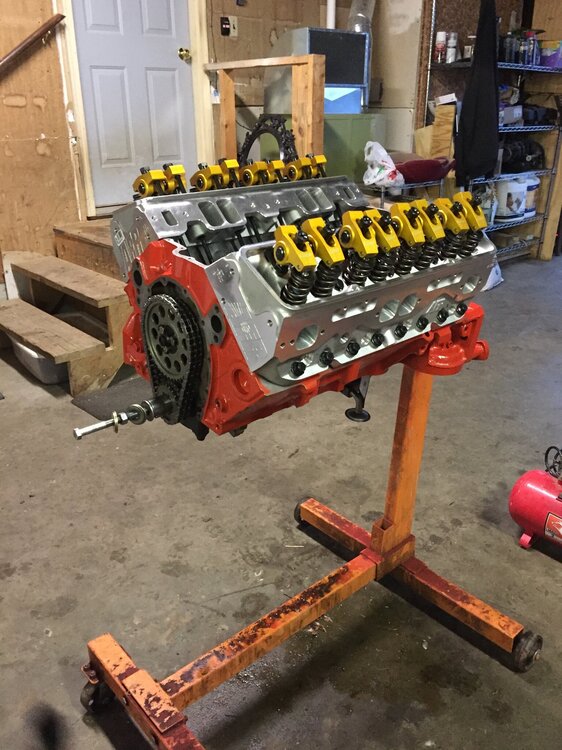

  16. Ok guys back to this 383 build. Thanks for the input so far. Its taking me awhile to gather my parts together, kinda buying them as I can afford it. But Im just about to get going with assembly here. Figured instead of making a parts list its just as easy to post invoices of what I have purchased so far. You should be able to zoom in to read part #'s & pricing. So if anyone is thinking of a similar build they have some part #'s. This is going to wind up just over 10:1 Compression, Straub says 10.5:1. He also states should be @ 475hp and 500tq easy, may get it dynoed once complete to get some exact #'s. Cam specs will be listed below. I originally thought Straub was going to grind me a custom cam but turns out an off the shelf Clay Smith cam would be perfect for me here, so thats what he sent me out. All the parts on this build are from Straubs recommendations, except for the forged rotating assembly, you could get away with some cheaper/stock/non forged components there but I opted to pay a little more for piece of mind. http://www.claysmithcams.com/sbc-350-to-360-cid-afr-180-to-190-head-max-power-6000-6200-rpm-peak-torque-3800/ I chose a internally balanced forged (crank, rods and pistons are all forged) kit from Scat costing just over $1500. According to Scat most 383 builds with these I beam & 7/16 cap rods may not need any additional clearancing. We will see about that as the assembly process will be beginning soon. More info on that later. Im using Morel hydraulic roller lifters, Crane gold roller rockers, AFR 195 75cc heads (pistons are +3.7cc flat top), Rollmaster Billet timing set. A 6 quart oil pan with crank scraper and windage tray. All ARP bolts. Pics below will sum up everything else pretty much. Im in this so far for about $6000, started out with a free 4 bolt main block circa 1971 out of a chassis cab, probably a dump truck. Labor on the block (without any clearancing done yet) came to $270. Cleaned and inspected, bored .30 over, decked and cam bearings installed.
