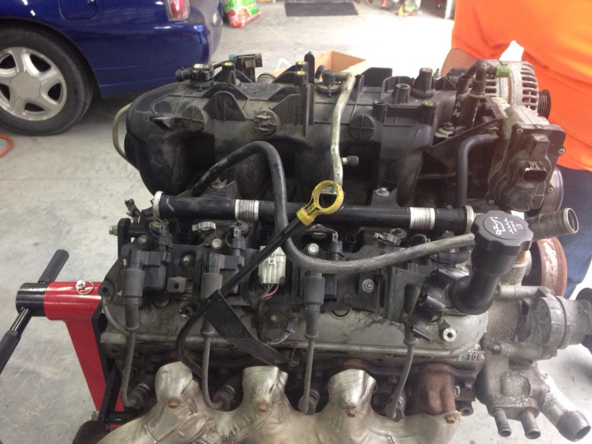

vince Posted June 14, 2015 Author Posted June 14, 2015 Well my E-bay drop out, 5.3 came in this week, I was a little surprised how dirty it was. So I started to take off the accessories and clean it up. With a little paint she will look like new, but first I need to pull the harmonic balancer and change the cam and springs. Quote
Murphy Posted June 14, 2015 Posted June 14, 2015 Looking good Vince...........I have that 5.3 Vortec in my Avalanche, several months ago I was getting KNOCK sensor errors so had to tear it down similar to the picture above. I replaced both knock sensors and harness and the cam sensor since it was easily accessible. The knock sensors are under the 2 round plugs in the valley pan in your photo. Good Luck! Quote

vince Posted June 15, 2015 Author Posted June 15, 2015 Murphy Thanks for the info It's always good to know where all the sensors are. Ian your son is going to love it I have a buddy who installed one in his 68 C-10 4x4 and that truck hauls. If anyone has info on what type of oil pan ill need please pass it on, from my research the truck pan will not work in the Monte. Stand by for more updated pics. Quote
