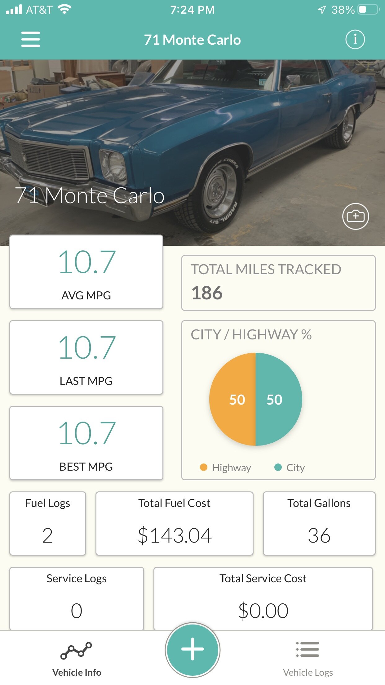

sbarnette Posted June 12, 2022 Posted June 12, 2022 I took my 71 out of storage last October. I don’t remember if I’ve ever checked the mileage since putting the 402 in it in the late 80’s. I’ve only put about 24,000 miles on it since then. I filled it up back in October and filled it up again today on the way to a cruise in and checked the mileage. This is the result. (402 with turbo 400, 3:31 gears, 2700 rpm stall torque converter) 1 Quote
