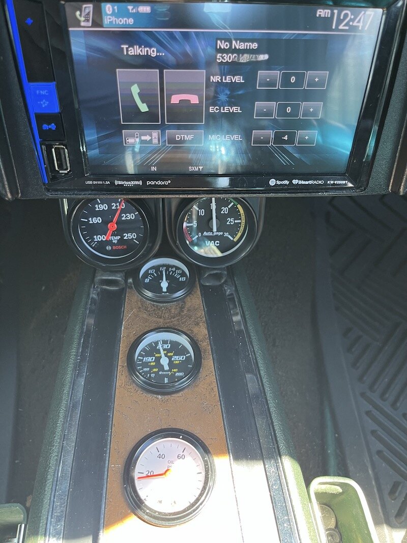

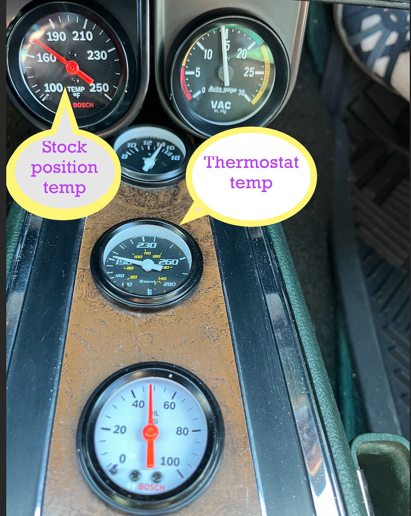

Heating info….
The outside temps were 103 to 107.
AC on full blast. Stock 7 blade fan and clutch, 160 thermostat. Radiator is 3 row stock and in great condition.
HWY, 60 mph light on the pedal at about 1700 rpm , vs …. Heavy city driving stopped and idle at about 650 to 700rpm...

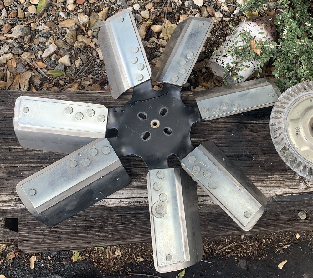

I used this fan for over 20 years and went back to the stock .. No noticeable difference.

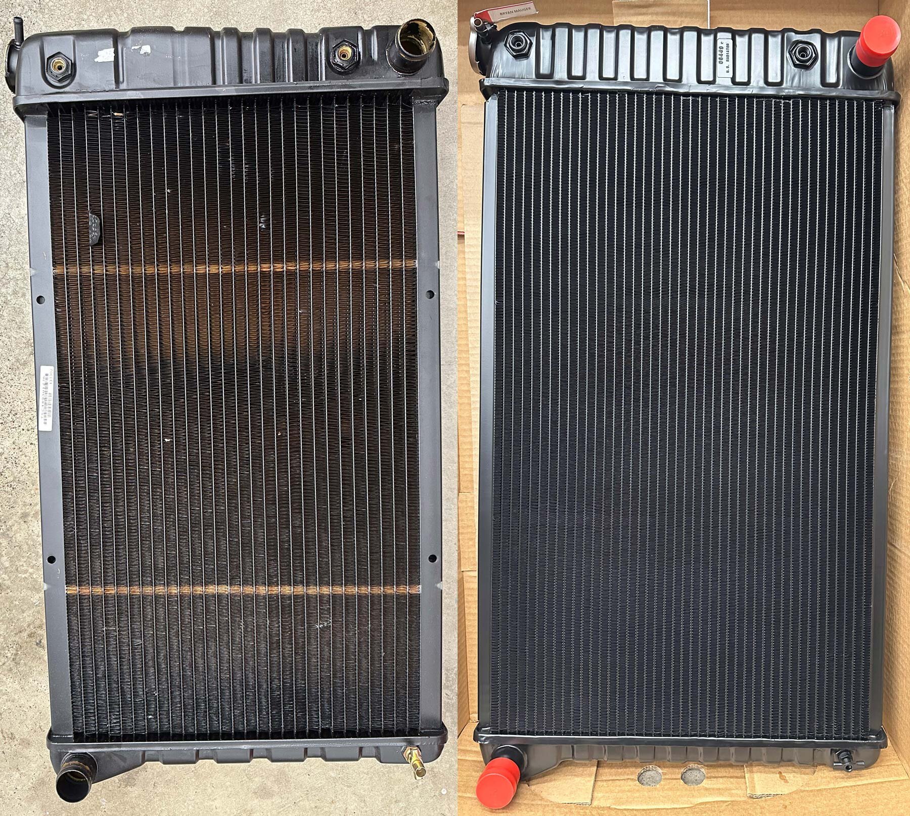

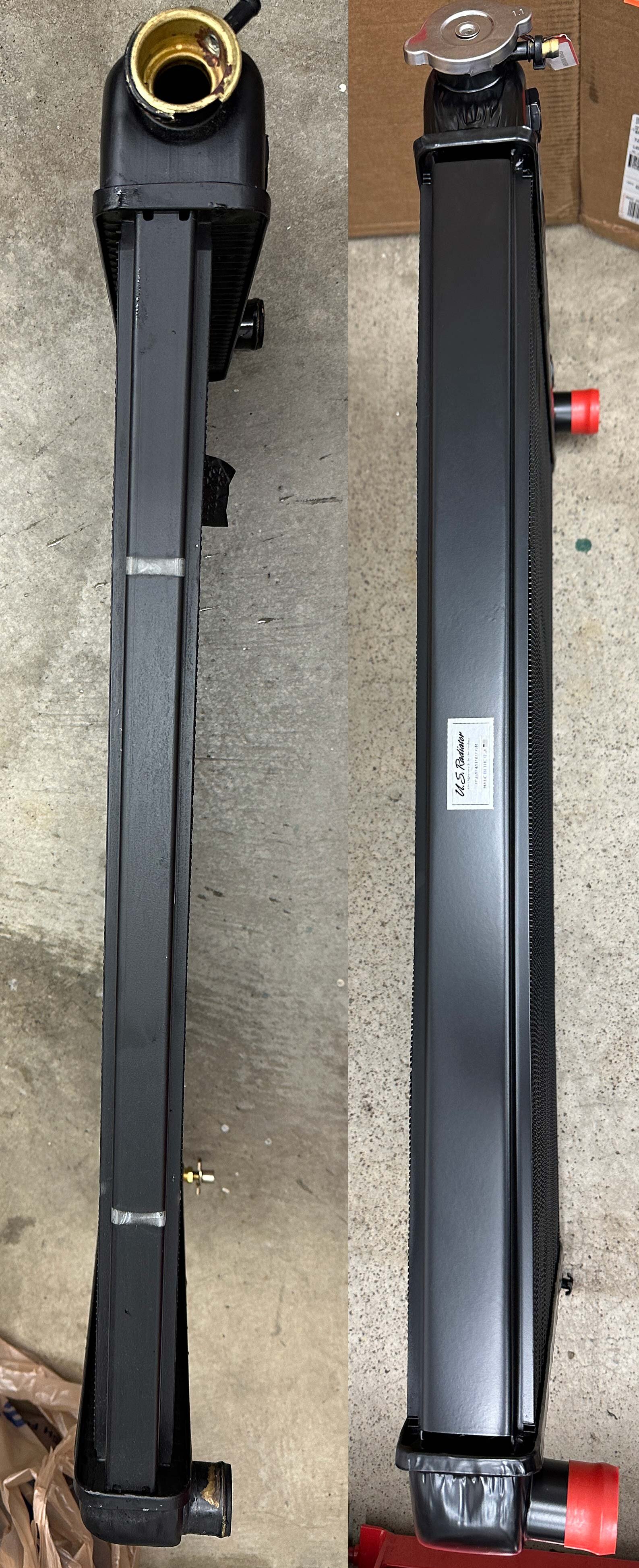

Update: I have installed the U.S. Radiator 4-row and it appears to have solved the creeping temp issue. I've driven it (and idled it) in 85 degree weather and it never went above 200°. It's going to be in the mid 90s here tomorrow but I won't be able to drive it. I'm happy with the purchase. It was expensive but worth it - and it's freaking gorgeous. The workmanship is outstanding. Look at the density of the rows. They are 1/2" rows on 3/8" centers rather than the stock 1/2" row on 9/16"centers. It's something like 40% more cooling capacity. Direct bolt-in replacement, too. 👍
The old 3-row radiator is for sale. Nothing wrong with it, only a few months old.
