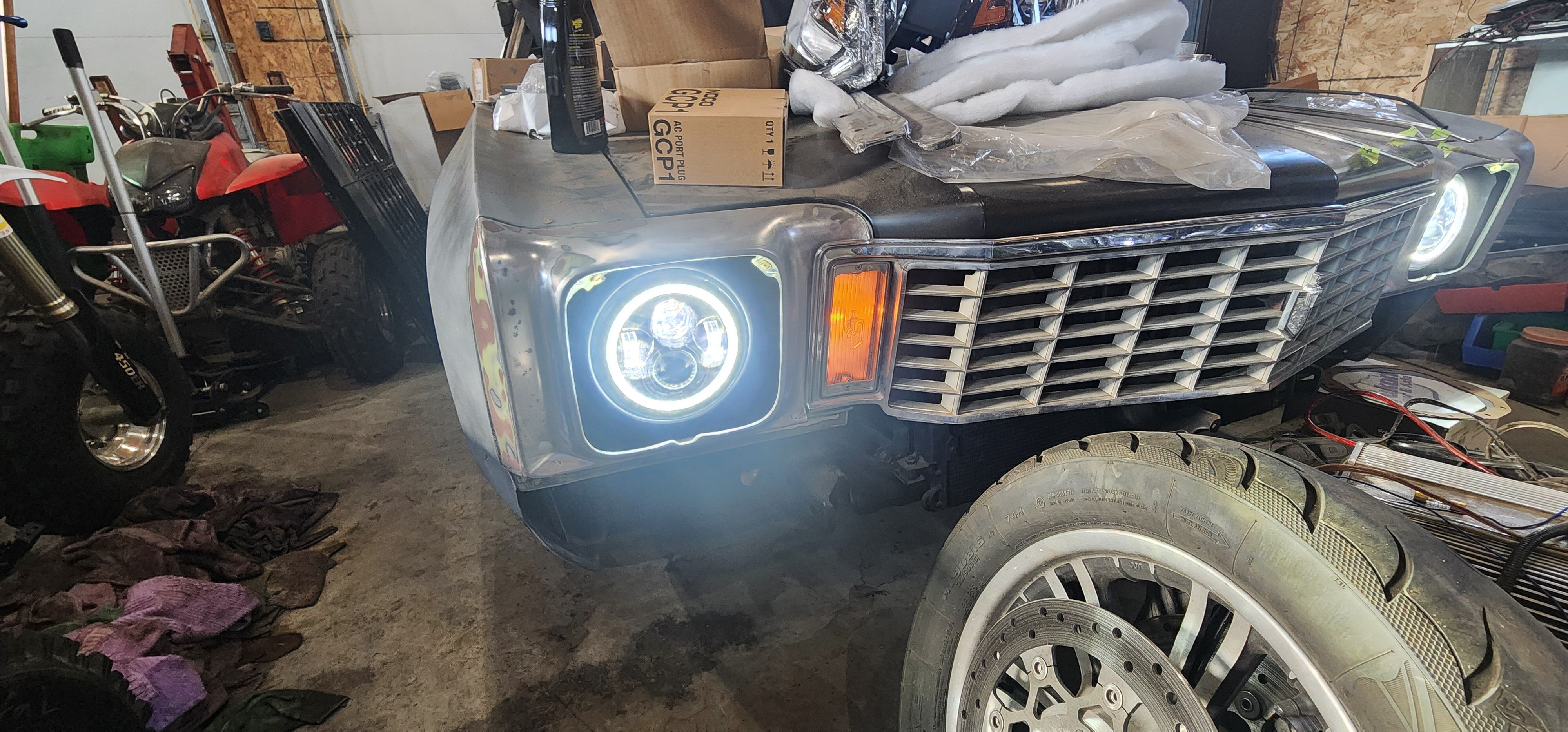

I decided that since my MC is custom built, I opted for LED headlights with halo rings. White halo rings come on with the park and headlights, but they have amber halo lights for when the turn signals are on.
