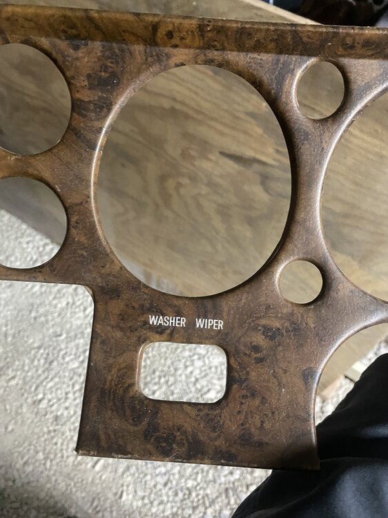

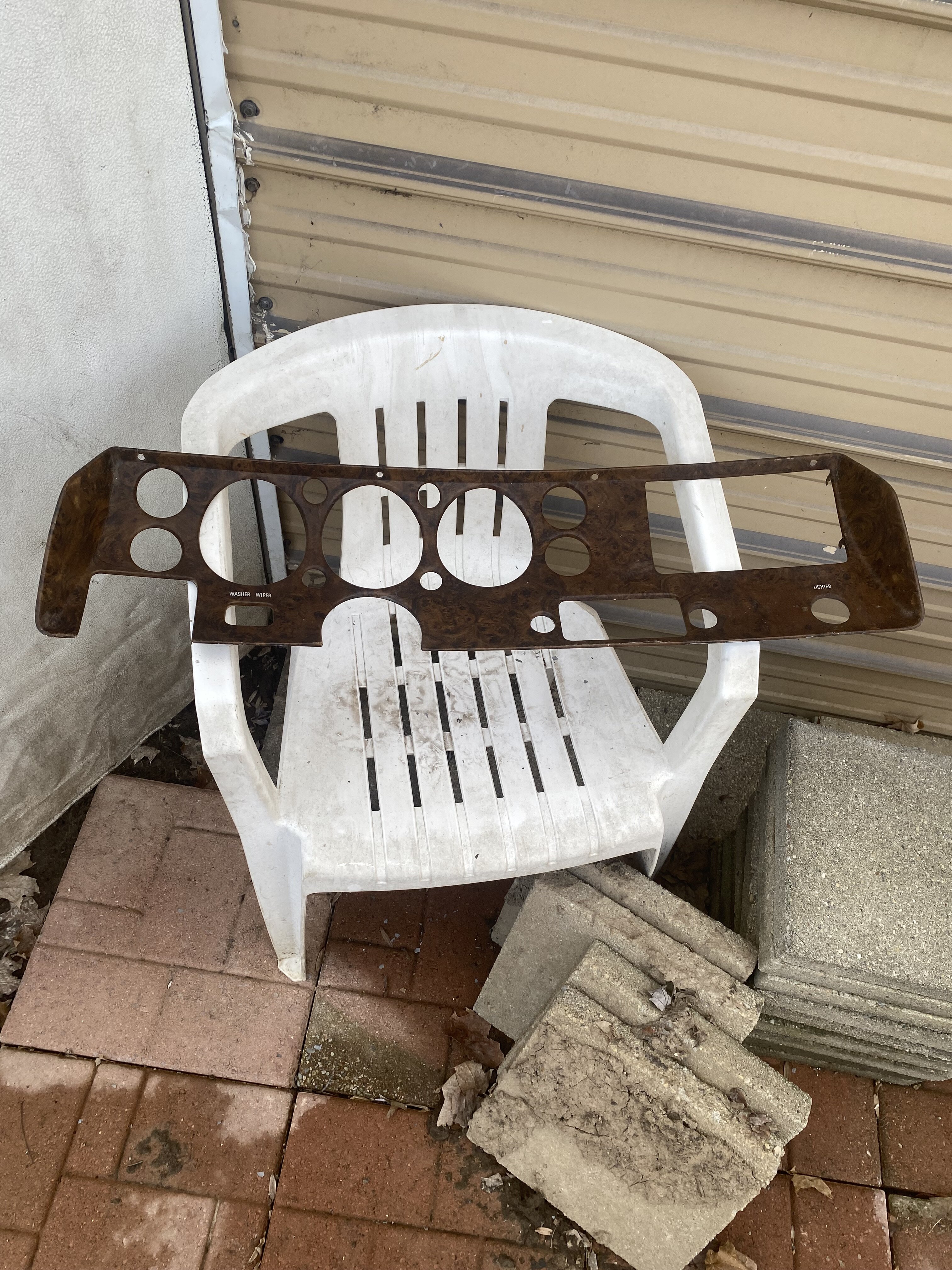

Anyone have info on the woodgrain dash bezel insert. I took mine out and want to get it redone. It was rusted pretty bad. I believe these inserts are hydro dipped decals. Also, once they are done how do I get the washer and headlight decals on it.  Where and who can I go to for this. I want it to look OE correct.

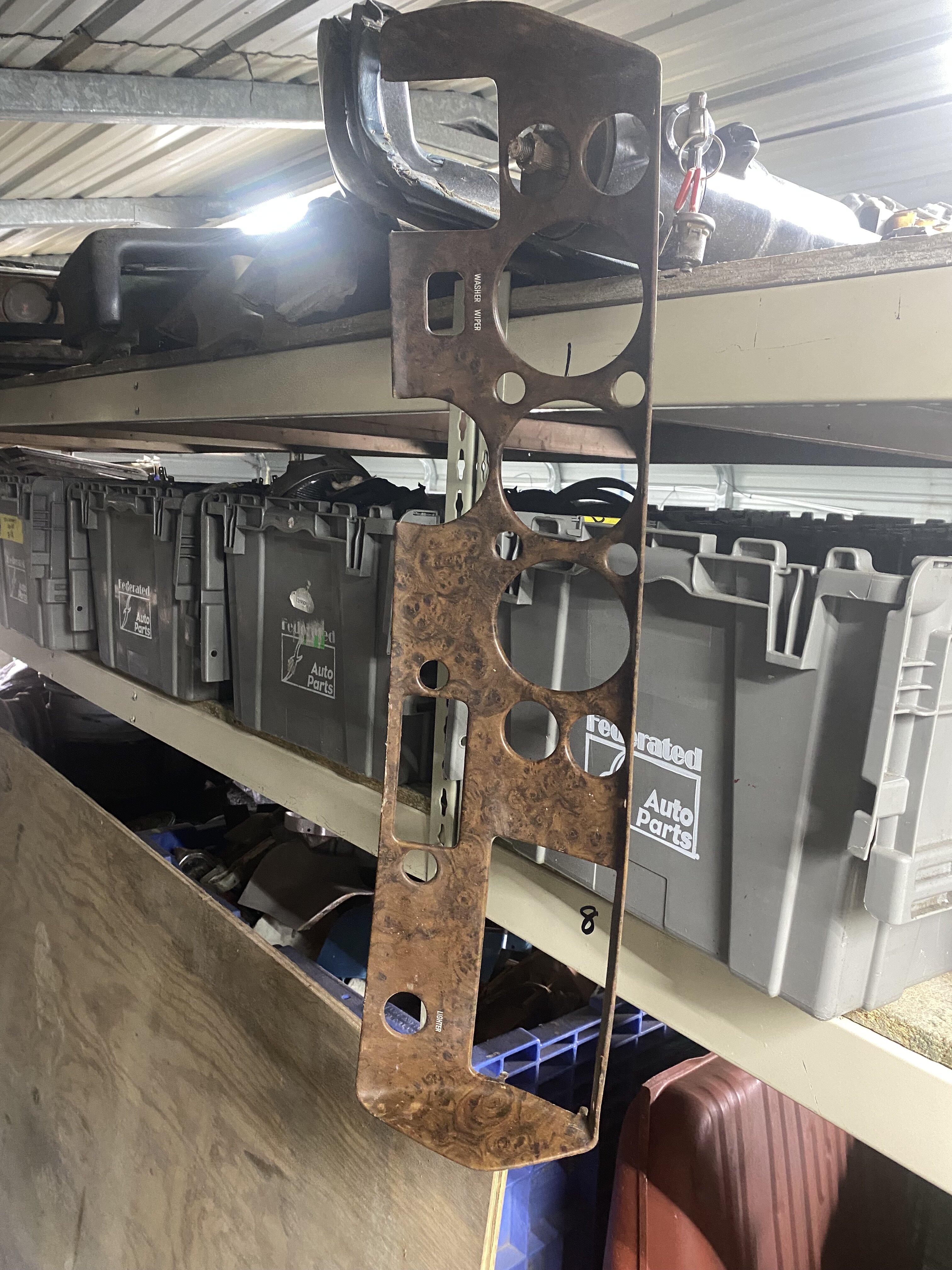

You’re too fast Willie. I was getting pictures. Ryan is this what you’re looking for?

I've seen the lettering done with a printer on adhesive cellophane...... I just can't remember the font style off hand.
They look O.K., but the edges will probably curl over time.
Dennis that dash looks good maybe Ryan can buy that one, i am sure you have a few????
7. But 3 are for 72. I also have several on dashes.
I wonder what it would cost to get a few stencils cut, it would be pretty easy for a sign shop but maybe a Cricut would be able to cut that small too?

I have also had good results with cleaning the burlwood (careful on the letters) and spraying with Eastwood satin clear. Makes them pop back to new. This one was pretty weathered before I restored it.
  • Like 9
Boy that came out nice. I’ve seen so many where that rich warm color is bleached out from the sun. Thanks for the info.

Sorry for the late response I have to get better at logging in and checking my messages.  I have so many projects going on and this car is a big one for sure. This is what I need for sure. I bought one and did not look close enough and it has a spot for a deicer is what I found that it is, and my car does not have that. The letters for the washer and lighter would be challenging. I bought hydro dip decal that I think might match but I will not know till it's done. If it comes out good then the next step would be letters which are probably hydro decals of some type also.
