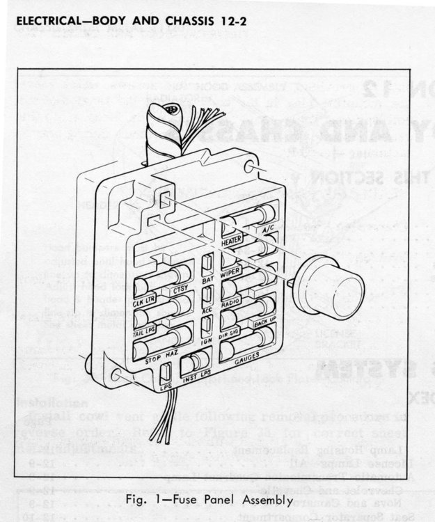

Just wondering if this is the correct description for the fuse box. I couldnt find it in my service manual and some of the letters are worn off on mine .

Not wanting to steal the thread, but is the fuse box on a 72 the same as a 70 ? I was looking for a diagram (like below) since most of my lettering has worn off and I couldn't find online or in the shop manual I have.

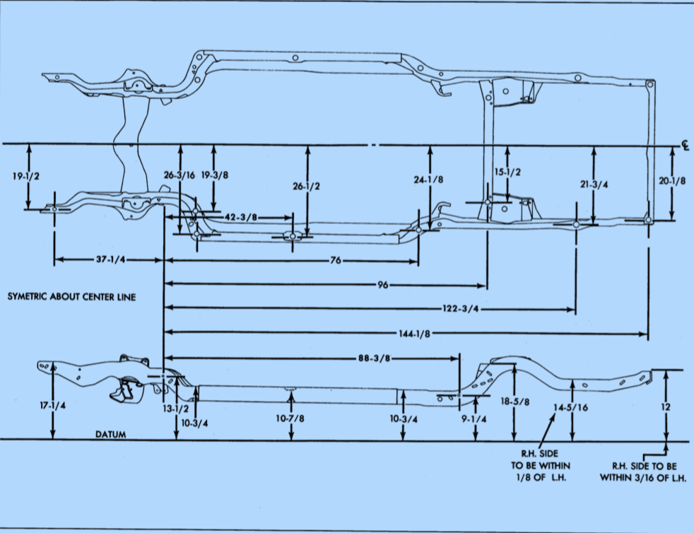

Ok so I was able to get under the car yesterday, just remember i'm working by myself so I had to put a socket on the body mount bolt, use an extension and tape the ruler to that. Then I had to tape them to the frame so there may be some + or - variables lol. The top measurements are from Tom's sheet the bottom are mine. Note 1 I couldn't do the one because the fuel tank is in the way so it would not be point to point. Note 2 on the rear I didn't see a body mount so I measured from the two holes about 6 inches from the back. Note 3 I wasn't sure on the engine x-member which hole to use. Note 4 the trans x-member 1st bolt forward of the center body mount is 4", and the spread between the x-member bolts center to center is 4 1/2". The weird thing is the center body mount on Tom's spec is 53" and mine is dead on to that.

Much more detailed than the shop manual one I was using !
Thanks, I'll work off that sheet. I just measured from the top in the engine compartment the forward point and its 39" so its a start in the right direction lol. It looks like i'm going to have to do the others from the bottom so I'll get on that.

Hey Joe, me take offense ? lol. No worries But no I taped the metal hook to the middle of the bolt holding the x-member. I was surprised at the number so I started with the forward bolt and remeasured the rearward bolt. Both 54 1/2". Maybe I have a station wagon frame ( body mount spec around 28") laughing. Very strange I'm that far off. Oh well going to need further investigation. And yea I've had many a laugh at myself working on cars. I'd rather someone point out whats obvious to them or slips from their experience. Thats why I joined this forum and ask a bunch of questions.
Ok, all I could find in my shop manuals from what i'm reading adds up to max 53" so 53 5/8" on the x-member would be to big.

Just an update in case someone comes across this thread in a search mode. Right now i'm not doing anything explanation below. I contacted G Force this am because everything I read said their holes were 53 5/8" inch's apart, and even their website description said to use a 1/2" drill bit on the existing holes to fit. I measured mine yesterday (center of bolt to center of bolt) and its 54 1/2". So with all that information in my question their reply was drilling the holes was NOT recommended but if I was any good at fab work (welding and such) they would send me a procedure. Well unlike Joe and others on the forum I have NO fab work skills lol. And no offense to anyone who's done this and offered their experience to me. Since its not "mission critical" for me to continue on my project I'll revisit it once i'm back on the road. I'm just not ready to drop $300 on a part that the manufacturer doesn't recommend doing modifications to make work. Thanks again to everyone
Thanks Tom, thats what I had read about the bolt holes having to be enlarged. I had considered upgrading the engine and trans mounts to poly so I have those in hand, and yes the trans poly mount has 3 holes. Now that you say the ground up X-member will work i'm going to have to make a decision (laughing) but i'm back to leaning towards the G Force at the moment. Summit has a similar piece but Its about the same price so I will probably go with the name brand. Appreciate everyones help and input.
