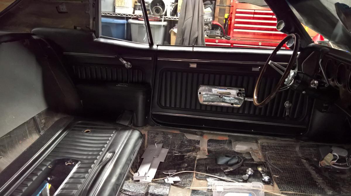

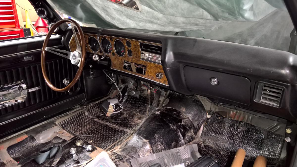

  6. Some more progress, all door panels on except the passenger front. Front markers and trim on and carpet/rear seat removed.

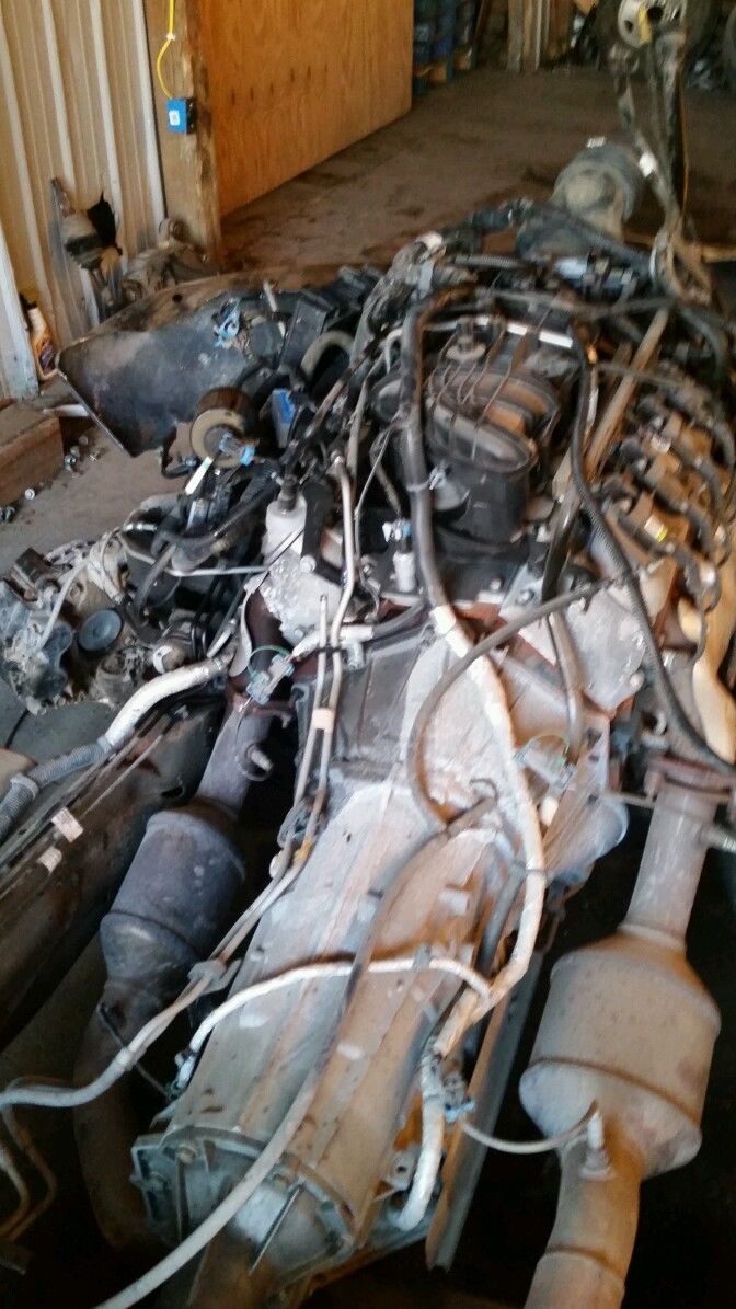

  7. ...and picked up my motor/ trans combo today. 2014 L96 and a 6L90E with 48k. Just got to make arrangements for shipment, merry Christmas to me

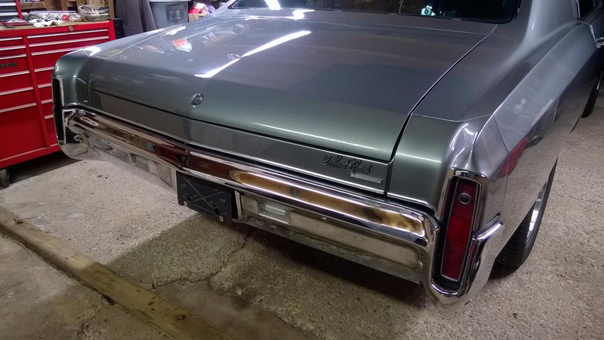

  10. Installed upper and lower side moldings over the weekend, now to do the tail and fender ones next. Hand polished each one so takes some time

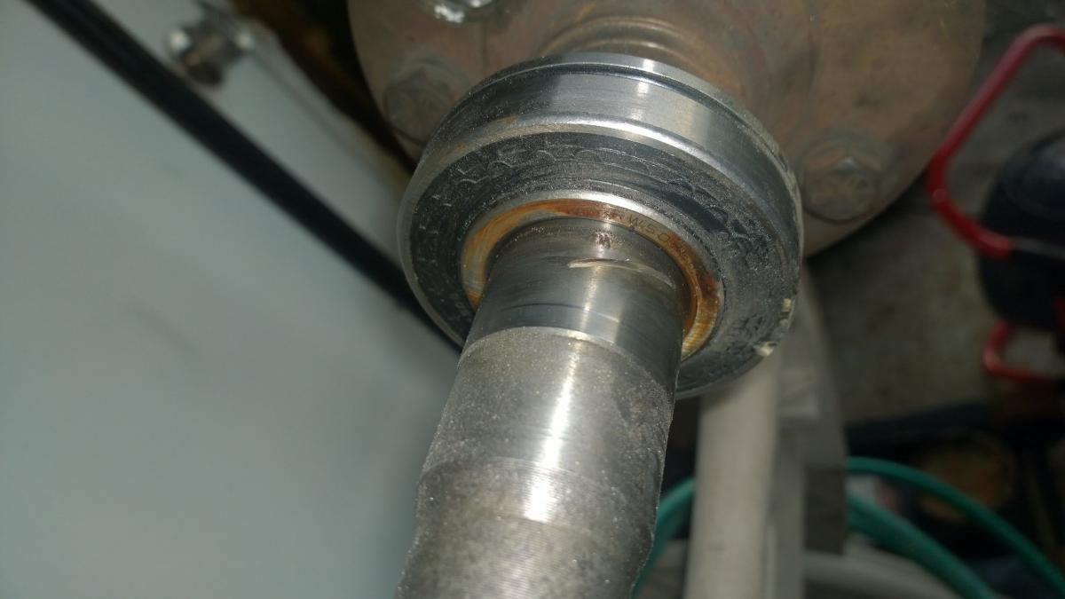

  19. Yea, I'm kind of torn on the idea of what to do. A rear end builder I know said I could still use it since the stress will mainly be at the bearing area to the flange. Plus the fact that the area cut is about 3/16" thicker then the rest of the shaft. Idk, really hate to spend more again
  20. Their isn't any seal their. The 9" rears use a sealed bearing and a lock ring behind the bearing area since their is no c-clips.
  21. Well I ran into a isue last night when removing the crash ring from the axles on my 9" rear end. I used the die grinder but I ended up slipping and cutting into one axle. What is rule of thumb when doing this? I attached a pic of how bad it is. I measured the depth and in the worse spot it's 2/32"...I hope it's not bad enough were I've got to change axles but by the looks of it I might be close to the boarder line
