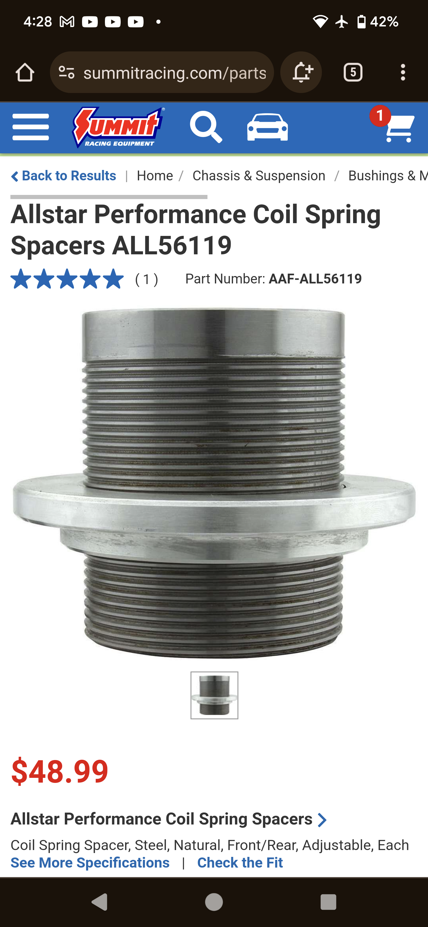

With no shock it sits crazy low. One issue I'm having is the spring-assisted shock (pic below) is too wide to slip up from the bottom. So I have to take everything apart to try any combo with that thing. Anyhow, I'm thinking in order to achieve the exact same height as the rear, I need adjustability. The red BMR springs came in a kit I bought a long time ago for a different project... I'm certain they aren't big block rated but my thinking is this big block weighs about the same as a stock small block. Any thoughts on these adjustable Coil spacers? -

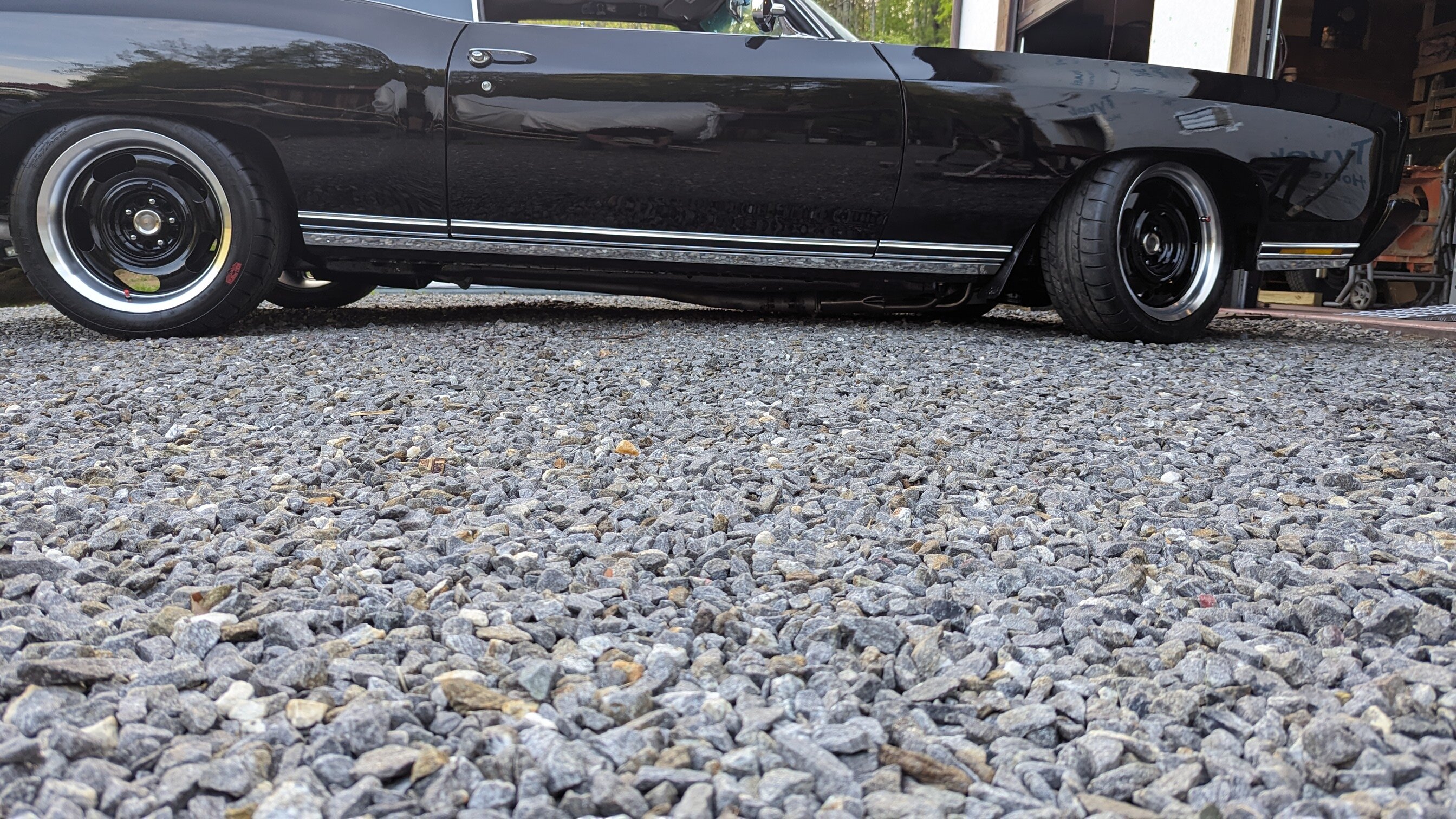

So I'm having a hard time believing this but wanted to see what you folks think. I installed the two inch drop spring + the new KYB shock. It dropped about 4" and was hideous (see photo). Then I tried installing the old spring assisted shock with the 2" lowering spring and now it's sitting higher than ever before (see second photo). What the heck am I forgetting here?? The previous setup had the spring assisted shock plus a coil that is several inches taller. So how can the car be higher now? I've bounced the car and it feels normal...but not settling. -
