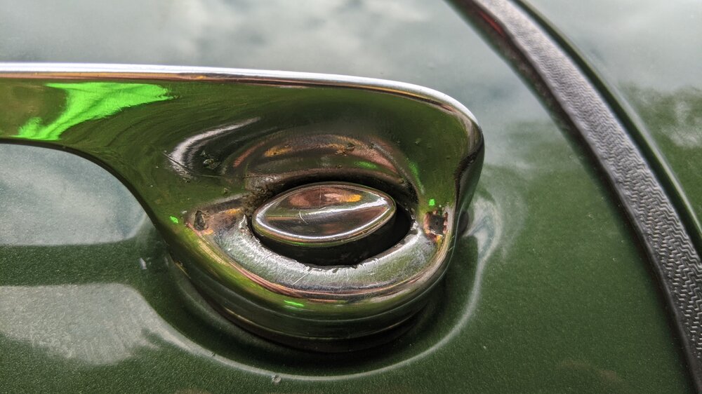

  4. Hi folks. My driver side door handle button is getting stuck pushed in...and not opening the door. If I pull up a few times on the interior handle it will pop the button back out. Anything I can do without pulling the door apart? Thanks you.

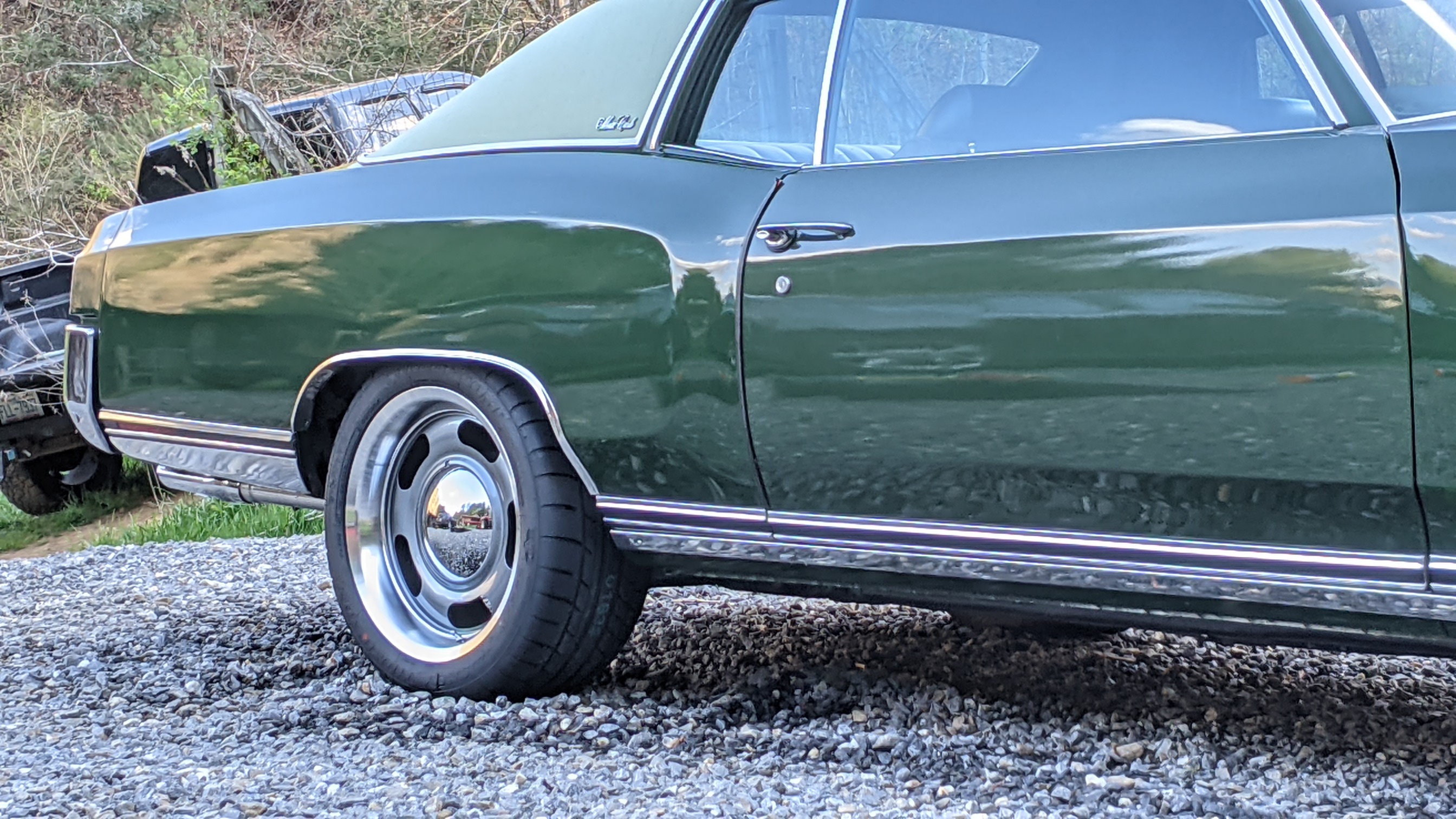

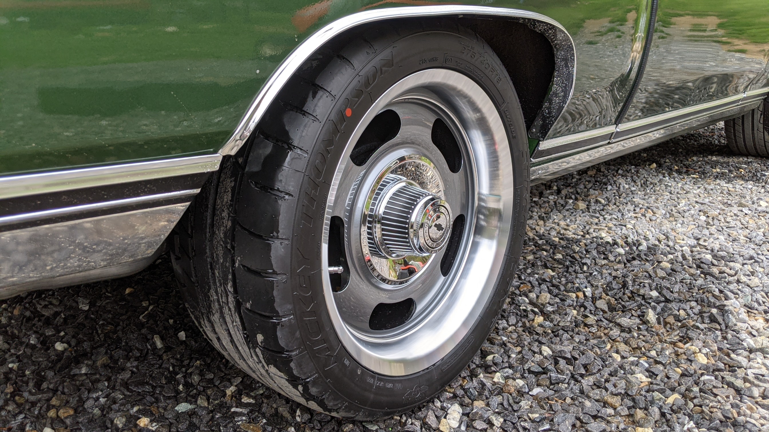

  10. I should have mentioned- the car starts with no problem. And Hyperspark is the distributor/coil/ignition.

  12. They do fit nice. I really didn't want 18's but just could not make 17's work with what's available out there. Hopefully I can get used to it sooner than later. I think derby center caps will give it a lot of that classic look back. They arrive today thankfully.
