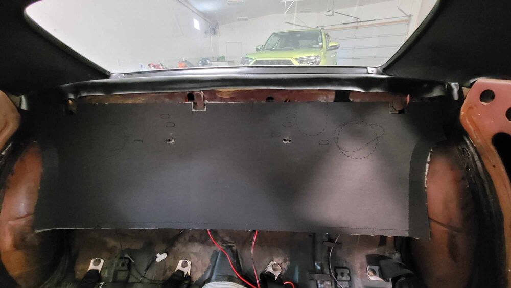

  2. So I put the cardboard card and jute insulation in behind the seat. I used spray adhesive 3m 77 to attach the jute. I attached the jute on the smooth side of the cardboard, such that the scored side was exposed. Installed so the cardboard goes against the seat back. The jute is between the cardboard and the steel trunk. Here are some photos. I have heard people put the jute on the seat side. I like the results from my approach. Note I used two of the oval scores to cut out and hang the board on the 2 steel clips that protruded into the back cabin from the trunk. Seems to be the right way to hang the board.

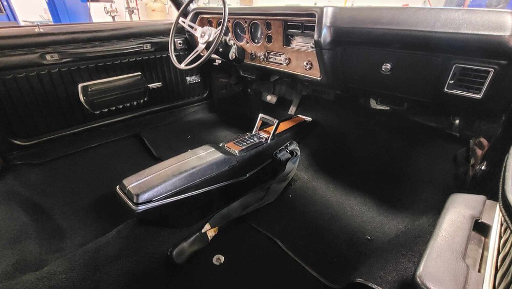

  3. Console in with new lamps. Got the seat belts mounted so they won't have a twist when buckled.

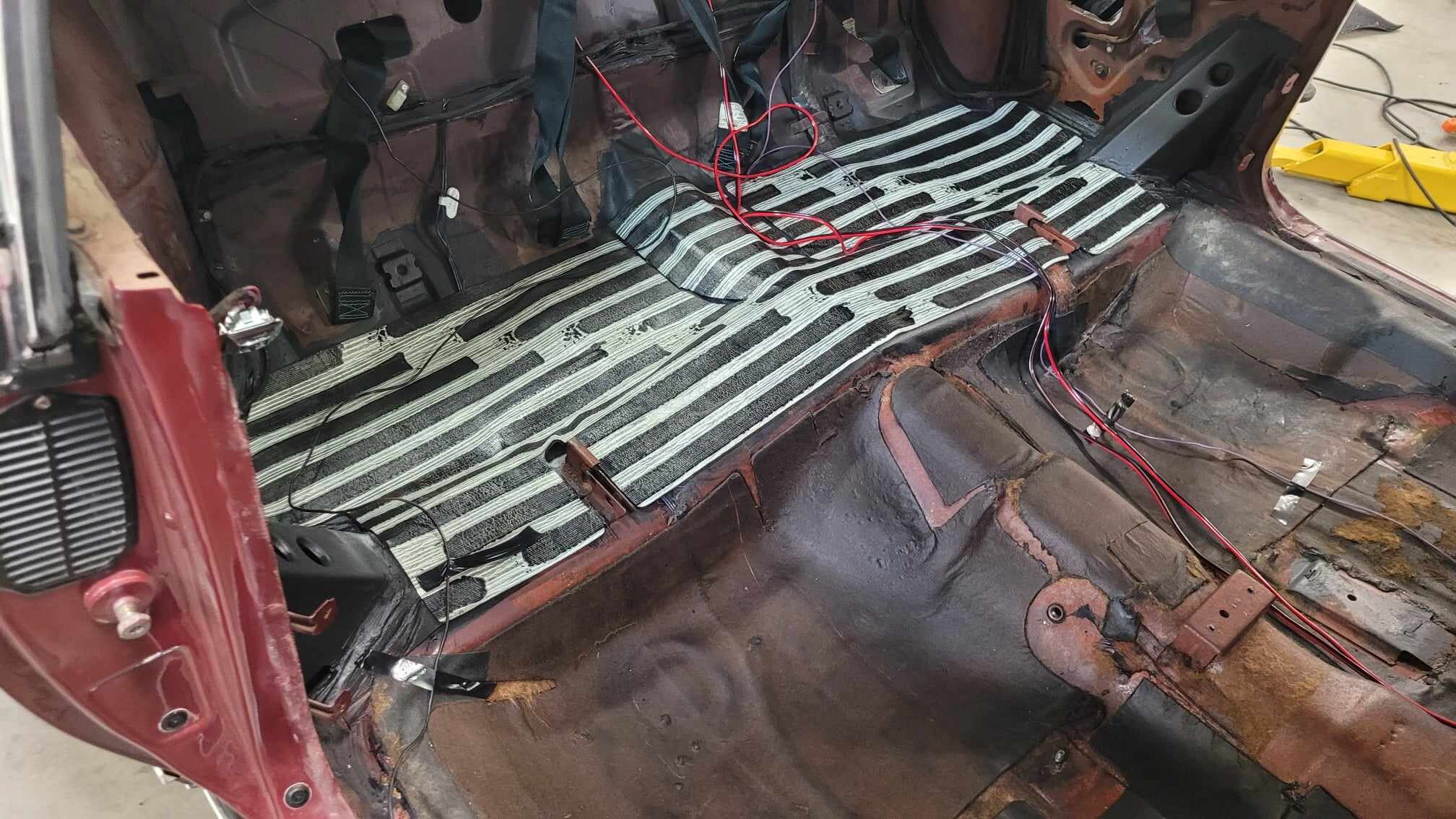

  6. Working on my interior. I bought retro pops sound deadening tar sheets. Only needed the piece for under the rear seat. The white side goes down per retropops. That is not clear in the instructions. The nee carpet is from ACC. I chide to add an extra jute layer which is thin but works perfect with the jute that is already on the ACC carpet. Not done yet but wanted to share some progress photos

  16. I'm a bit confused. Is the insulation supposed to go between the black board and the seat back. Or between the black board and the truck steel so you see it through the trunk holes. Please help
