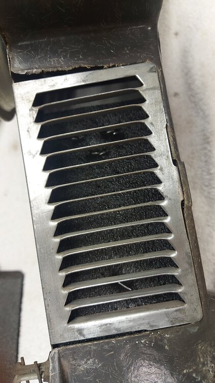

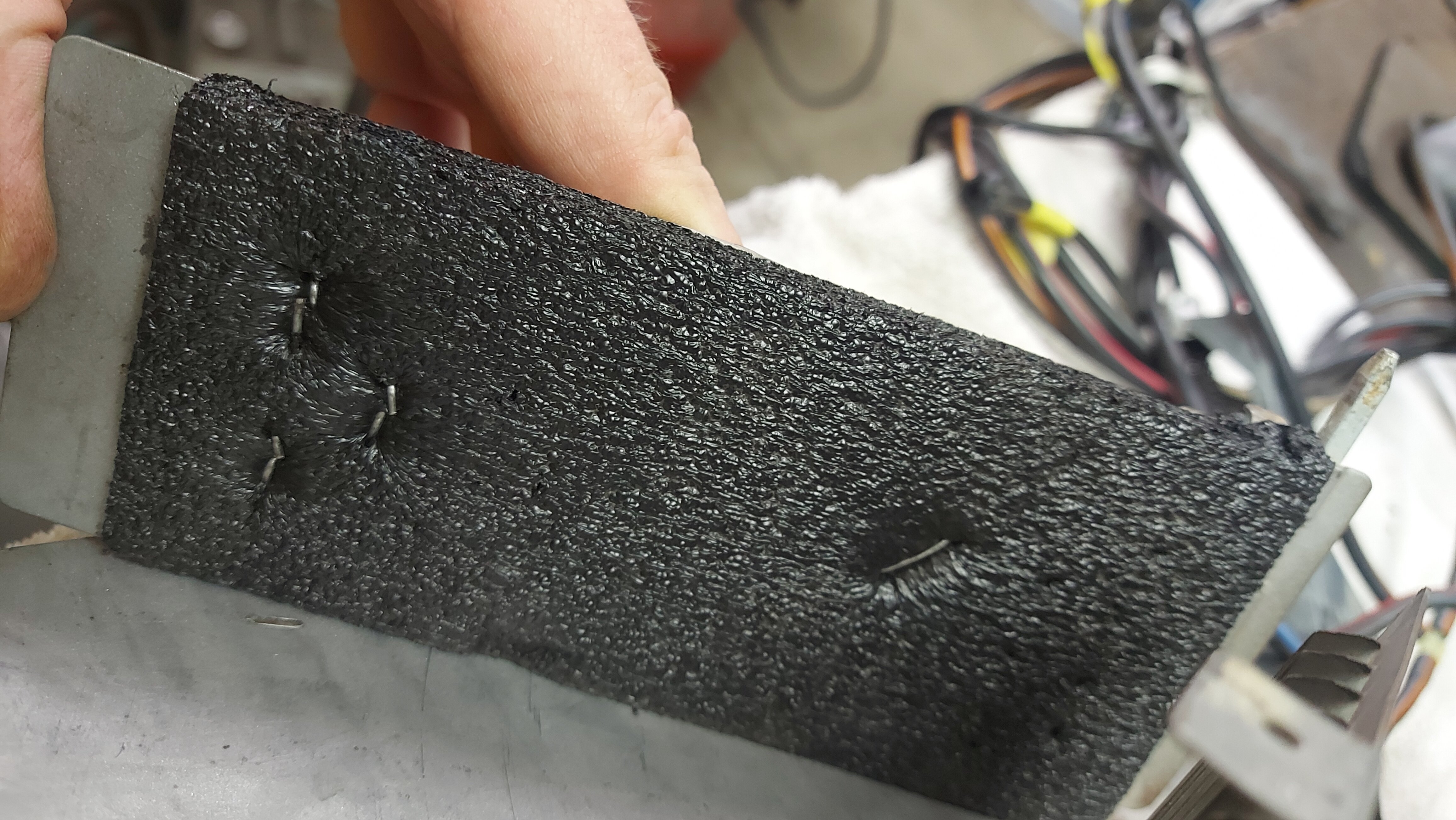

  5. I am in the process of refurbishing my heater box on the workbench. Parts are limited. The box appears to originally had open-cell foam on the defrost door as well as a strip on the blend door. None of the gasket kits I have found include the replacement form. I chose to take the gasket kit closed-cell cut out and use it on the defrost door. I just used the same staples that held the original. I took the evaporator and heater core to a local radiator ship. Both were flushed clean and pressure tested. Original brass heater core and A/C evaporator. I did find a lot of debre in the heater box so it was worth cleaning out. Good Luck! Brad
