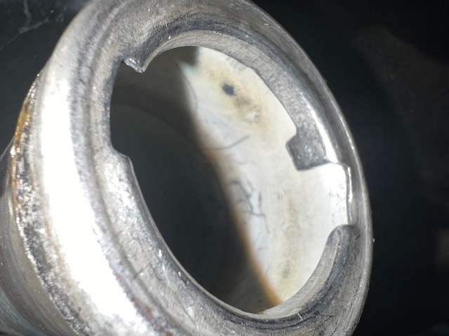

Don't think the car was ever hit in the back but I am guessing the filler neck isn't usually bent like this on the gas tanks? Im thinking this was why I bought a re-pop gas tank when i redid the car. The repop is spilling gas, the cap dosent seal. Im cleaning up the original one that was sitting in the shed. any one else with an original tank, is it funky like this ? Thanks
Upon further review I figured out the issue with the Gas cap and leaking gas cap. It looks like the issue is the re-pop gas tank I bought back in 2012. Been using it this entire time since car has been back on the road in 2015. I didn't catch it when Bruce was kind enough to upload his pictures. I had my original tank out in the shed. You can see the difference in the Lip. The re-pop tank has a lip that is much thinner in most of the area and only gets snug in one very small area. The gas caps fit great on the original filler. So now dilemma is do I get another tank or have my old one redone... ...................................................... Gas Tank : DII corvex T31 CV 07-TK04 70-72 W/O O E.E.C.
