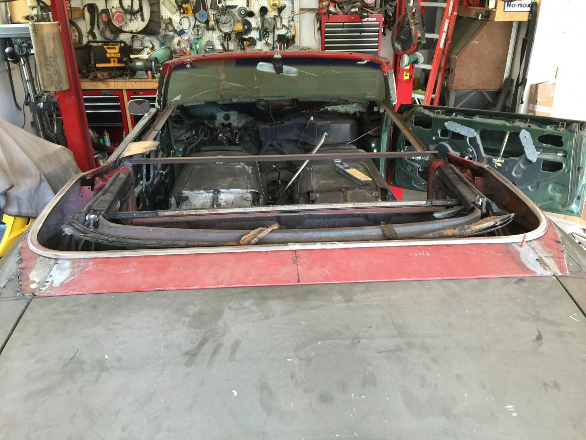

Spent some time on the car today tacking in the top of the driver side Q-panel. Also dry fit the tub perimeter stainless trim pieces. It fits really good all the way around. Now it's time to finish weld the Q-panel tops and tear it down for final welding. Ugh got tear it down again for the millionth time and hopefully the last. -

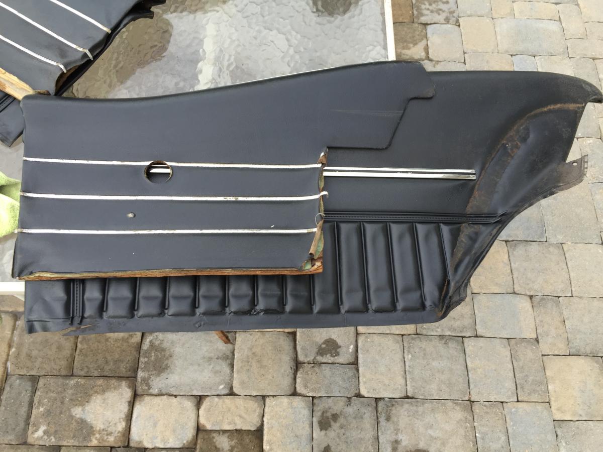

Time to get the interior panels out to make sure things are lining up. I'm going to splice the Monte sail panels with the 68 chevelle convertible ones. -
One is left and one is right. Can't mix them up that way.
I got the nos set at a national Monte Carlo club annual car show back in '93. There was a vender that had them for $25 a side. I didn't have much cash on me so I only bought one set. Here is another shot for measurements. It's from the bottom so you can determine the side.

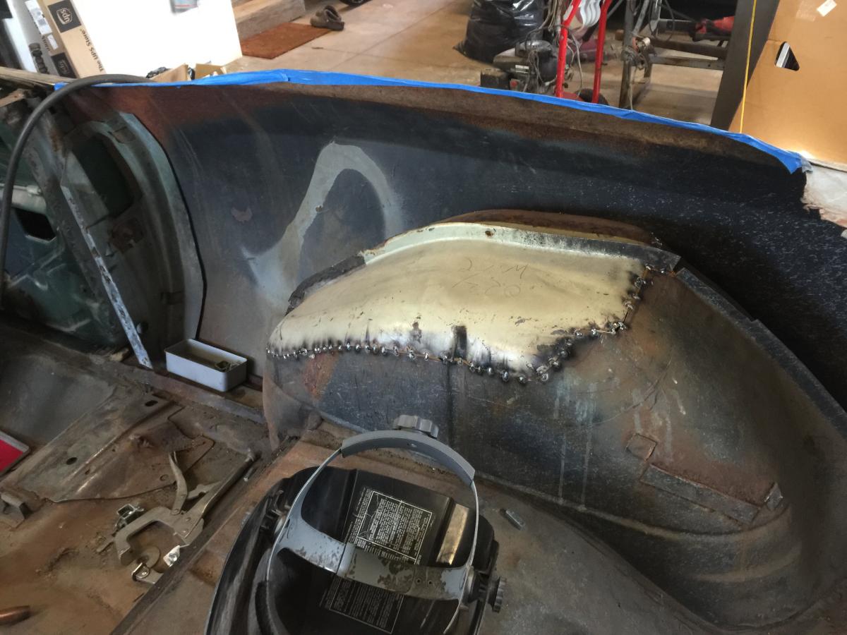

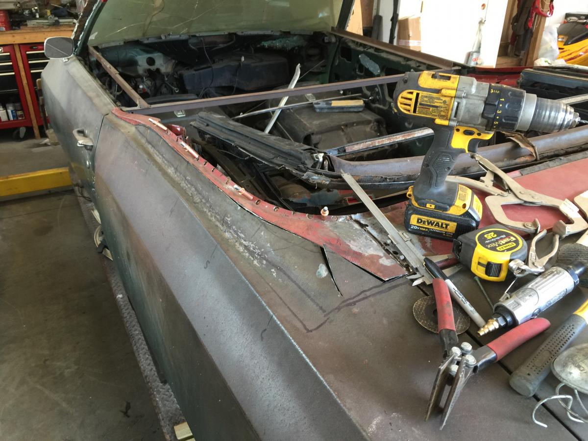

Starting to blend in the Q-panel tops. My objective was to keep as much as the original monte metal as possible and minimize the amount of weld seam. -

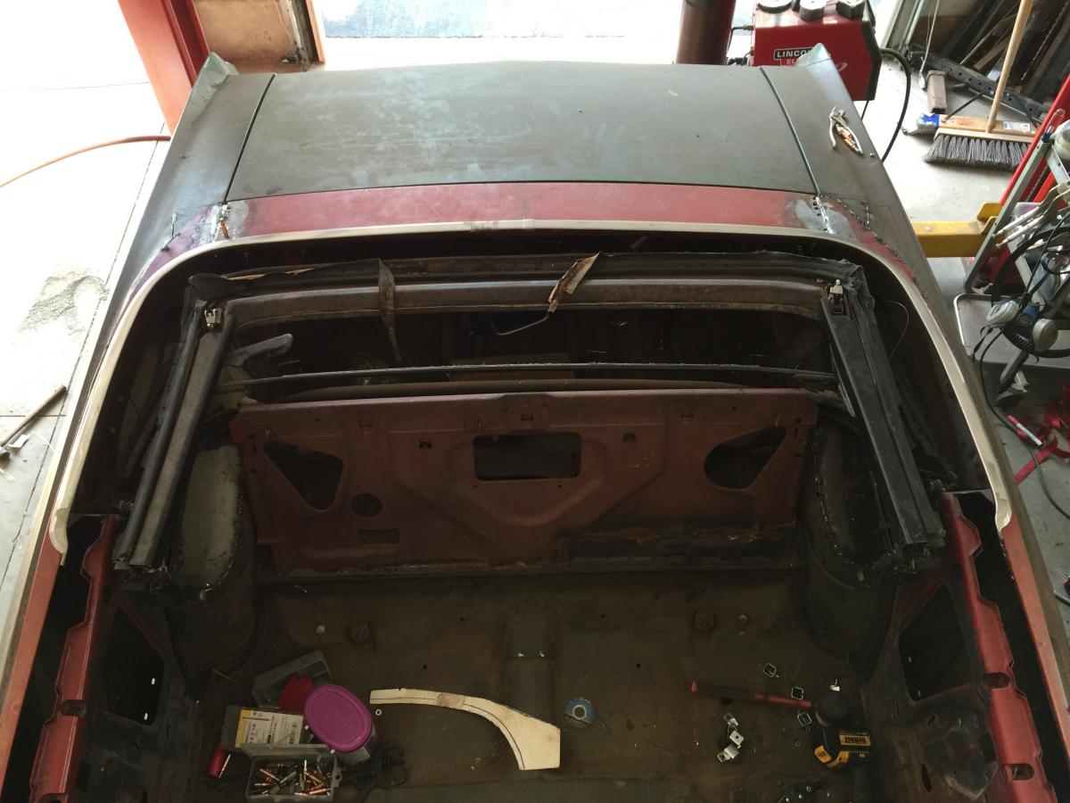

I've been trying to wrap-up the metal work on the convertible. Made some good progress on it lately. Had a helper too. -
