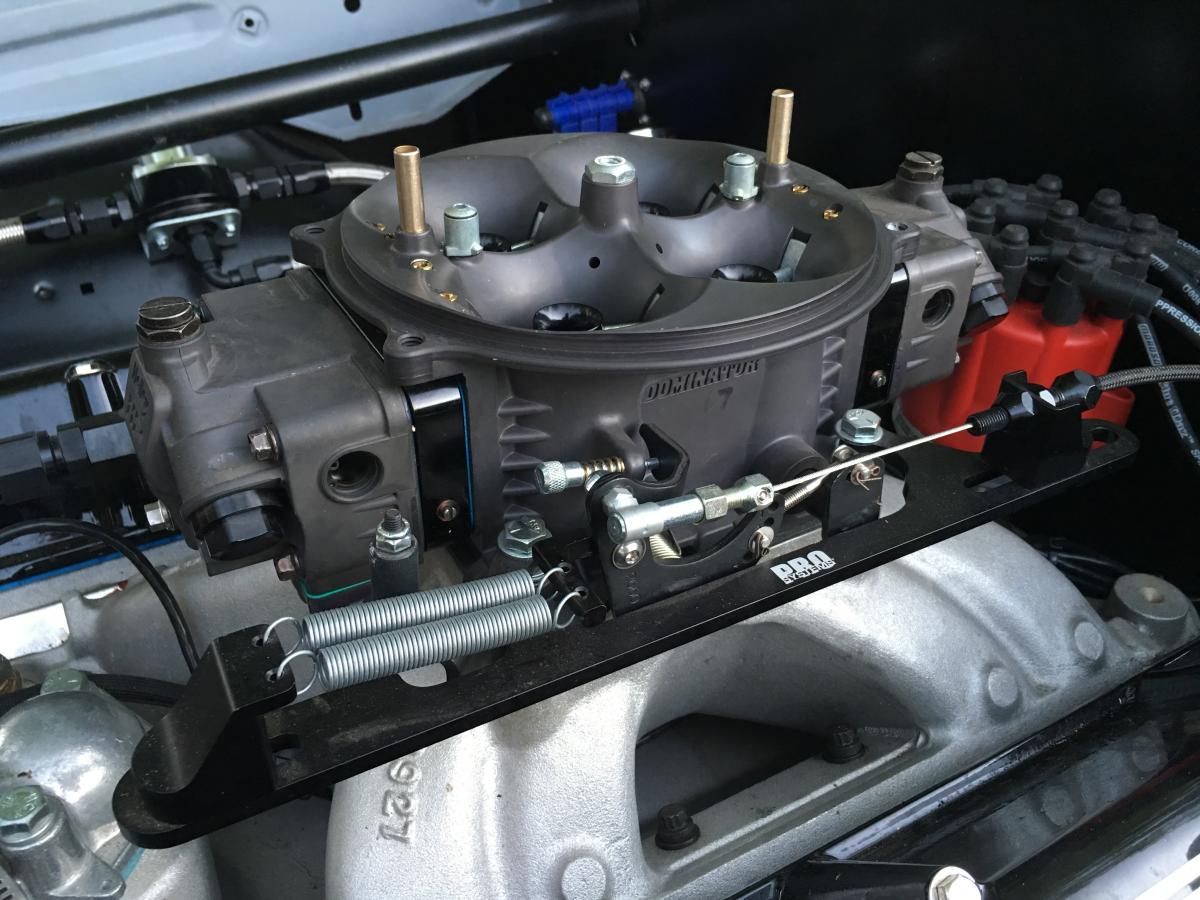

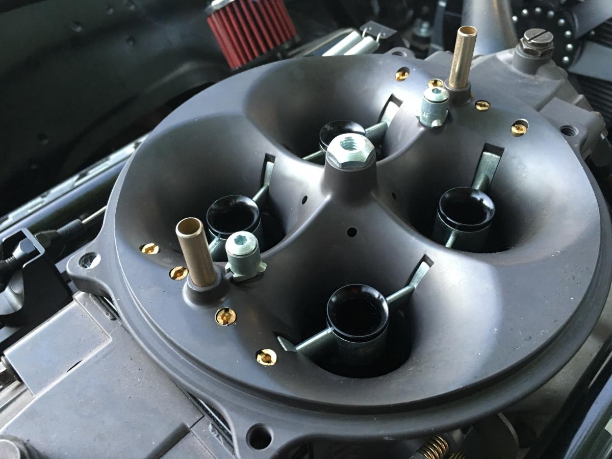

It's finally warm enough to drive the car, so I'm going to continue to get this carburetor dialed in better. It's much closer than it was out of the box, but its still rich at part throttle cruise and WOT. I'm getting around 11:1 on the highway cruising around 5% throttle, and around 12:1 when I floor it. I'm thinking to drop a couple jet sizes on the mains on both the front and rear blocks, then see where its at. As I started leaning the fuel curve out, I noticed a new problem. With the RPM that this engine turns at higher cruising speeds, the water temp starts to creep up higher into the 210's- 220's until I slow down and turn the electric fans on. I may need to install a larger radiator to keep things cooled off. Overall the car runs well. It's not blowing black smoke everywhere and throttle response is good, but I know there's more in it.

Got that meter hooked up today and its working nicely. At my current settings it was reading about 13.5:1 at idle. I tried leaning it out some more to around 15:1, but it didn't like that adjustment. Every time when coming to a stop the engine would go way lean and stall. Almost like the floats are too low or something. I put the mixture screws back to where they were and it runs fine. It shows 11-12:1 at WOT, and 13:1 part-throttle while cruising along. The sensor may not be accurate at idle. I put it in the side of the collector then found out after I read the instructions it tells you not to put it there. It should have been in a single exhaust tube. Not sure how much it will affect it.

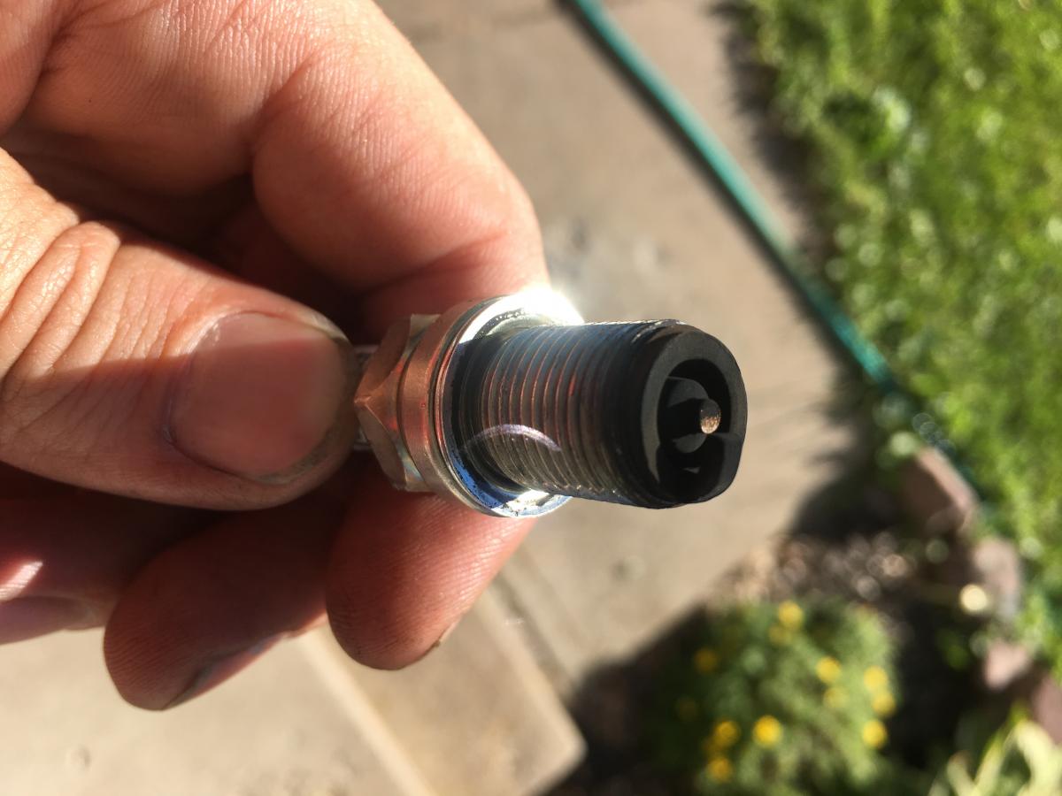

I think I'm getting much closer. I found out the misfire was due to a spark plug wire melted to the headers. Also found out the idle air bleeds were .057" not .070" like I thought. I changed those to .067". Idle mixture screws now like to be at 1 1/2 turns out. It runs great now and it's more responsive than before. I had to go up a heat range in plugs because the auto parts store was out of the plugs I needed. Went from an Autolite Racing AR3932 to AR3933. The plug in the picture has about 20 minutes of run time with some cruising and one good pull through the gears. It looks a lot cleaner than before. Like GermanMonte said, I may have to hook up my A/F meter to see where it's running before going any further.
I drove it around some more and it seems a little closer but still rich. The idle cleaned up quite a bit, but its still misfiring at cruising speeds. The plugs are still black but not wet anymore, I'll try going up in heat range on the plugs and start fooling with the air bleeds after I see what they look like. This is what the plugs looked like after I adjusted the throttle blades.
Got a little more seat time today, drove it to work. It ran like poo. It's loading up at part throttle cruising and idle and starts to misfire. When I got home I played some more with the idle mixture screws and the more I turned them in, the higher the idle went. It got so high that I had backed completely off the curb idle adjustment and it was still way high. At this point I thought there was a vacuum leak or something else funny going on. Apparently there is an adjustment screw on the passenger side of the carb for the secondary butterflies. It was screwed way in causing it to pull a ton of fuel off the secondaries at idle. After I corrected this adjustment, the idle smoothed out and the black smoke went away. I'll have to take it for a spin and see how it runs now. I cleaned off a plug just to see where its at until I get a new set.

Thanks for the advice, Sam. I tried playing with the idle mixture screws when I adjusted the floats and it didn't respond much to anything I did. I believe they are all at 3/4 turn out now. I wish I knew the size of the idle air bleeds, I haven't taken them out yet. Figured I would take the whole carb off so I didn't drop the jet down the manifold like an idiot. I think they are .070" but I don't know for sure. Here's some pictures of the carb and what the plugs looked like.
