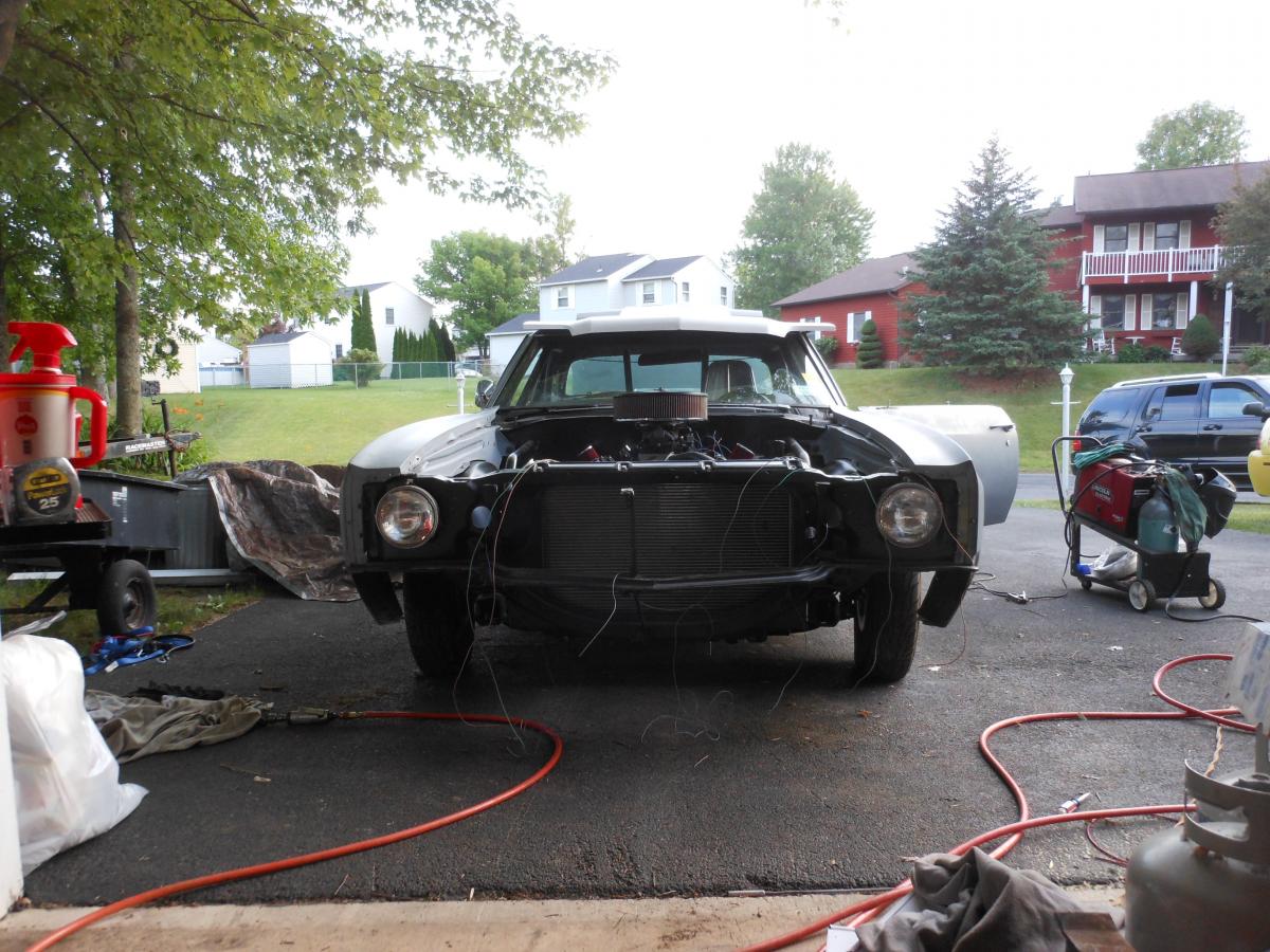

I think I might see a little light coming from the end of the tunnel. You can actually tell it's a Monte Carlo now! It's not done yet but its getting closer... Right now I'm in the process of rewiring everything in the car. Most of it is already done, I had wired in the essentials last fall to fire the engine, but I pulled it all back out to get the cage welded. I didn't want the wires to get all burned up and ruin a brand new harness. I'm also chopping up my factory dash to re-use. I had to cut some pieces out to get it to fit around the bars, mostly just notching stuff to make room. My dad is helping me fit up a new Racepak digital display. We just cut the plastic out from between the original gauges and made a bracket that attaches to the mounting points that were used for the stock cluster. We made a template from construction paper that will be cut out in aluminum to finish the face of the dash. I found a different rack and pinion setup thats manual and the input shaft is at a different angle so it looks like it might work. I talked to the tech on the phone and he said it will fit, so I'm gonna give the r&p another try. Here's some more pics

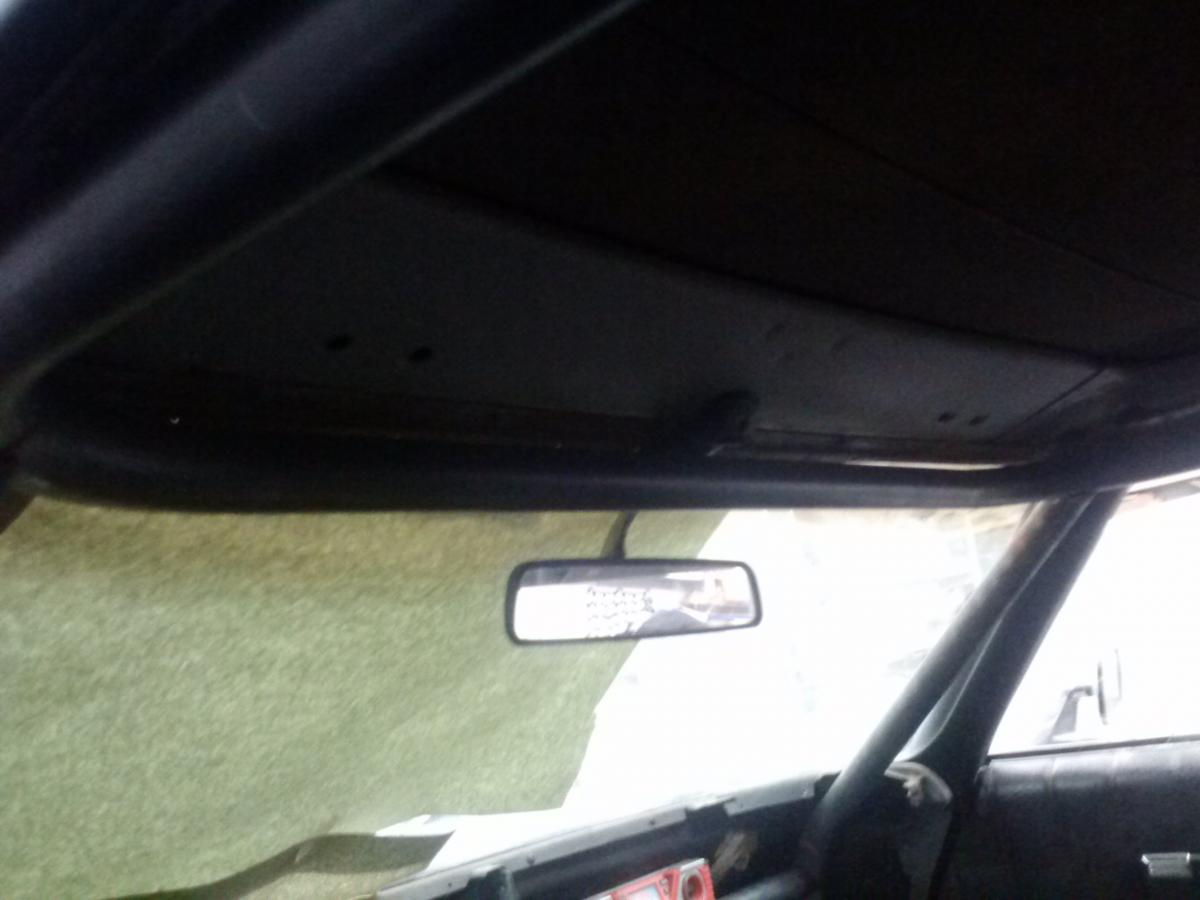

Here it is, all caged up! It's a 12 point cage with chromoly steel tubing and will be certified to 8.50 at NHRA tracks. I still have to paint it and make some seat mounts to get the seats bolted in. There's loads of other work to do before I will be able to drive it. I will keep updating as I go. You're right Steve, the race is on! Would love to have it there.

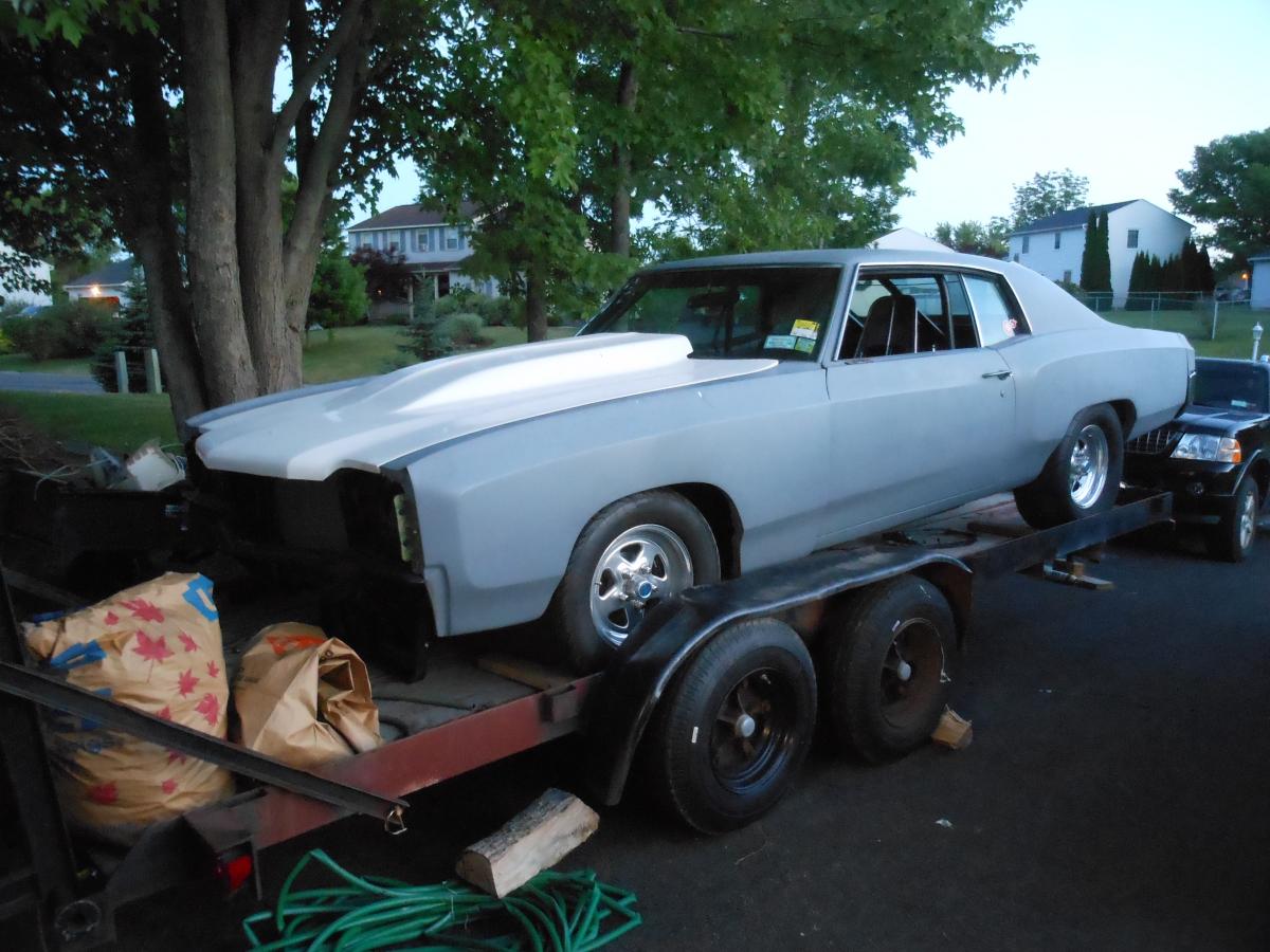

Ok, well it took a little longer than expected, (doesn't everything?) but the roll cage is done. I am without a trailer at the moment so the car is stuck at the shop. Once I get it back, the mad rush is on to get it completed. I'm changing a couple things on the car, the rack and pinion is coming back out. I couldn't get the steering shaft to work properly with headers in the way. It was a cool idea and with enough effort I'm sure would work but I don't have time to mess with it right now. A manual box will be used instead. The hydroboost is also coming out. I wont have to mess around with any power steering lines or pump that way. No pictures of the cage completed yet, but I have some of the main hoop and halo bar being fit up. More to come once I get it back.
