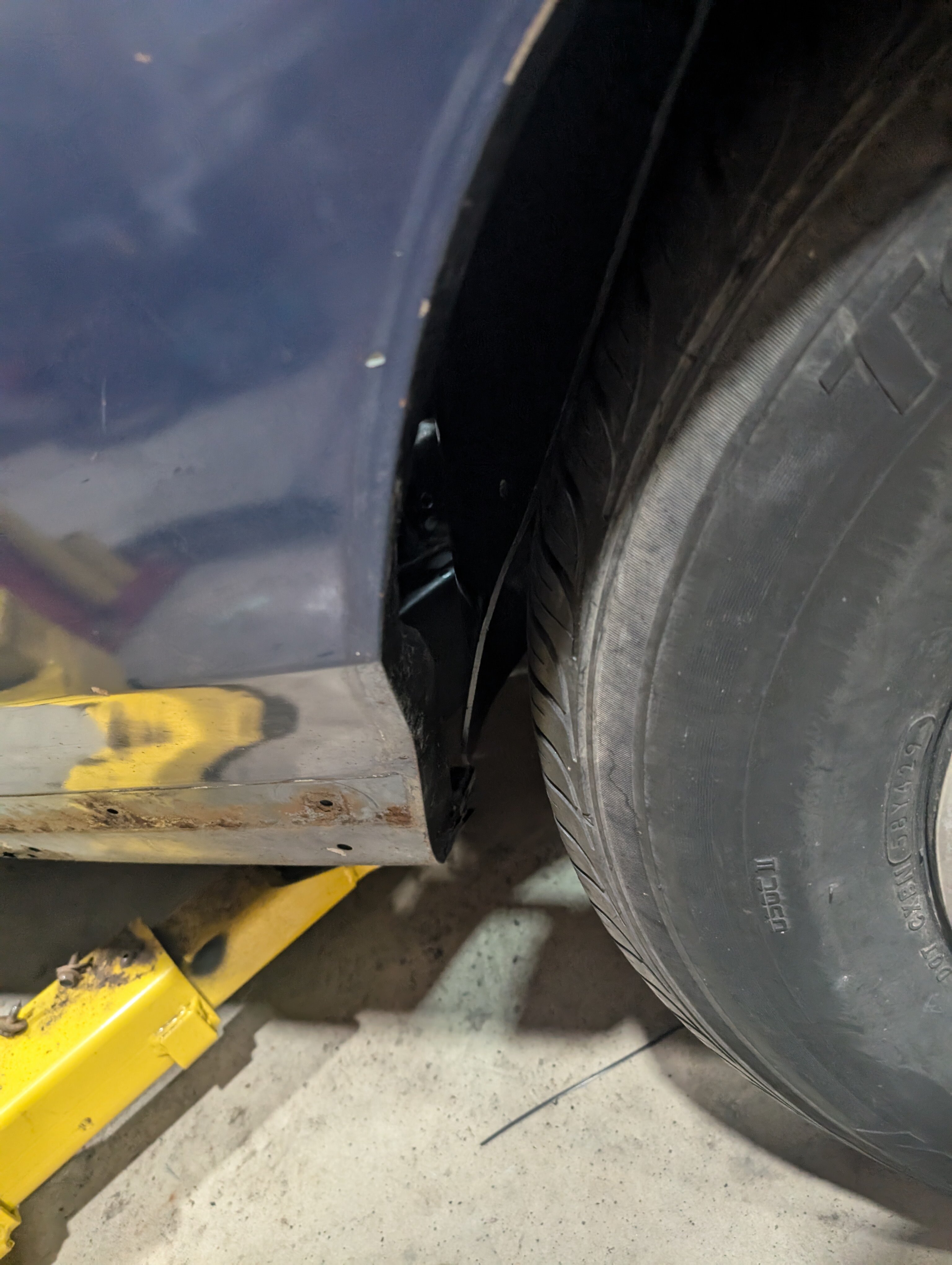

Hey guys I am having an issue with the passenger side fender at the bottom. How would I get this gap fixed? I shimmed the core support and the driver side seems good, does this side just need an extra shim?

Take a look at this pic of the passenger side fender and inner fender. How in the heck am I so far off here. The drivers side isn't this bad . Any ideas or place to start?

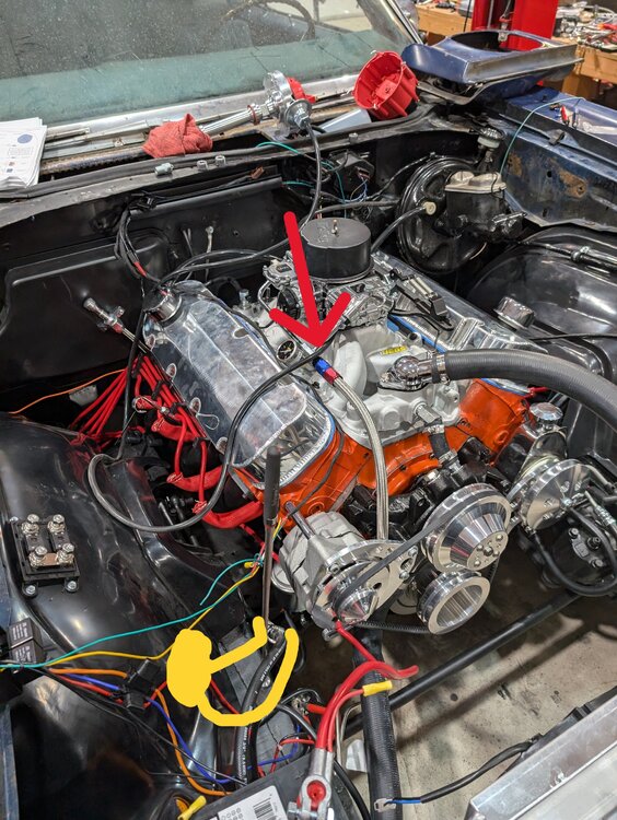

Hi All, For initial fire first run break in how do you establish TDC with the valve covers on. TDC is when the 1 cylinder exhaust valve has just begun to open. Is that correct? Also are there any sources you know of or have used that is a good checklist to run through before first run? I found a procedure on an old Chevelle forum that seemed pretty good but I always want more info and tips. The fuel questions I have is in this crudely marked up photo. Right at the red arrow there could be a stainless fuel filter that I got from summit that either came with the Holley fuel rail and gauge or I bought it at the same time I can't remember, either way I am wondering if it is necessary, as you can see I opted not because it sticks way out and looks goofy plus I have a decent quality clear one right where the supply hard line meets the rubber. I didn't get it in this pic but it's there. Do I need two? Would it hurt having two? I thought it could potentially just because of fuel restriction but idk. I am not that experienced and as I said I scraped because of mostly vanity and convenience. Now 2nd and perhaps dumb question lol. I planed or thought about installing a little electric fuel pump in the approximate location where that yellow blob bug looking thing on my pic would go. Pipe it in series with with the mechanical for backup in case of failure and wire it to a simple switch, also installing it would allow me to prime the fuel system as in pressurize ahead of starting to check for leaks and ensure quick fuel delivery on start. Is this a good idea, bad idea, unnecessary?? What about just using the electric to prime it up to the mechanical and not install it. I initially bought it to use it as just a convenient pump to use around the shop when needed but then thought of this. Thanks!

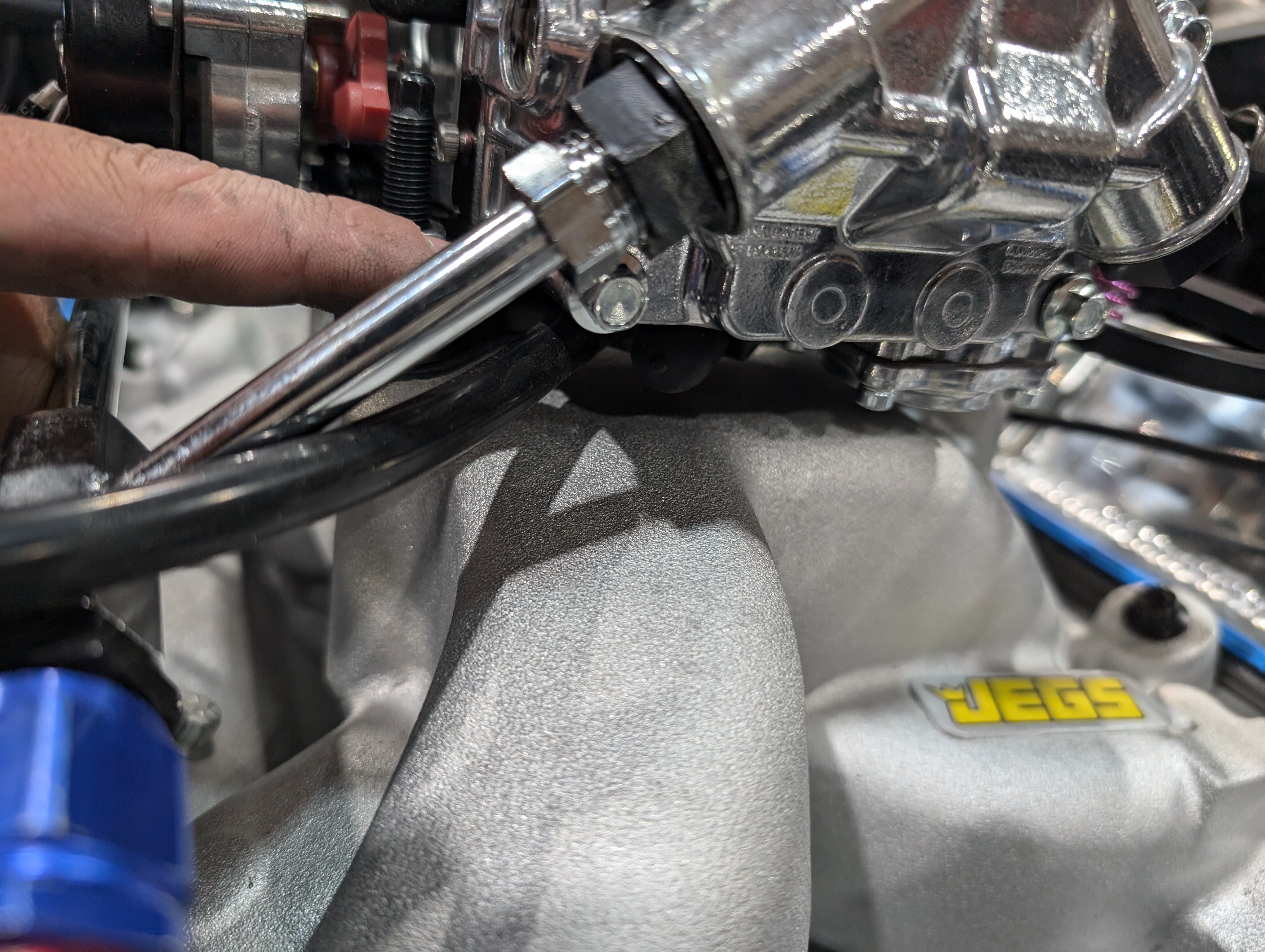

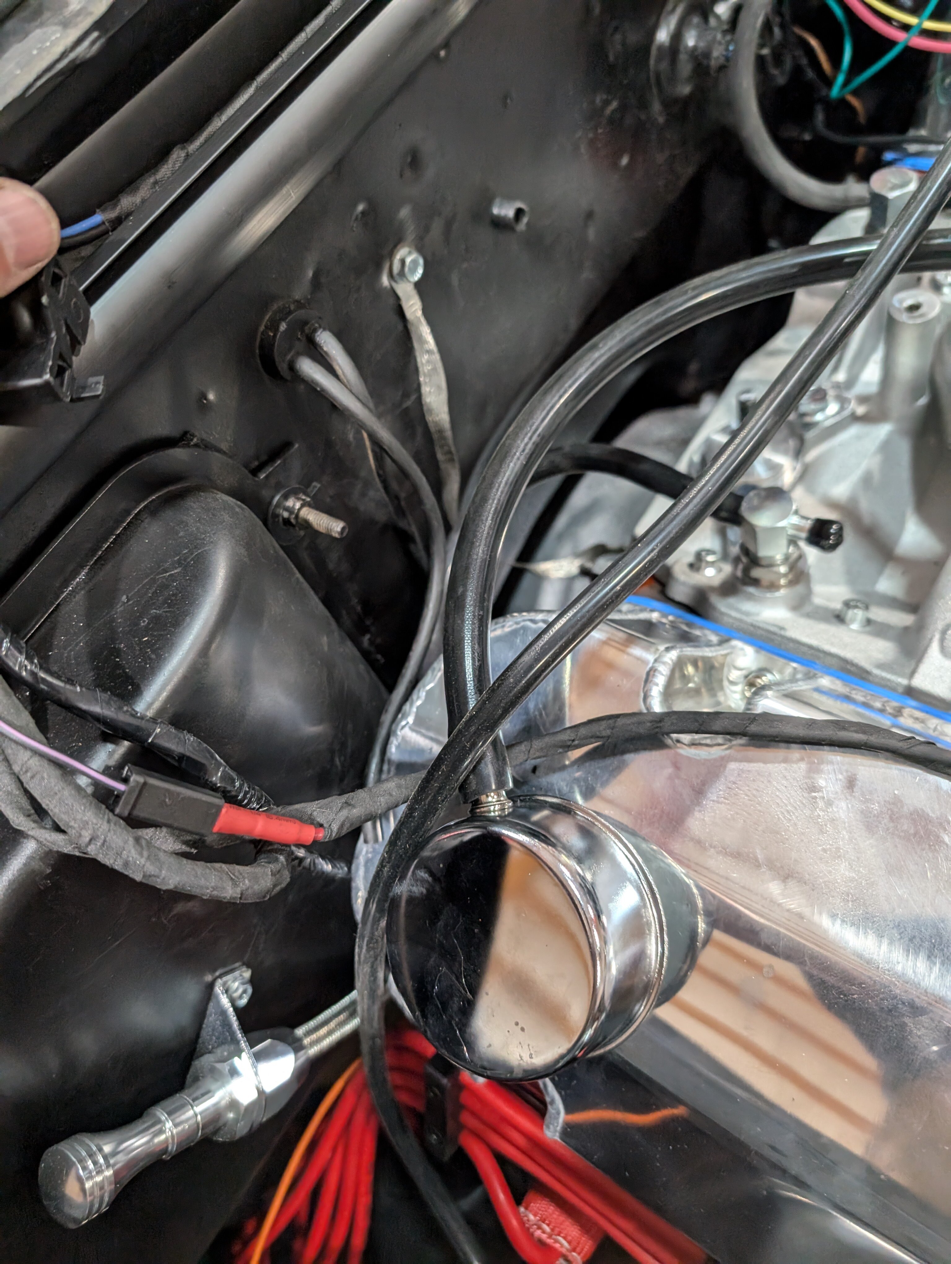

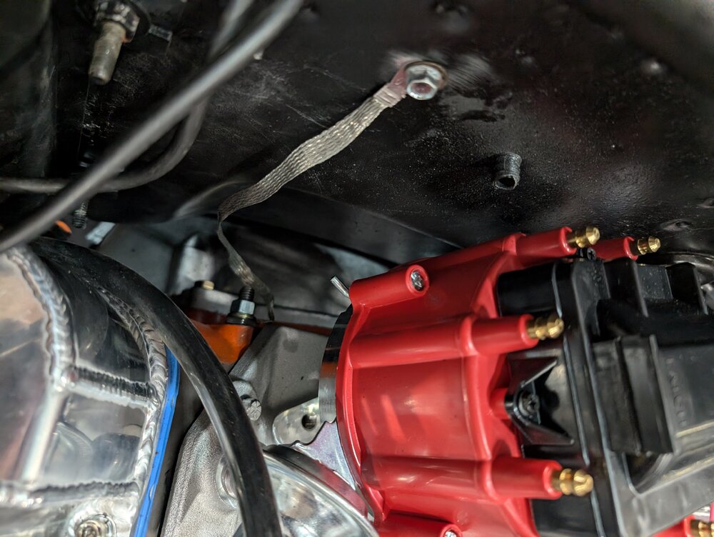

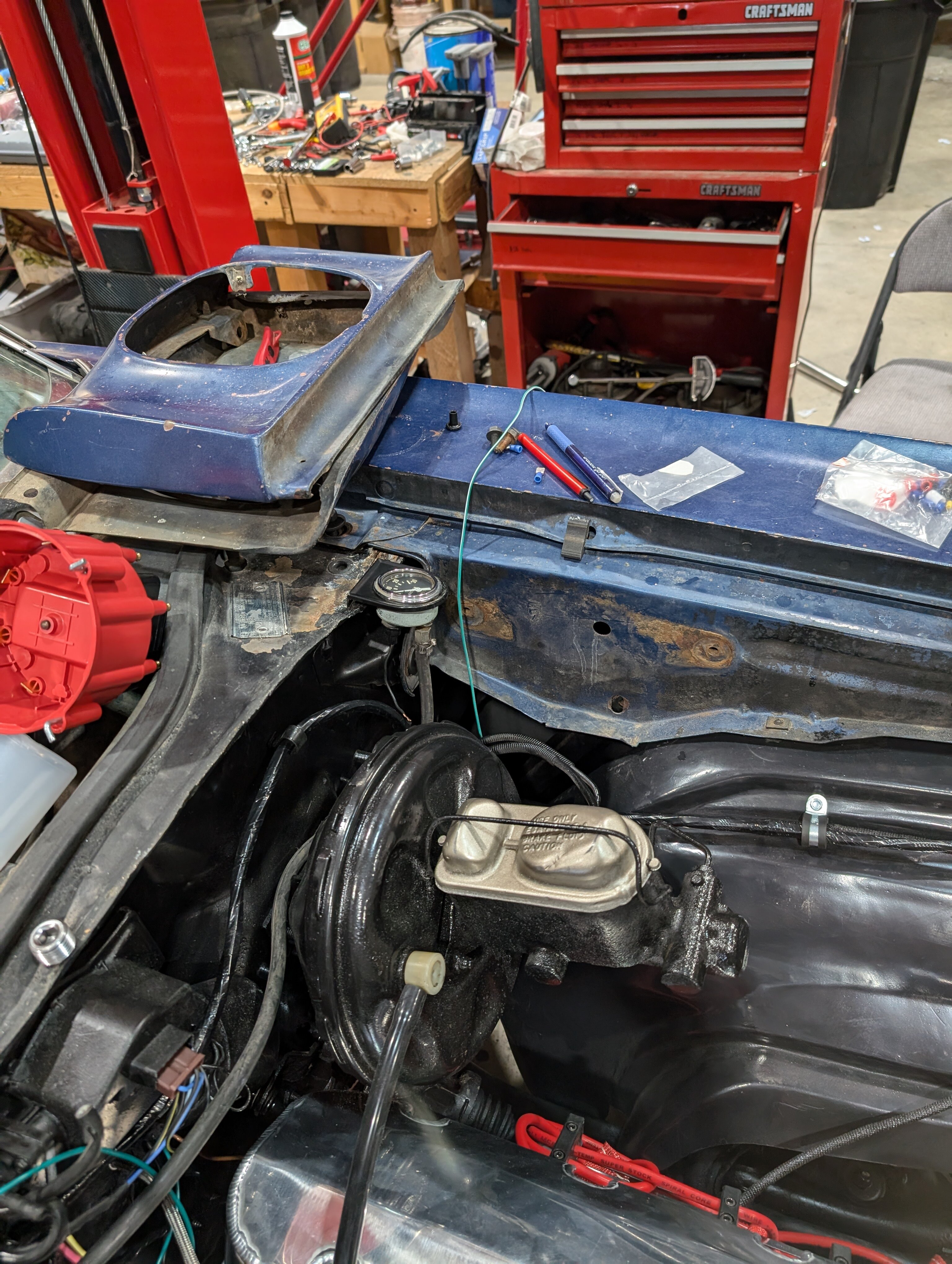

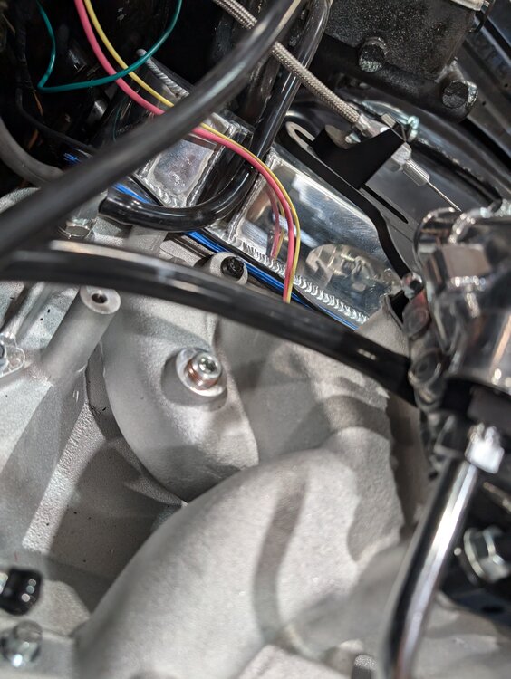

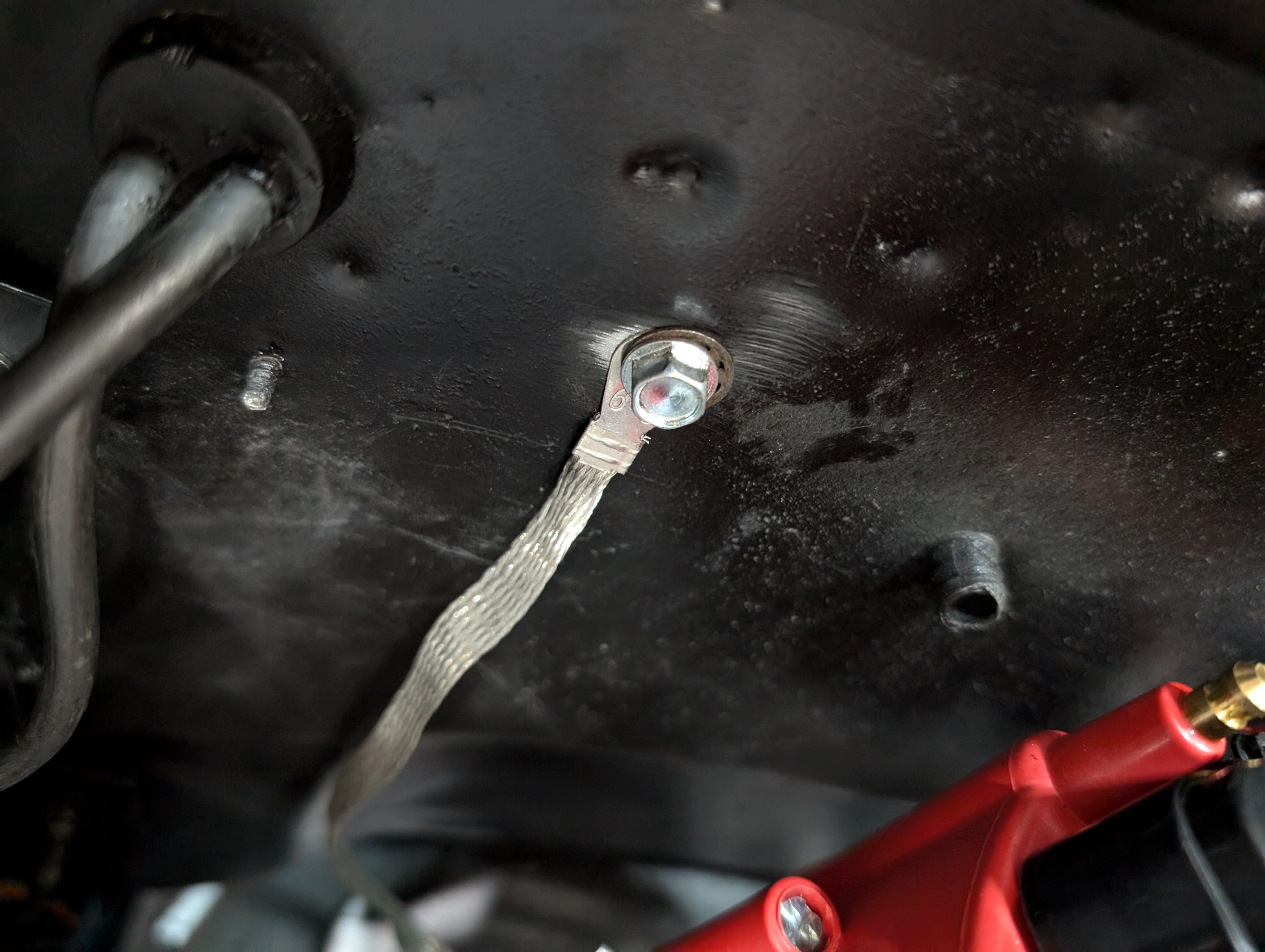

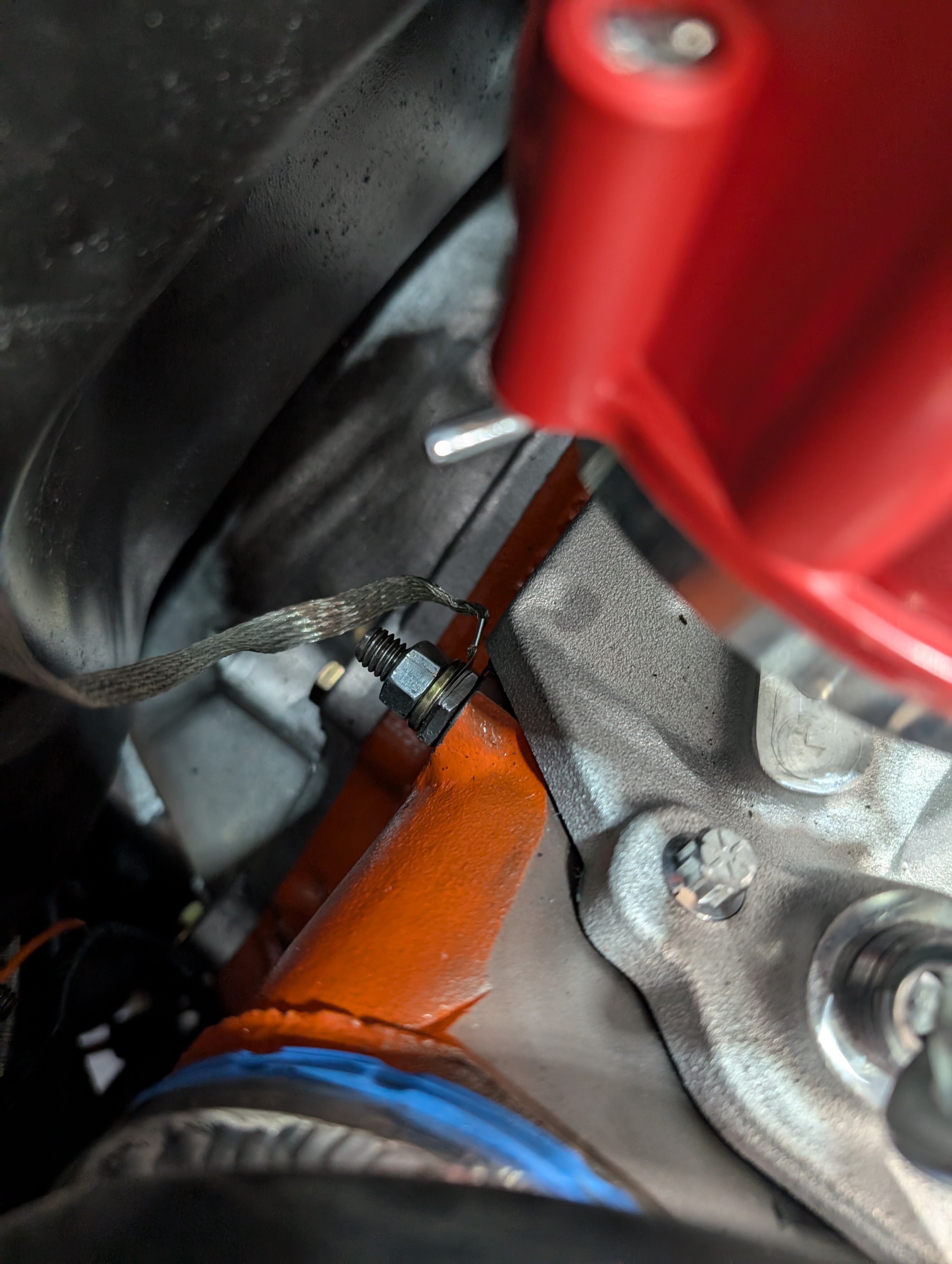

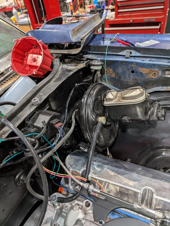

Hey all, Still working on final details of the build and wanted to run this past everyone. Are the ground strap locations I chose sufficient or should I have more. Also are these good spots? Then the vac lines, I have the PCV running to the bottom of the carb, brake boost going to a fitting on the manifold, trans modulator going to another fitting, a vac gauge sharing the brake boost fitting and then for the advance for the distributor is taken off the bottom of the carb where my finger is pointing. Just looking for advice or anything else as I get into the home stretch here so I can move on final wiring!
