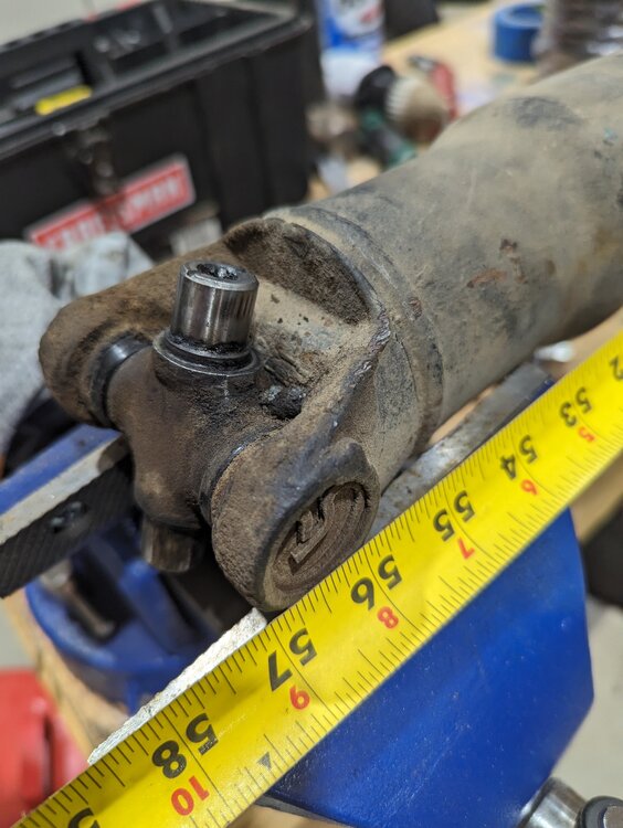

  1. Hey Scott, thank you I appreciate the answer on this. I am guessing I will need a different UV joint as well for the yoke as the 350 is smaller than what the 400 would be? I will look in the for sale section for sure, thanks again.
  2. Hey All, I am trying to figure some stuff out pertaining to the driveshaft and yoke for this 454/400 swap from a 350/350. Am I going to be able to use the stock driveshaft and just swap the yoke on it to fit the 400 or am I going to need to modify and shorten it because the 400 mounts further back? Also if I can use the old driveshaft where can I find a yoke that will fit? Thanks for all the help so far on this thing, you guys are awesome.
