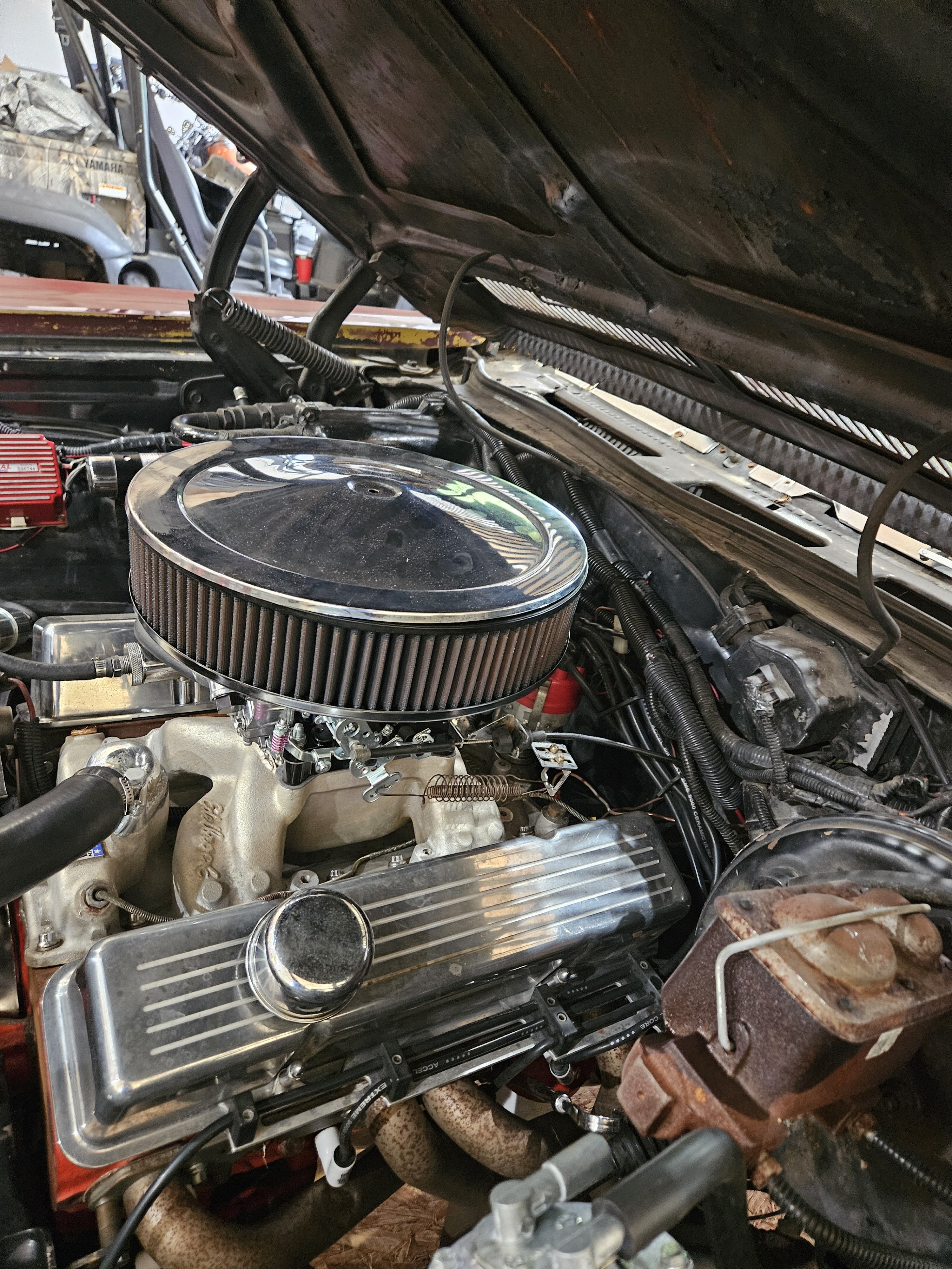

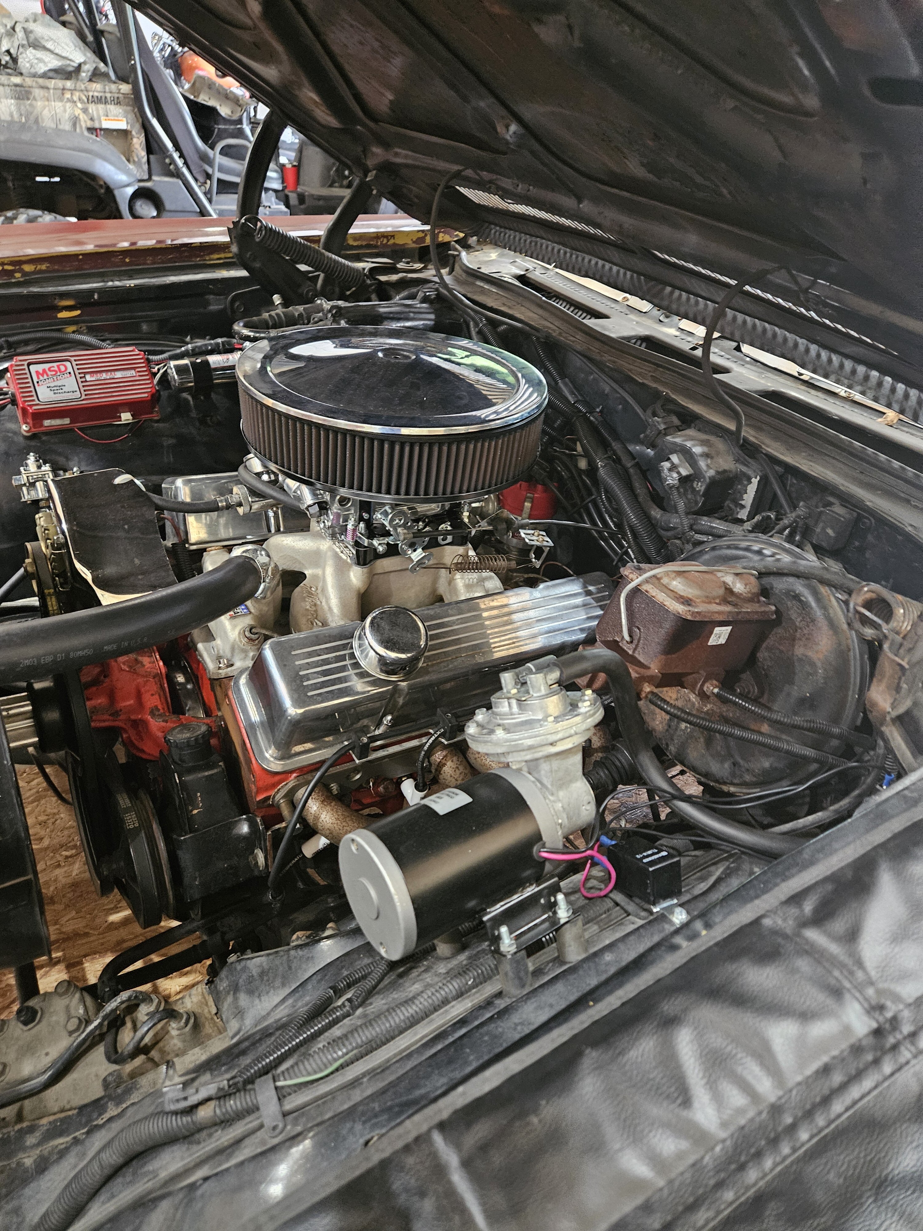

  6. So here we go got the fitting 1 inch spacer had to go with drop down air cleaner wich sucks... pic with and without put new carb on so far before timing got er dialed in gear bout 13 lbs vac per idle set screw on all 4 ...fast idle bout 1000 in gear nice lobe to her but weird thing fuel press gauge bouncing the old summit was loose and rattly so replaced with this in video. Gel type deal 1st one i ever had and as i was tuning carb would even up really weird 20250529_154009.mp4

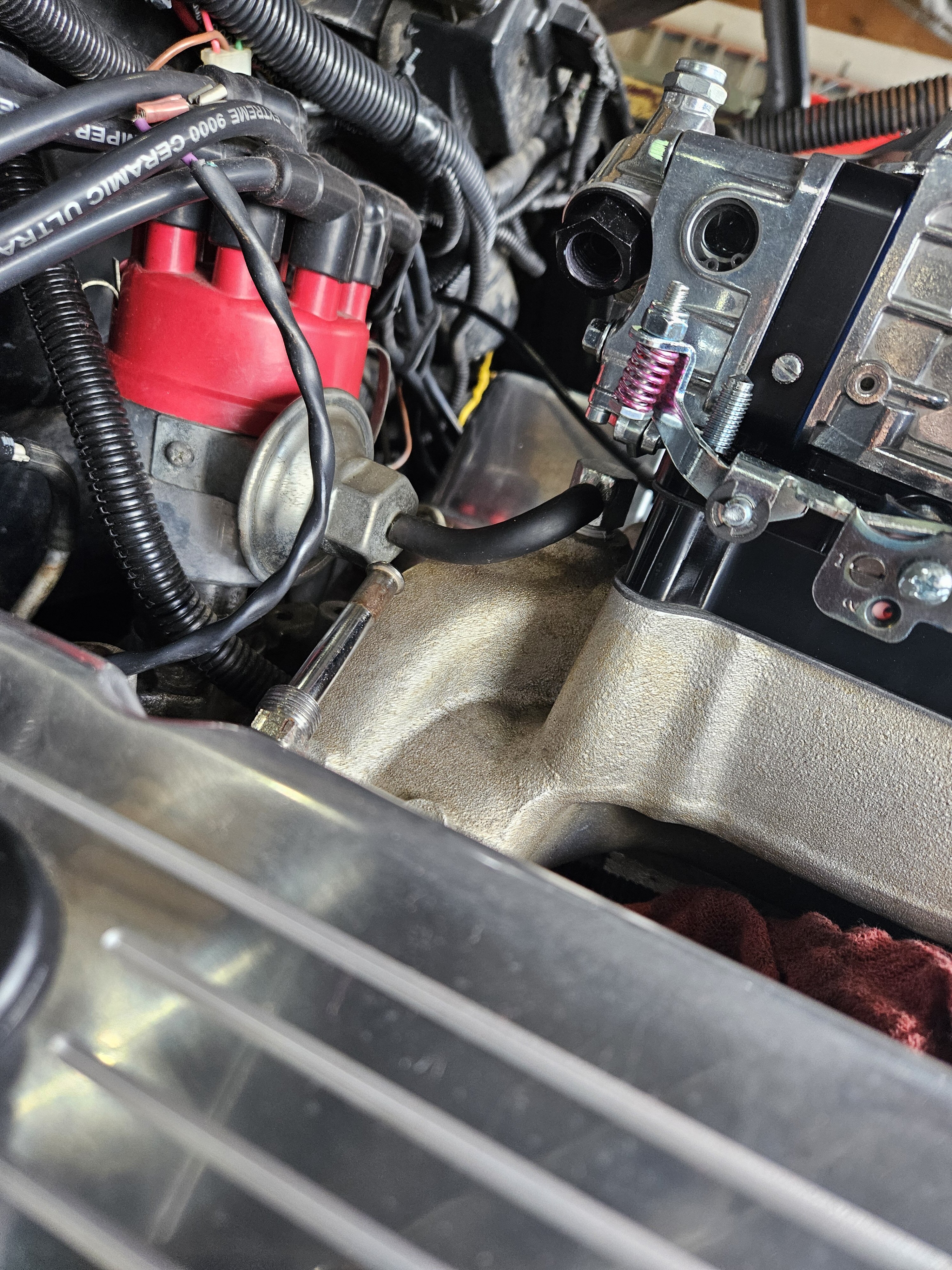

  8. Im runnin dist off of minifold just tryin see diff and installed spacer. Havnt timed yet but runnin real nice i gonna post 3 diff deals with pics bout this lil build

  17. So yu prolly have somethin similar to pics i uploaded with the 90 ° fitting
