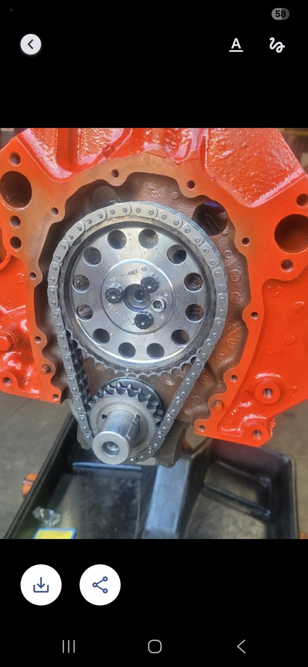

  1. Here we go scott..bottom end in. Just gettin ready degree cam. Wish me luck plus all painted again
