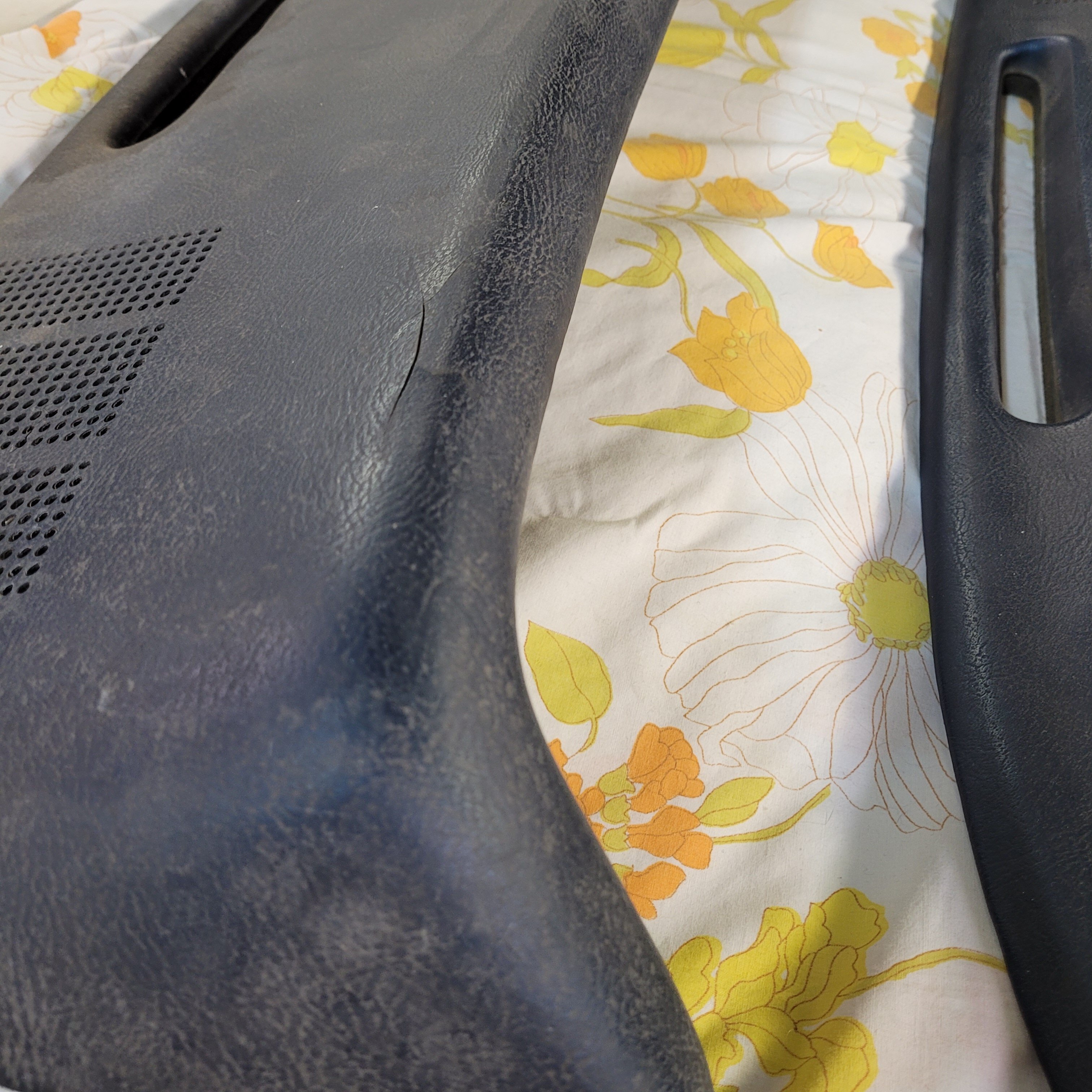

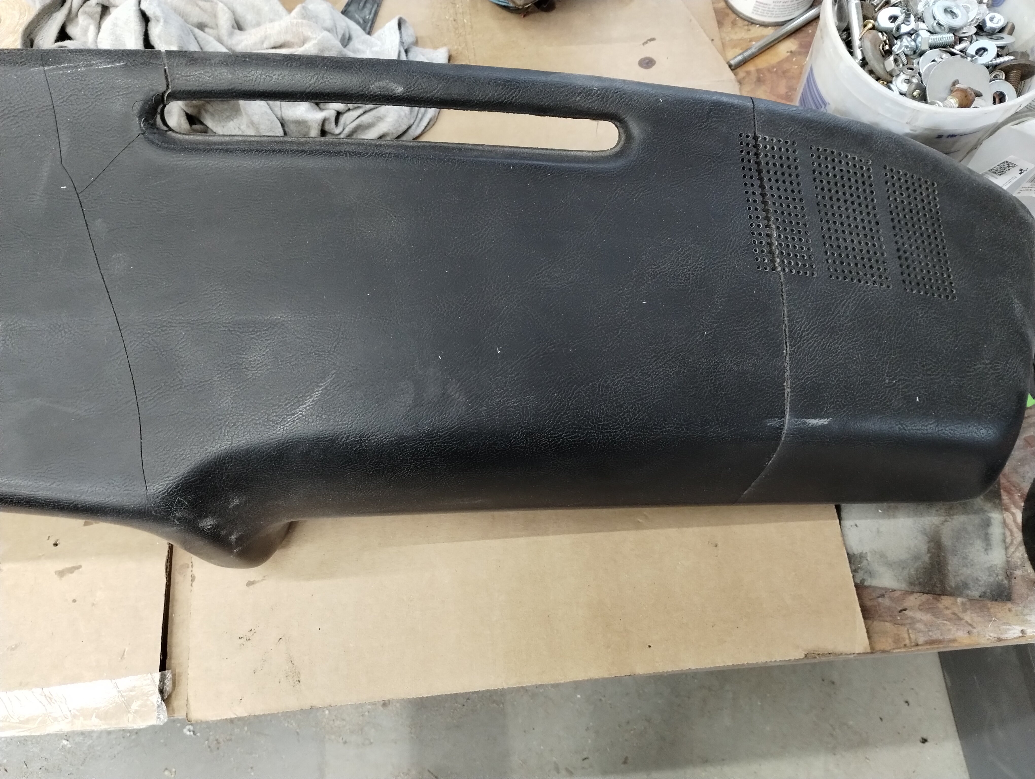

Update ... I pulled the trigger on one of Leo's dash pads. It has a small crack in it and he offered it for a great price. I can fix that small crack much easier than I can fix the many big cracks in my dash pad. I will report back :)
Time allowed, I will still try and save the dash pad i have to some extent. And will offer it here on the forum for shipping cost. I can't bring myself to throw it in the trash. My DIY fix will work reasonably well and I enjoy a challenge.

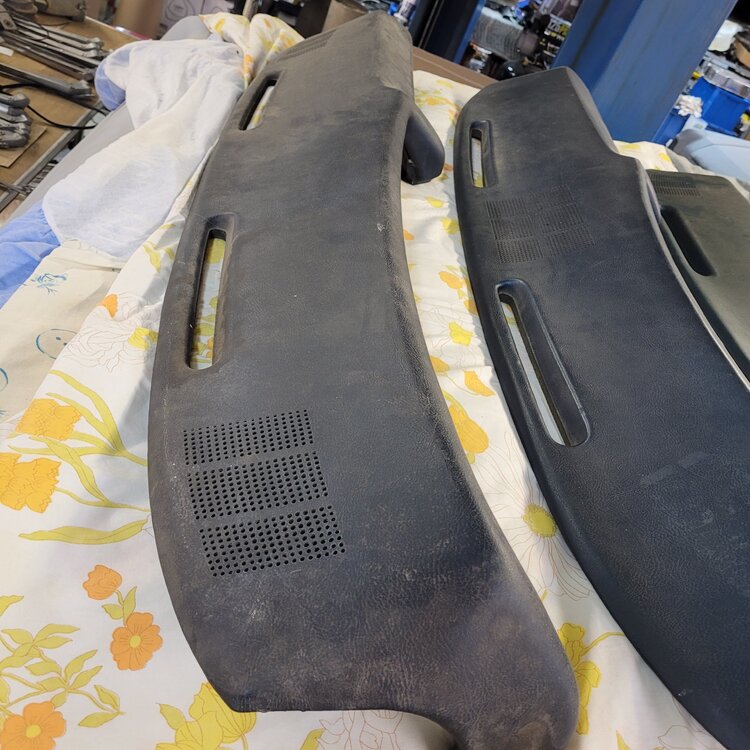

My new (used) dash pad from Leo just arrived at my house! Can't wait to get home and check it out :)
