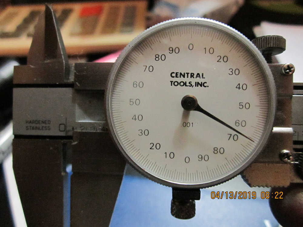

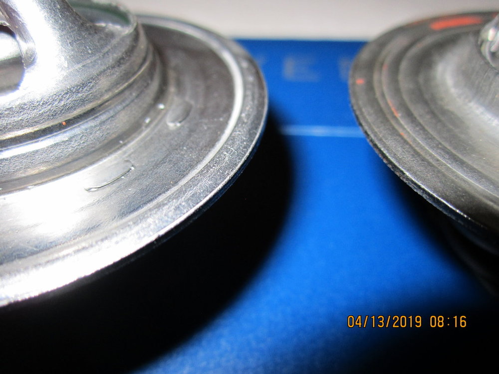

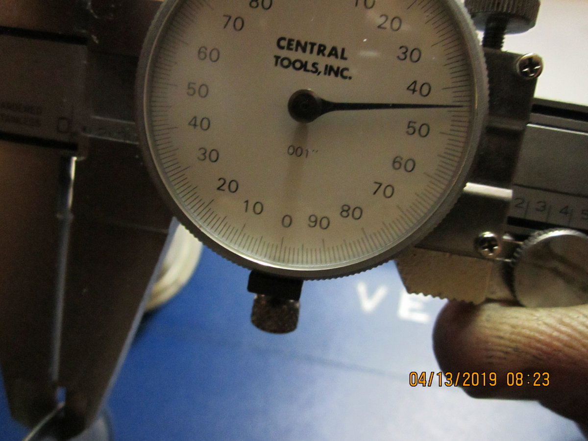

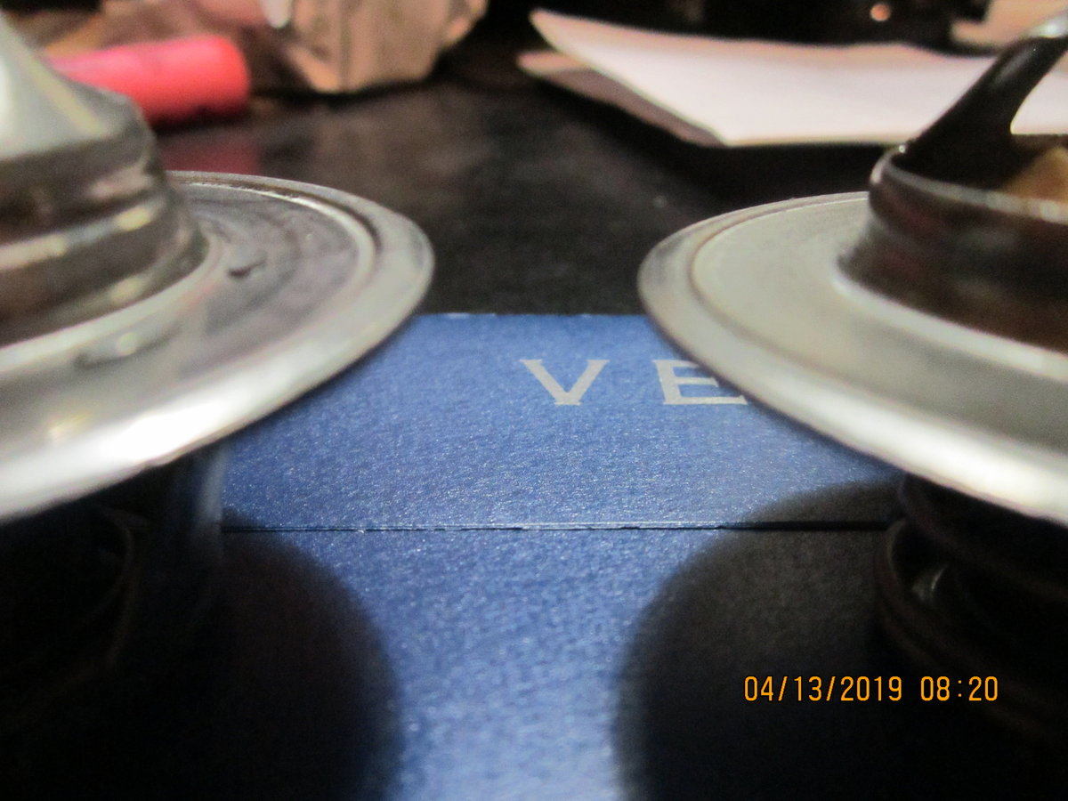

    The third picture is the new one on the left and the one out of the car on the right. Fourth picture is the new premium on left and the new economy on the right. the last two show caliper measurements premium and economy NAPA thermostats. The first and second pictures you can visually see the difference. As I said previously this is something you do not consider and you don,t expect something like this until you crack a couple housing and investigate why. John S

    When I get home and on my computer I have pictures of both thermostats with a caliper on them that way you can see the difference between them One I believe is .044 thick the other one is .066 thick
