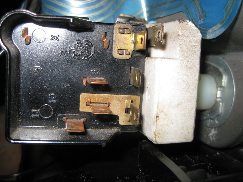

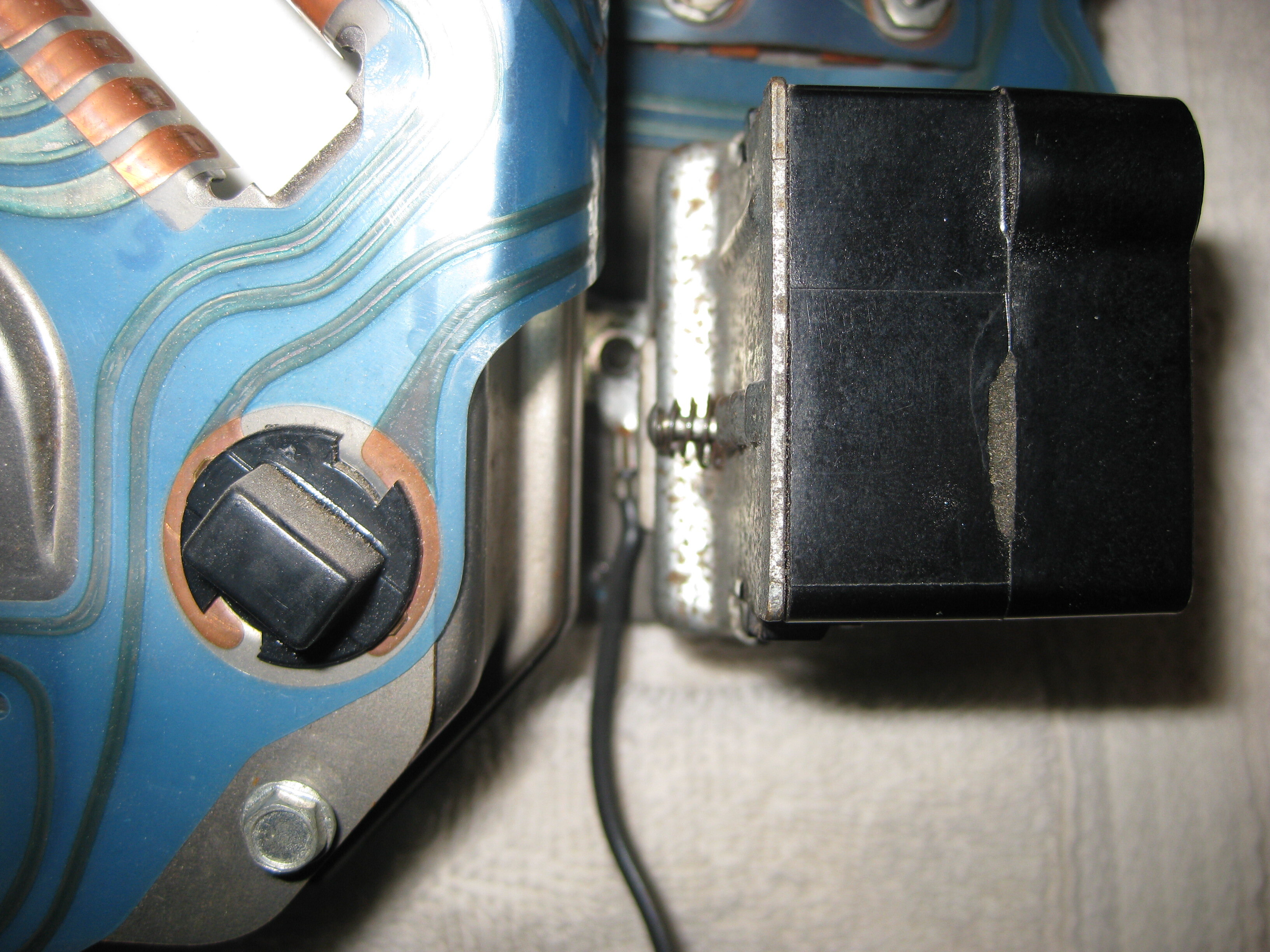

  9. 2 more pictures: Notice the 7 tabs the connector attaches to. Notice the ground wire hanging down on the second picture! Make sure it is in place when the new switch is installed. The dash light dimmer looks like a small coil spring and it is inside that white box that is it's insulator. I have seen the coil broken and that will cause the dash lights to fail and blow the fuse. You have already verified the small fuse in the fuse box is OK? The headlights must be on, then power is sent to the dash lights, before you can check the fuse. I will look for a picture of that now:
  10. Unhook the battery Take off the top dash pad. (This may not be required if you can reach it all from under) Then you push in this tiny button (with the tiny spring) and pull out the headlight switch knob and shaft Picture: Then there is a threaded thing (now visible with the knob out) that requires a large screwdriver that you unscrew. Not sure if the best time to unhook the wire connector in now or when it's still secure in the cluster? I have heard there are some switches sold that are wrong. 7 connectors are required for a 71. I will add more pictures in the next reply.

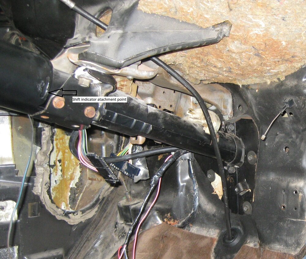

  16. I know very well where this fragile thin wire attaches to the steering column on my 71 Monte, and I still broke it one time!!
