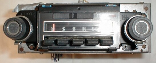

Info from my 71: I think I remember 3 wires going to the two rear speakers. One ground, one for left and one for right. In 1996, I replaced my original AM/FM stereo with a new Radio from Custom Autosound Kenwood 800 Radio $422.94 from Classic Car Radio Co. Speakers from Best Buy $60.34 Front, I think. I also replaced the rear speakers but can't find the info for them. I did NOT have to cut open the dash to make it fit, it fit great. The sound is not great but I like having a CD player in the trunk so I don't have to listen to commercials. I here there are fancier radios available now that hook up to your cell phone. Here is my original radio.

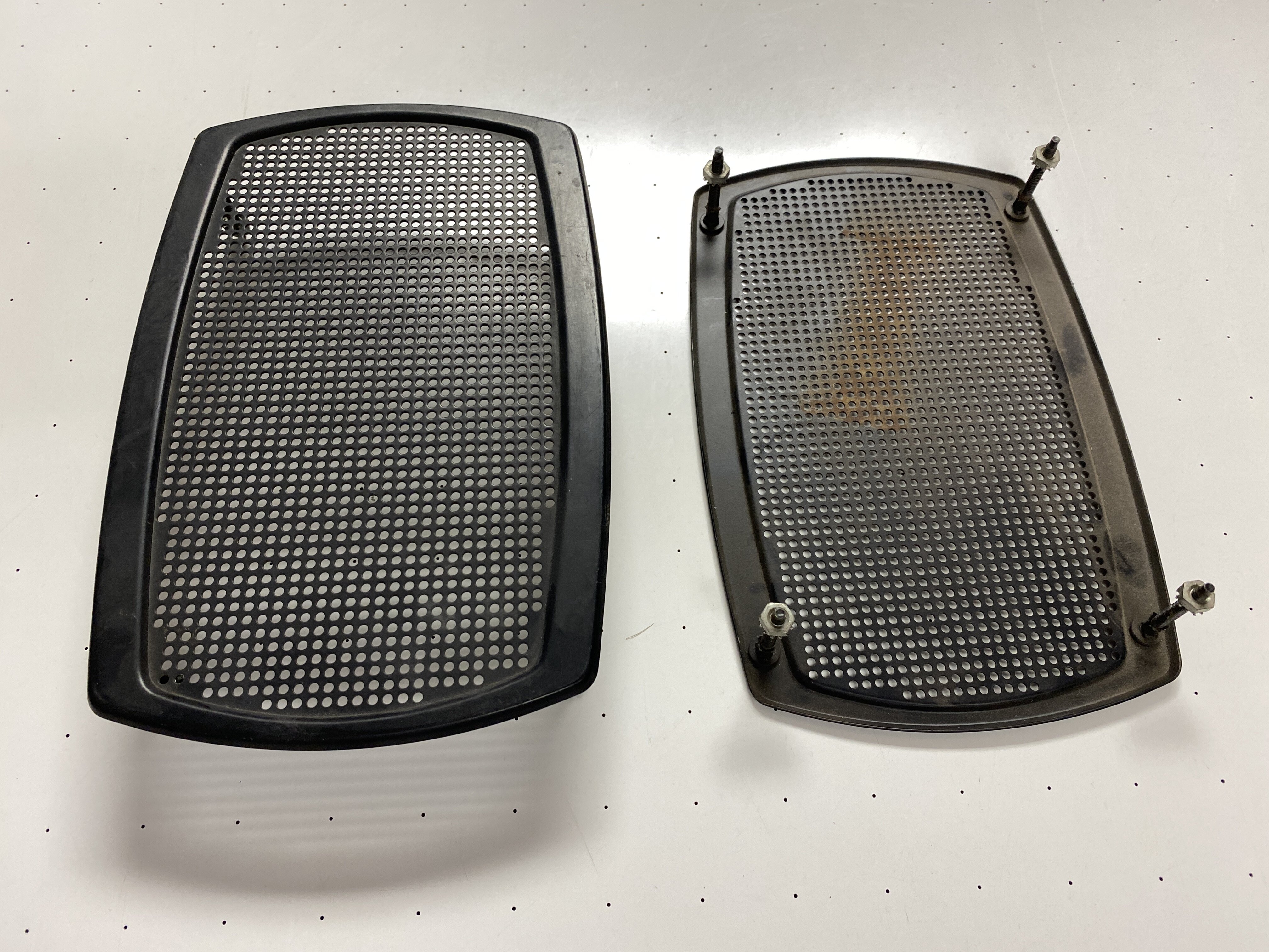

Here is a picture of the rear speaker grills from my 71 Monte Carlo built in Canada. I didn't know they were different than the 1970 version.

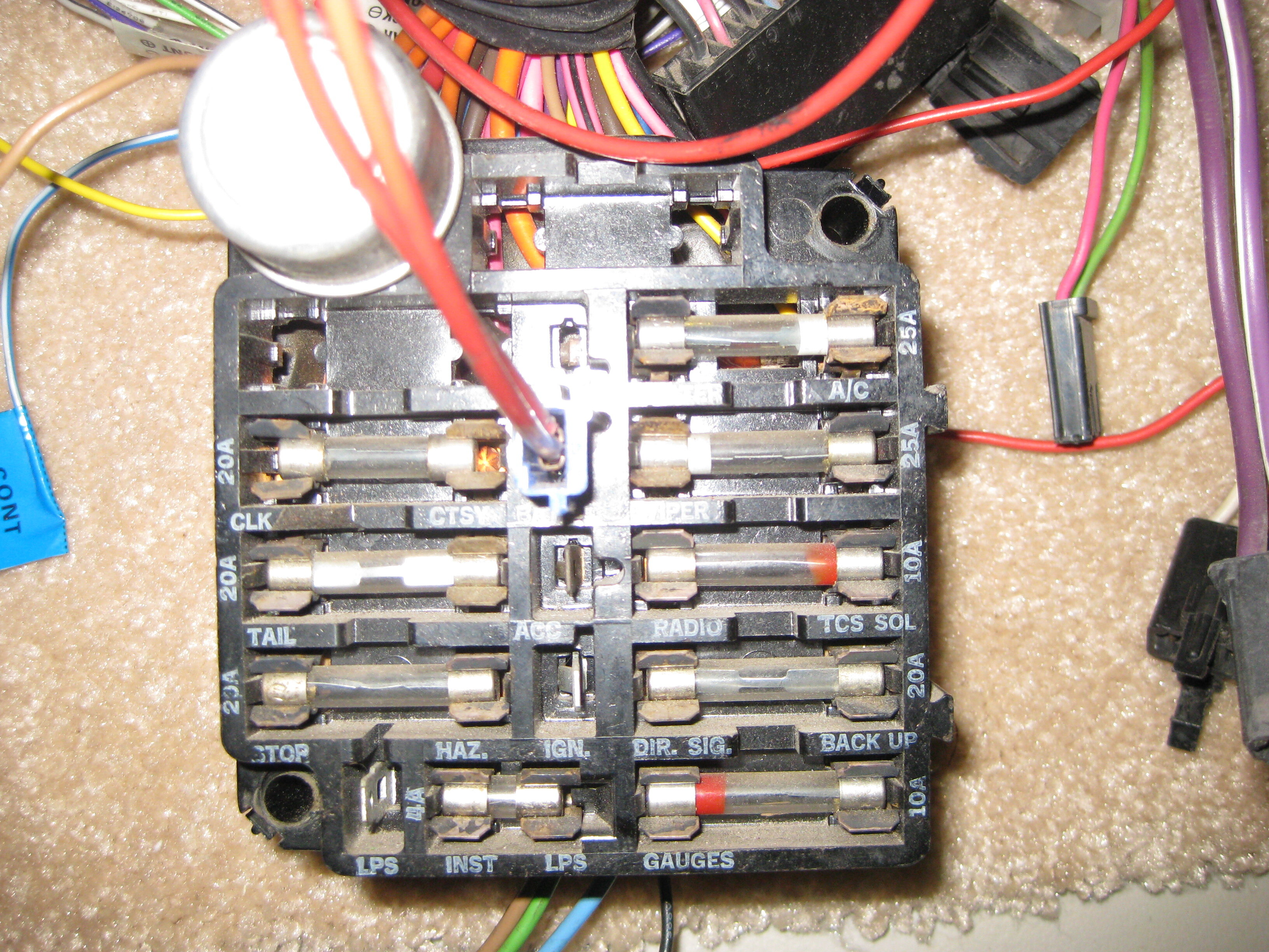

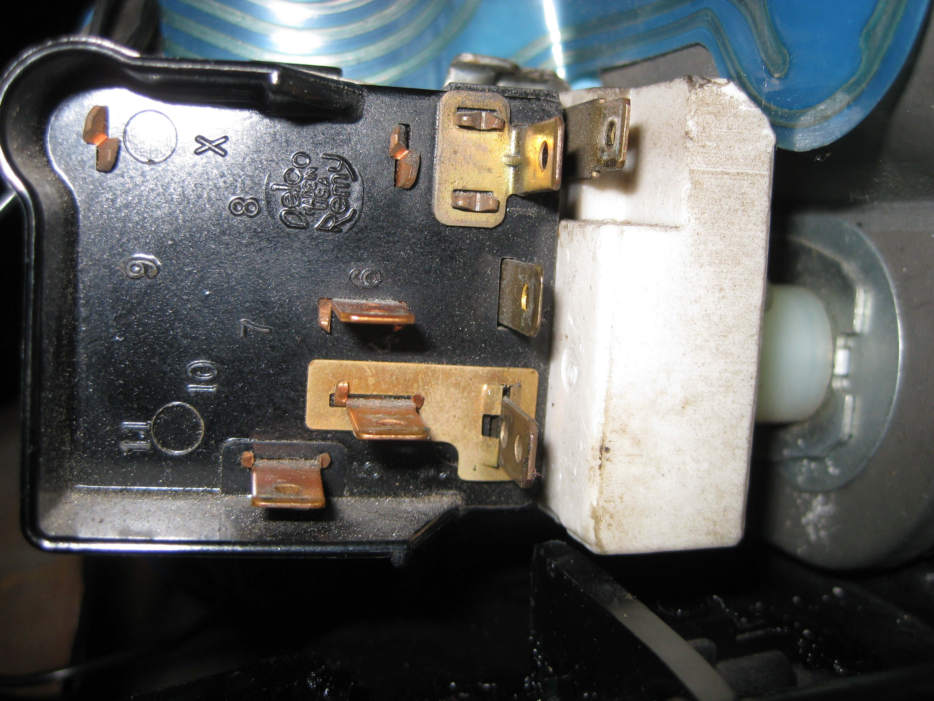

One thing about the fuse for the dash lights, it's the tiny one at the bottom, (INST LPS) on my 71 Monte, and if testing with a "test light" or volt meter, the headlight switch needs to be pulled out at least to the first "click" before power will go the fuse. If you do then get power to one side of the fuse, the other should also have power if the fuse is not blown. There is a resistor coil that you turn to "DIM" the dash lights. I have heard the coil can get corroded and it may take repeated rotating of the H/L switch to clean it. Since you haven't changed anything lately, that makes it tougher. Good luck! The H/L switch in my 71 is shown in the picture below. The "coiled wire" resistor is inside of the white block shown. Sorry I don't have a better picture. -

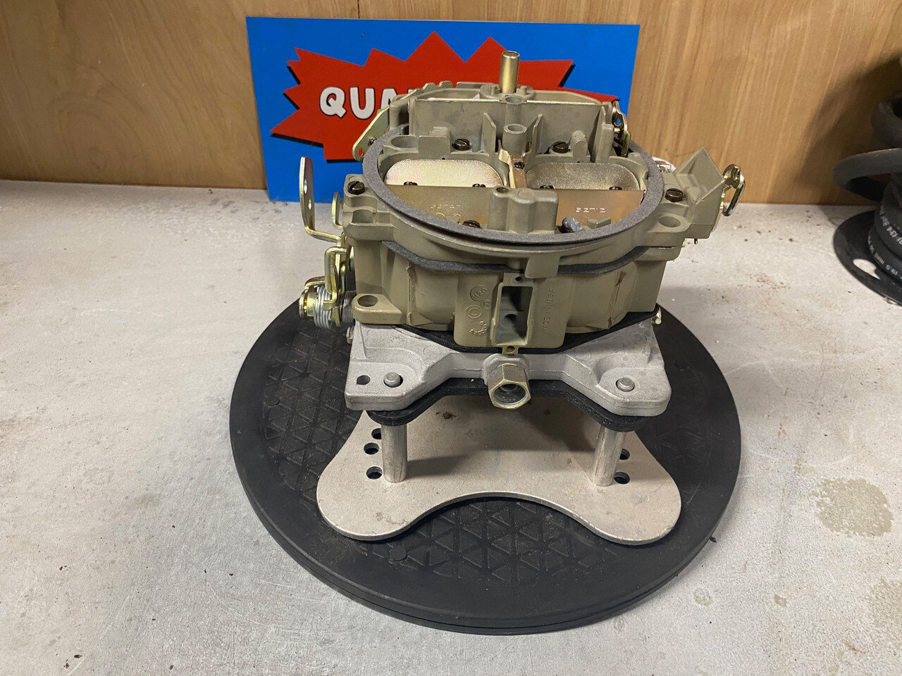

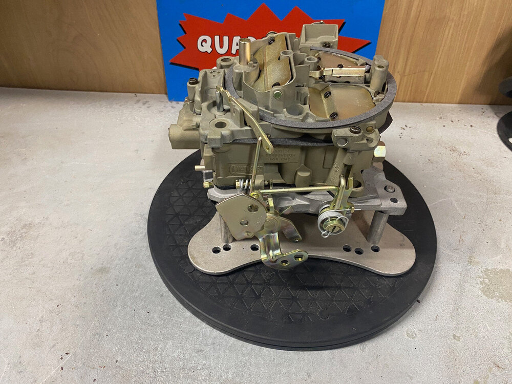

Thanks!! Great site and I found my 71 Qudrajet #7041202 and some great pictures. You can clearly see the linkage on the side with all the Choke pull off rods and such. I had mine rebuild in 1993 for $187.00 by the CARBURETOR SHOP in Ontario, Ca. because the primary shaft bushings were worn out and the throttle shaft would wobble when you wiggled it.
There is a vacuum diaphragm (white thing, bottom left) that controls the speed of the secondary opening. If it is leaking, unhooked or not working properly, this could cause your problem. This also opens your choke slightly after starting the engine cold, so it doesn't run too rich. (This is from my 71 350 4bbl stock engine.
