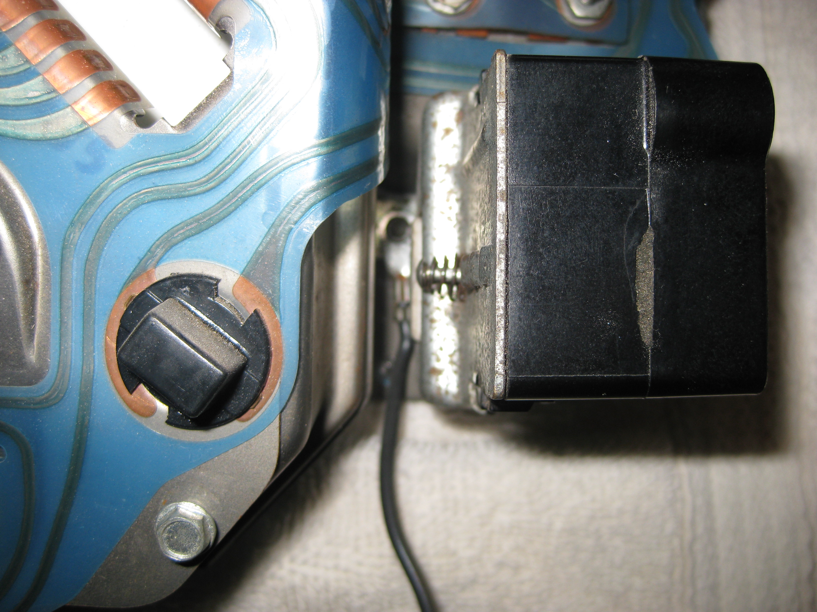

Is the dash "grounded" correctly / fully You could add an extra ground wire, that you know is truly grounded, for testing purposes. Here are some pictures I have from my 71 with the optional gauge package. I forgot to hook up the ground wire attached to the parking brake assembly and had some problems. I also remember being worried the power spade, for the clock, could "touch" the printed circuit and receive power or a short if I didn't add some black tape to insulate it. I also remember a problem people have had if the wrong headlight switch is used. Mine has 7 pins. some replacements do not. Again, for my 71 NO A/C Good luck!
