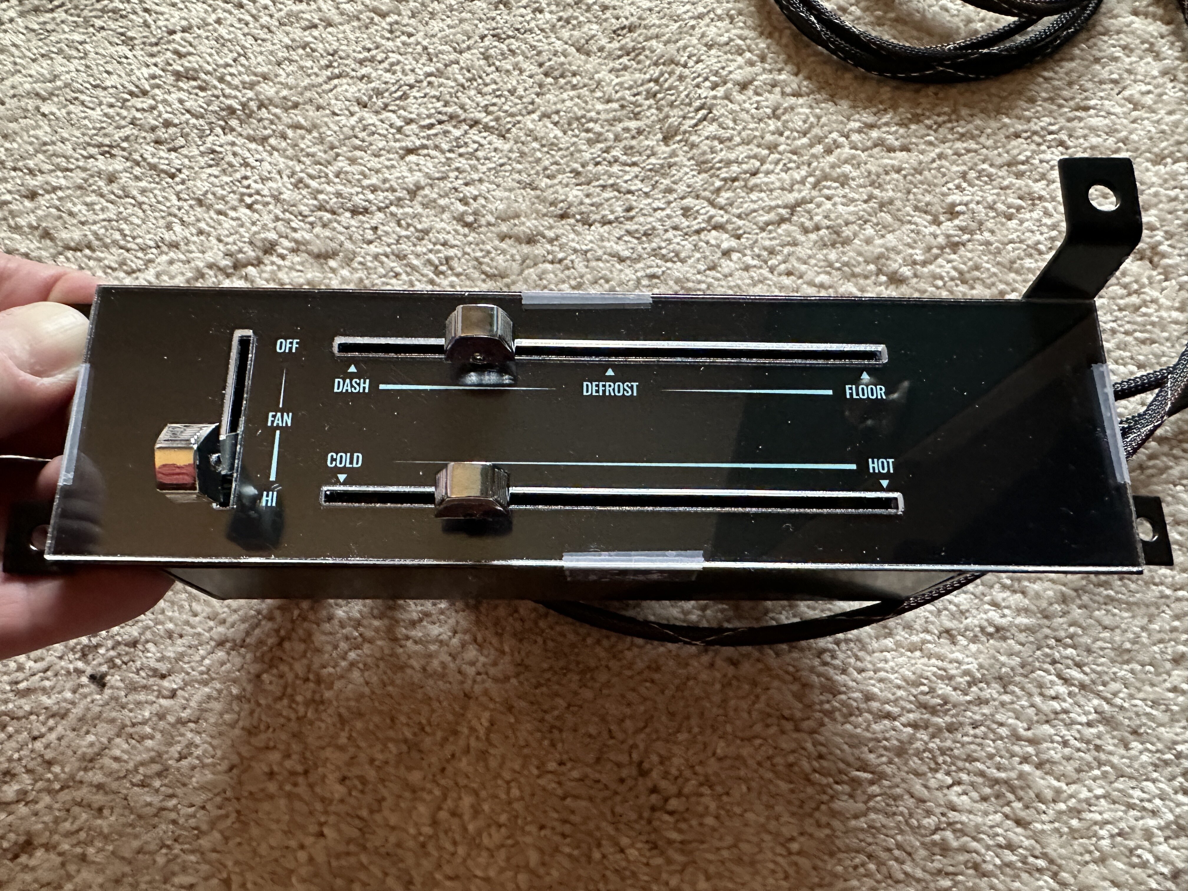

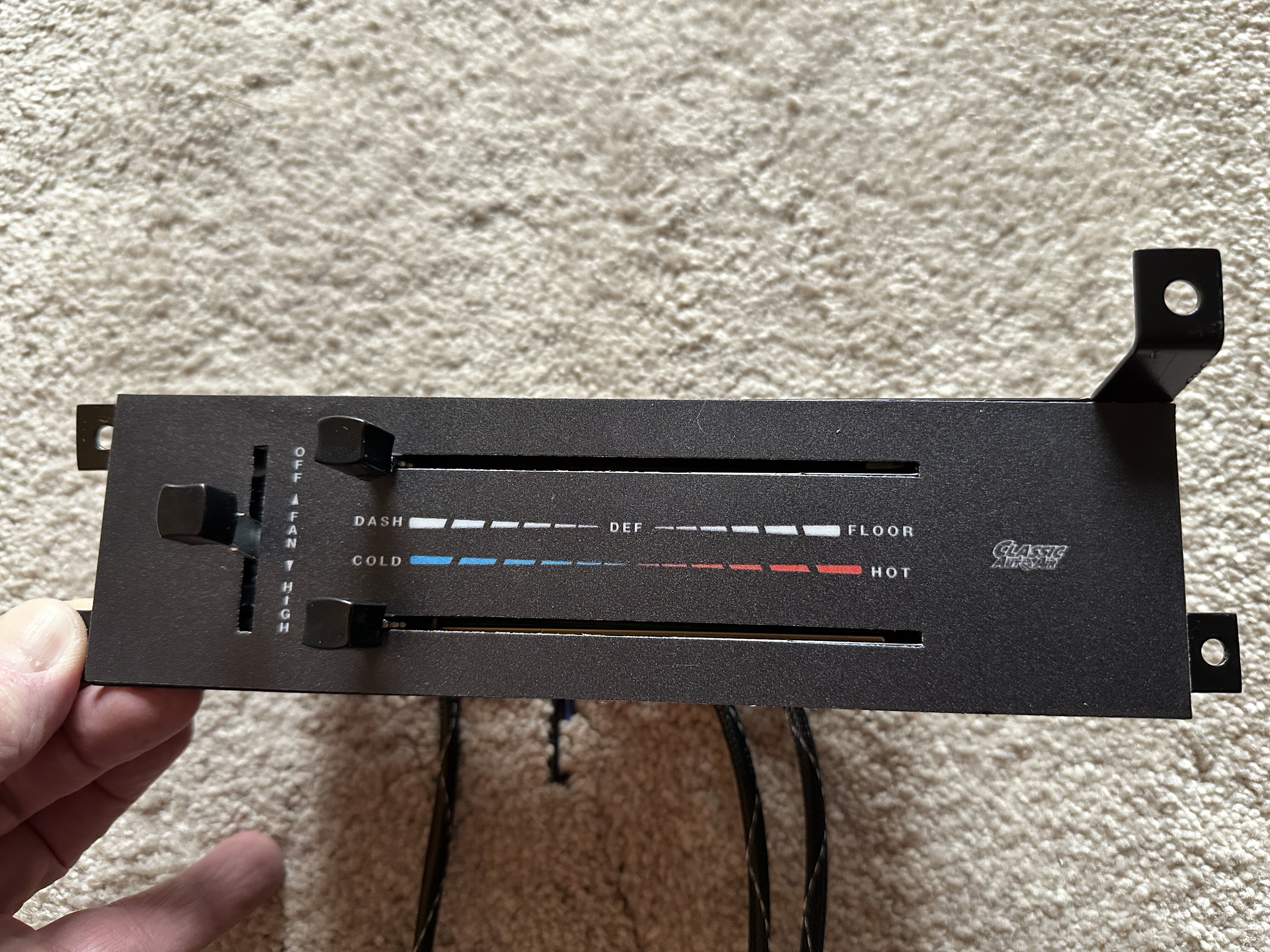

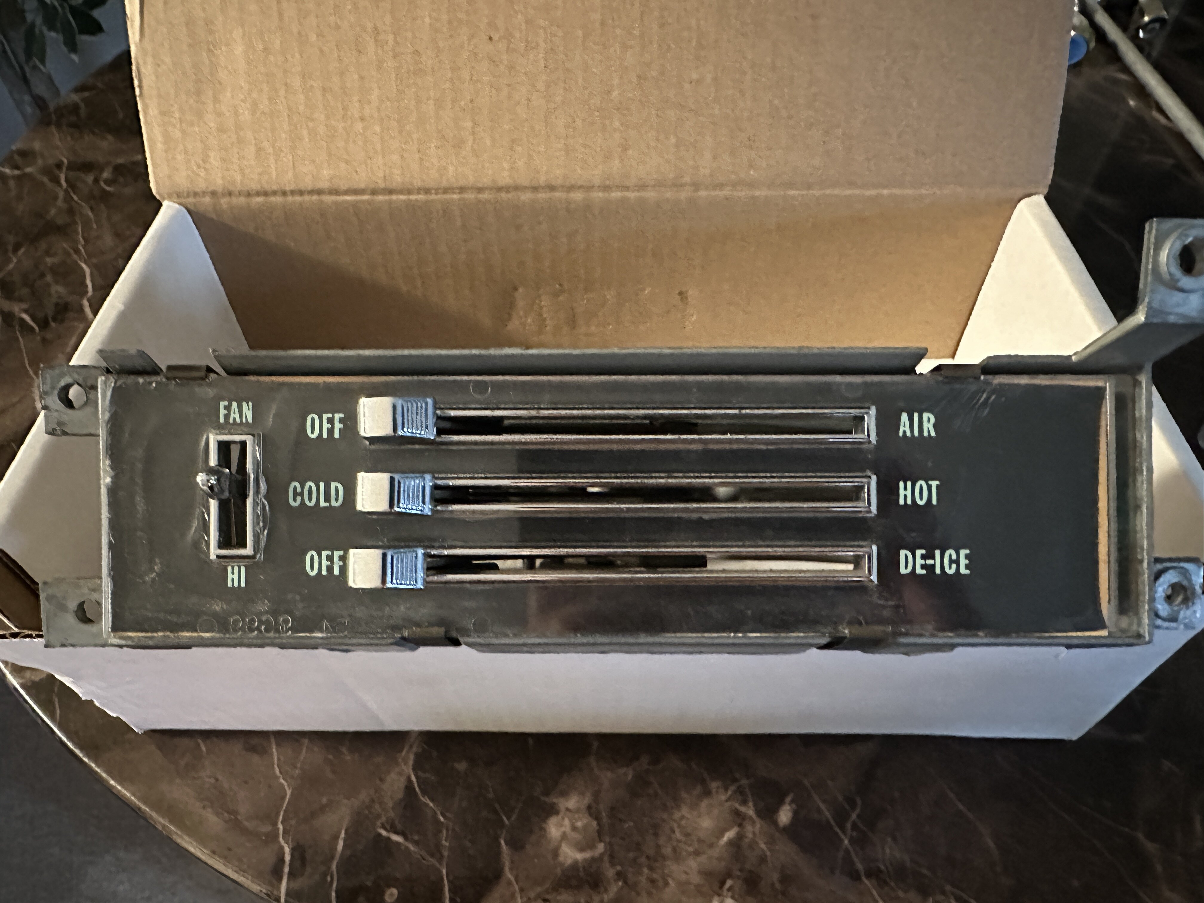

  2. I purchased an A/C kit from Classic Auto Air but I wasn't happy with the appearance of the HVAC control unit faceplate; it looked too modern. I wanted something that was more era-appropriate for my 1970 so I made some changes. First, I measured the faceplate and control slots from all directions. I then made a template in Adobe Illustrator and created the artwork that would go over top of the original CAA faceplate. I had them professionally printed and I cut the slots using an Exacto knife and straight edge. Next, I asked a buddy of mine who has a laser cutting machine to use those measurements to cut a piece of thin acrylic plastic to go over top of the new faceplate artwork. I secured it with a very thin strip of tape that will be hidden behind the dash trim when installed. I didn't like/want the black knobs that came with the CAA unit, so I bought new (reproduction) control knobs and drilled them for set screws. I pieced it all together and viola! Something that's much more appropriate for 1970. I don't think a casual observer will even notice. Attached are images of the original control unit/faceplate, the CAA unit before mods, the new artwork and clear faceplate cover and all pieced together.

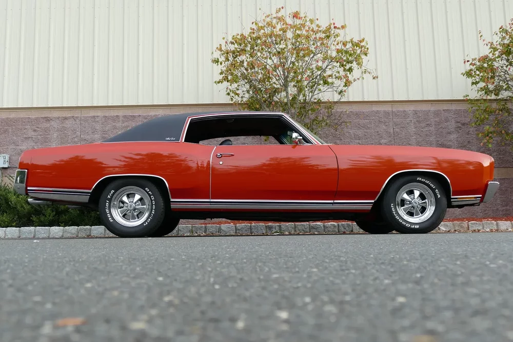

  17. TheBMan

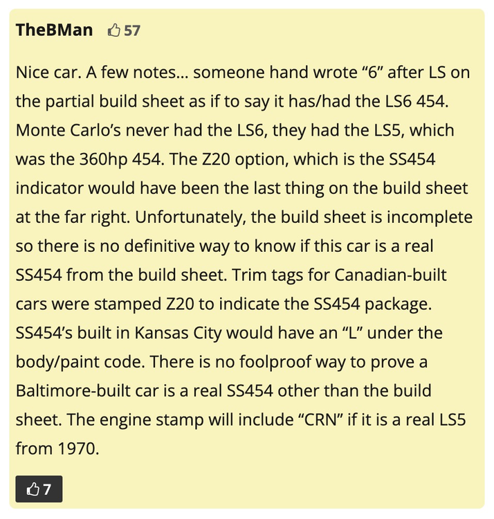

  22. Ha! Now I remember this car on BaT! If you look at the comments, I commented on the handwritten build sheet notes that said LS and the "6" was handwritten.
