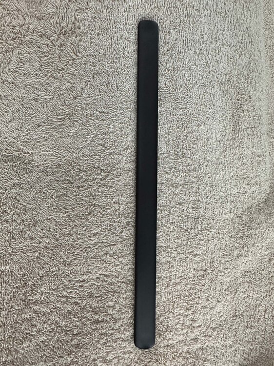

Assuming the AMK straps are the same as the one in the picture provided by Bruce, it looks like the 6.69" does not include the rounded ends. A 2" radiator hose would have a circumference of 6.28" so technically these straps would be long enough BUT Joe says they're too short and I tend to believe him.

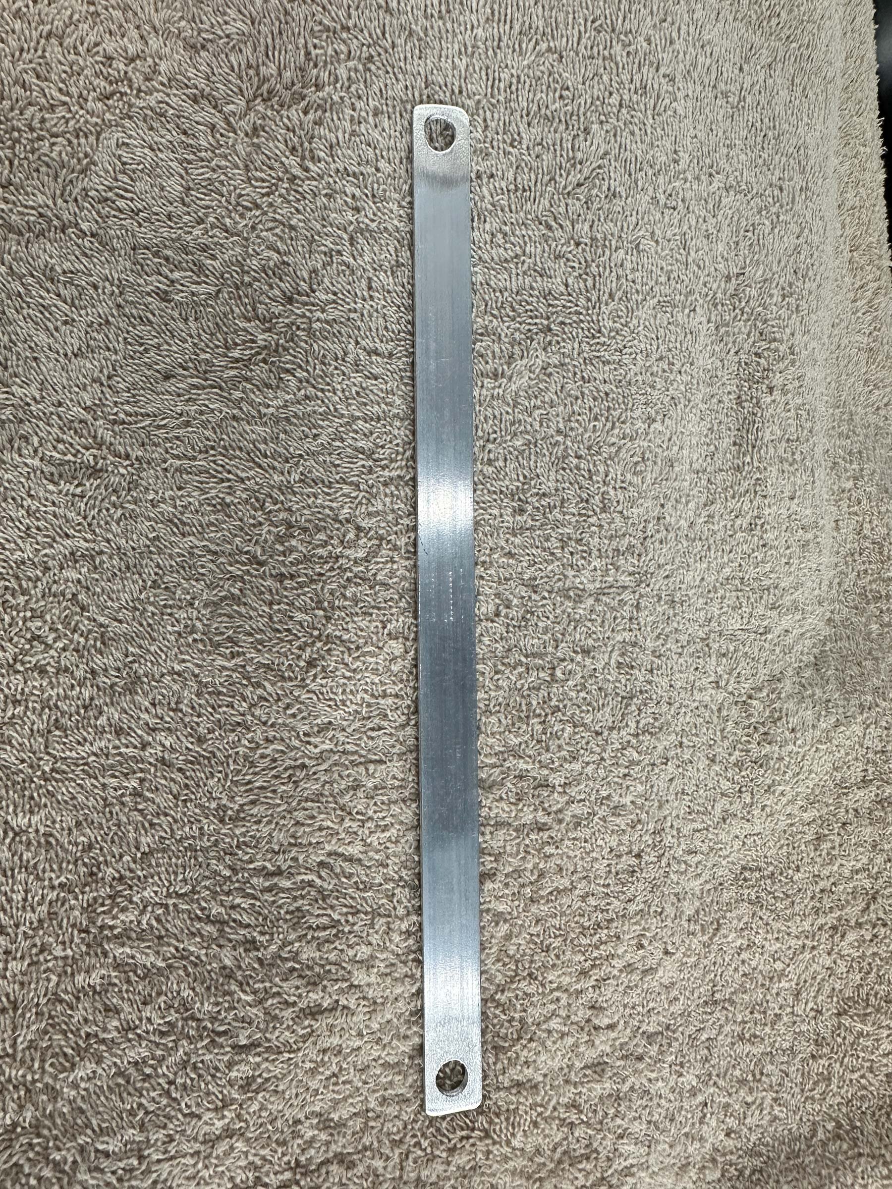

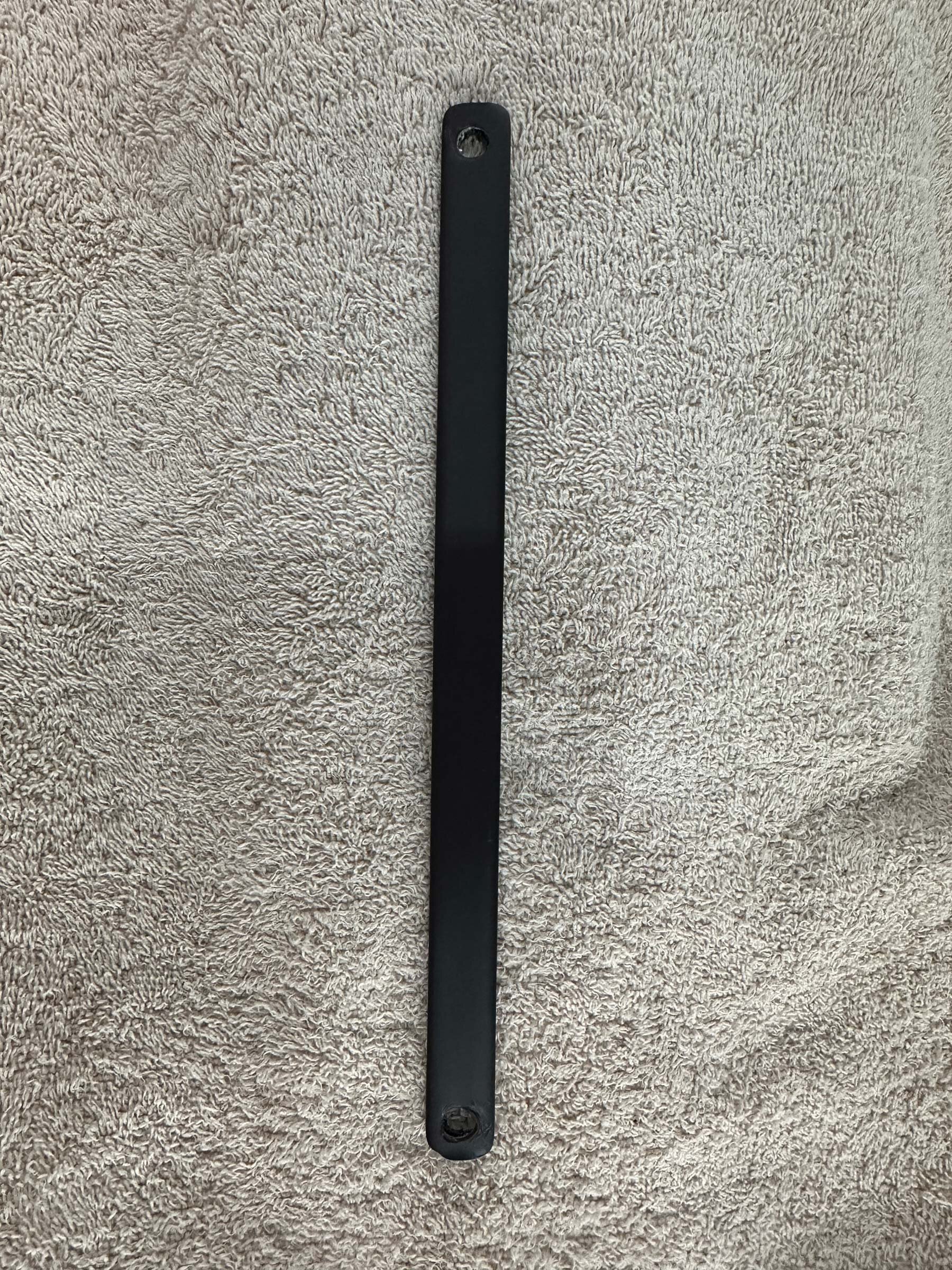

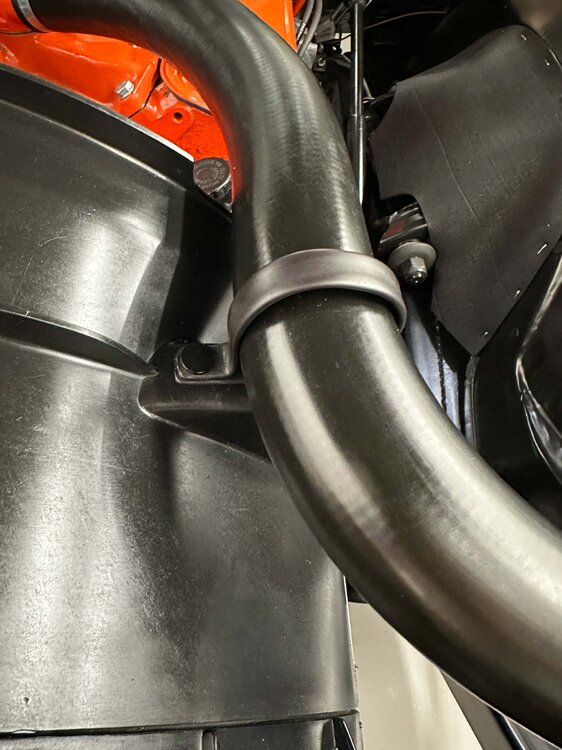

There have been threads about where to get the upper radiator hose strap that secures the hose to the shroud but we all know that originals or reproductions are no longer available. I've been using these push-pin wire ties from Amazon, and they work fine, but I thought I'd try to make my own for a more polished look. I bought a piece of 1/16" x 1/2" metal strip at Lowes and I had some large heat-shrink tubing that fit nicely over the metal. First I cut a strip of metal about 8 5/8" and drilled a 1/4" hole in each end. Then I slid the heat-shrink over the metal and applied heat to shrink the tubing over the metal to shrink to a nice fit. Then I used a paper hole punch to cut through the heat-shrink and then bent one end as you can see in the photos. Then I used a small aerosol can as a form to bend the metal around to get a nice circle shape. Then some manual tweaking to get it the final way I wanted it. Then I used a 1/4" plastic push-in trim button to secure the strap to the shroud. It was a fun, relatively quick project. Hopefully it helps someone else if they're wondering what to do about a missing hose strap. Happy New Year!
