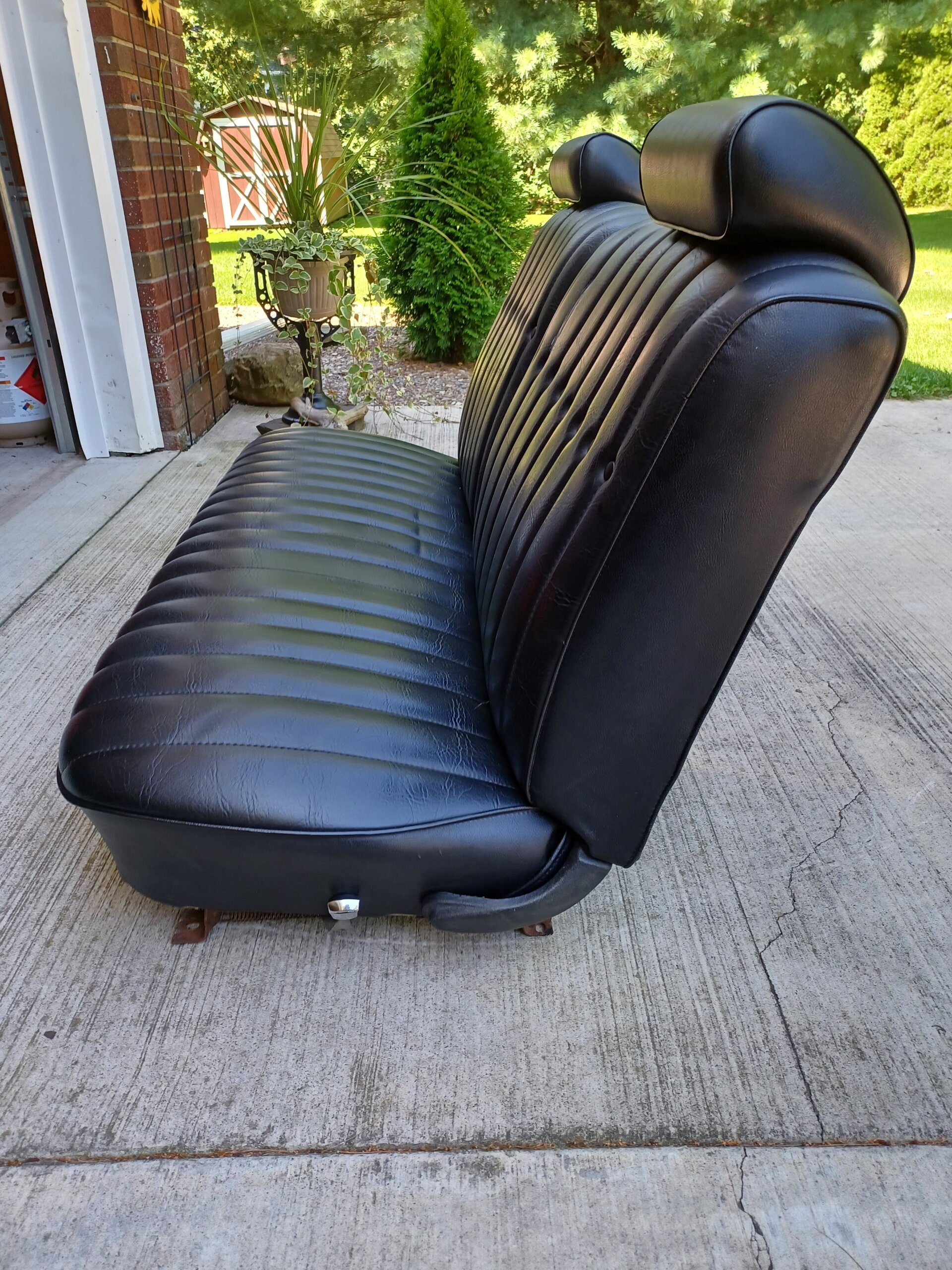

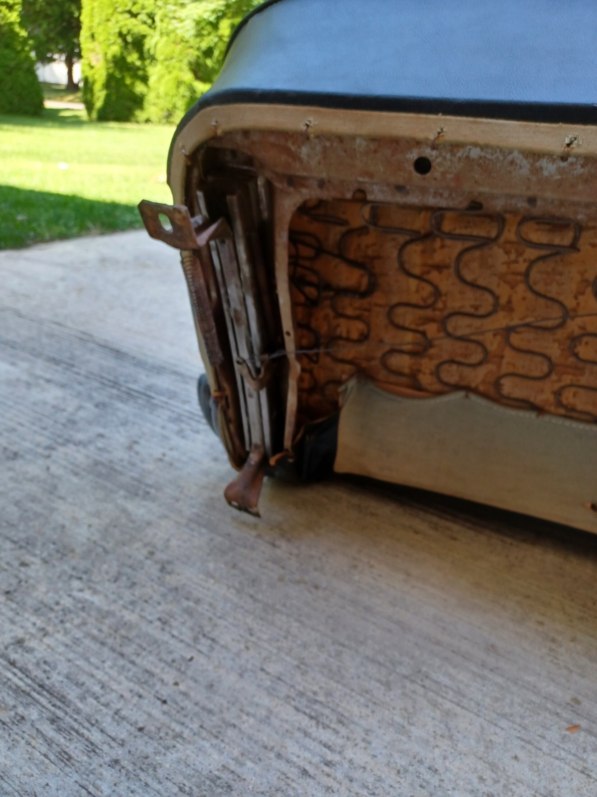

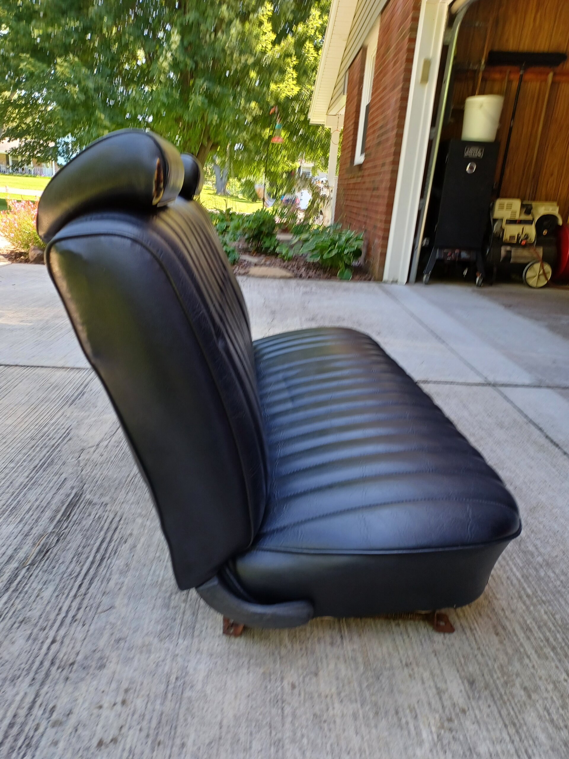

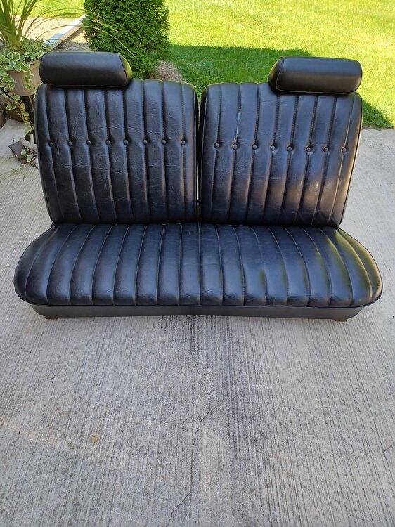

Does anyone want a 1971 Monte Bench Seat. very good condition. The photos show 2 imperfections. Asking $550. I live near Rochester NY. you can call 585-750-8073. Thanks Wayne
