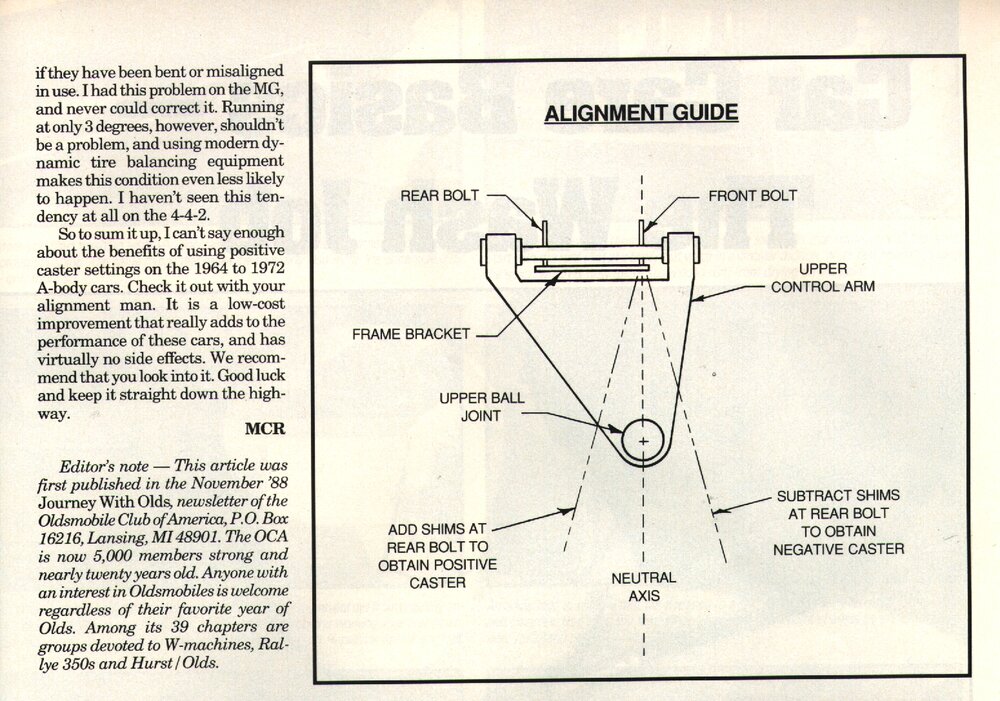

stangeba Posted July 14, 2022 Posted July 14, 2022 Ft end alignment specs changed when all cars came with power steering. Here is an article. I had mine changed and saw some improvement. I also added the Poly bushings but after several years they started to squeak like crazy so now I will replace them with old school rubber. 1 Quote

TheBMan Posted July 15, 2022 Author Posted July 15, 2022 14 hours ago, stangeba said: Ft end alignment specs changed when all cars came with power steering. Here is an article. I had mine changed and saw some improvement. I also added the Poly bushings but after several years they started to squeak like crazy so now I will replace them with old school rubber. @stangeba This is exactly what I was talking about. Because I know the affects of caster on steering stability, I was thinking about adding some positive caster to my alignment. I wasn't sure how much but this article spells it out. Awesome! Thanks for sharing, Bruce!! 1 Quote

Blackhawk Posted July 15, 2022 Posted July 15, 2022 Your alignment guy can get the settings from a mid-70's Pontiac for something specific to power steering and radial tires. Otherwise: Caster should be as high as possible in the positive direction. You'll probably end up somewhere around +1-3* without a stack of shims on the rear bolt. Toe should be 1/16" to 1/8" in. Camber should be .5* negative. 1 Quote

TheBMan Posted August 3, 2022 Author Posted August 3, 2022 I had the alignment done yesterday. The guy was able to get about +2.5° caster before running out of shims. It made a very noticeable difference; the car drives straight with very little correction and no longer feels sketchy at highway speed with no noticeable difference in steering feel or response. We ordered more shims and I'm going back soon to have more caster dialed in. There are also offset control arm bushing shafts that are available for this very problem but I don't think I want to go to that much trouble. I'm going to get as much positive caster as I can with shims and call it a day. Thanks to everyone who had input on the topic. I'll update again after I get more caster dialed in. 1 Quote
TheBMan Posted August 20, 2022 Author Posted August 20, 2022 UPDATE: I replaced the upper and lower control arms, ball joints, bushings and had another alignment done. This time the caster was set to +5.5°. It's like driving a different car; so much better than it was before. Thanks again for all of the feedback. Hopefully others will find this information useful! 3 Quote
