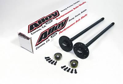

502ci Posted December 30, 2006 Share Posted December 30, 2006 Wallaby I hear you there, but I already got the axles They were only $209 at summit and they are 35 years old If they do not fix it then it is off to the shop to get looked at and to get gears and a posi! Thanks, Ian I`m not sure which axles you purchased...stock or aftermarket. Moser has decent C-clip axle that doesn`t taper down like the factory style ones do. They run $235.00 at Summit, and are like 25% to 30% stronger. You can see in the photo how they are even in diameter all the way down. "I was under the car yesterday and noticed a little leakage from the pinion seal. I know the nut is on real tight, but is it OK to take the yoke off and replace the seal and then reattach the yoke? Or do you have to replace the crush collar any time you take the nut off?" I was always told to replace the crush sleeve...but I tried to get away without doing it when I replaced my pinion...now I got a leaker . I would not mess with it you might make it worse. Quote Link to comment Share on other sites More sharing options...
Ian Posted December 30, 2006 Author Share Posted December 30, 2006 I got these they are a little beefier than the stock ones. I got them in with out problem. I deceided to wait on the pinion seal for now. Ian Quote Link to comment Share on other sites More sharing options...
