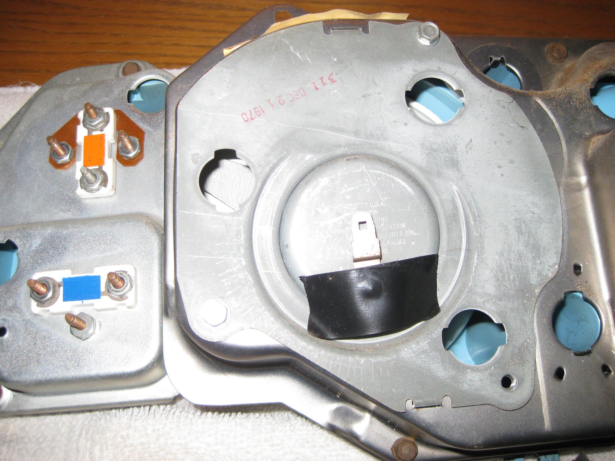

stangeba Posted February 25 Share Posted February 25 Remove all the light bulb sockets "twist", then remove the screws that hold the printed circuit to the steel IP base. The circuit board should come off then replace it with the new one, carefully replace the bulbs and screws. I don't remember any problems with mine. I DO remember the tiny fragile shift indicator cable that I almost broke several times. Years ago I swapped my stock IP in my 71 for one with a tach and gauges. That was a big job for me! Here are pictures I hope they help. I remember the small nut would NOT loosen up so I held the end tight with small vise grip pliers so I didn't break it off! The clock had a small piece of tape the I replaced to keep it from shorting out when it touched the circuit board! I don't think the headlight switch had to be removed. (off topic but...) I remember reading that some replacement H/L switch's don't have the correct number of terminals and will cause problems. 7 are required on my 71 Monte. 3 Quote Link to comment Share on other sites More sharing options...
