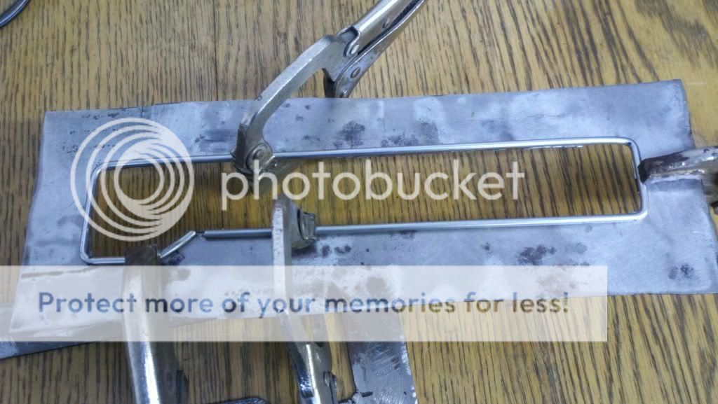

Thanks everyone. I am far from being good at fab'ing panels but I am learning and trying. Here is how I set up my last modification to recess the side markers. Got the round rod welded to the patch and the patch about 90% welded in but ran out of wire. Only have the one pic right now, but it gives the general idea of how I did it. I like this way much better than the other way I did the other side marker opening.
