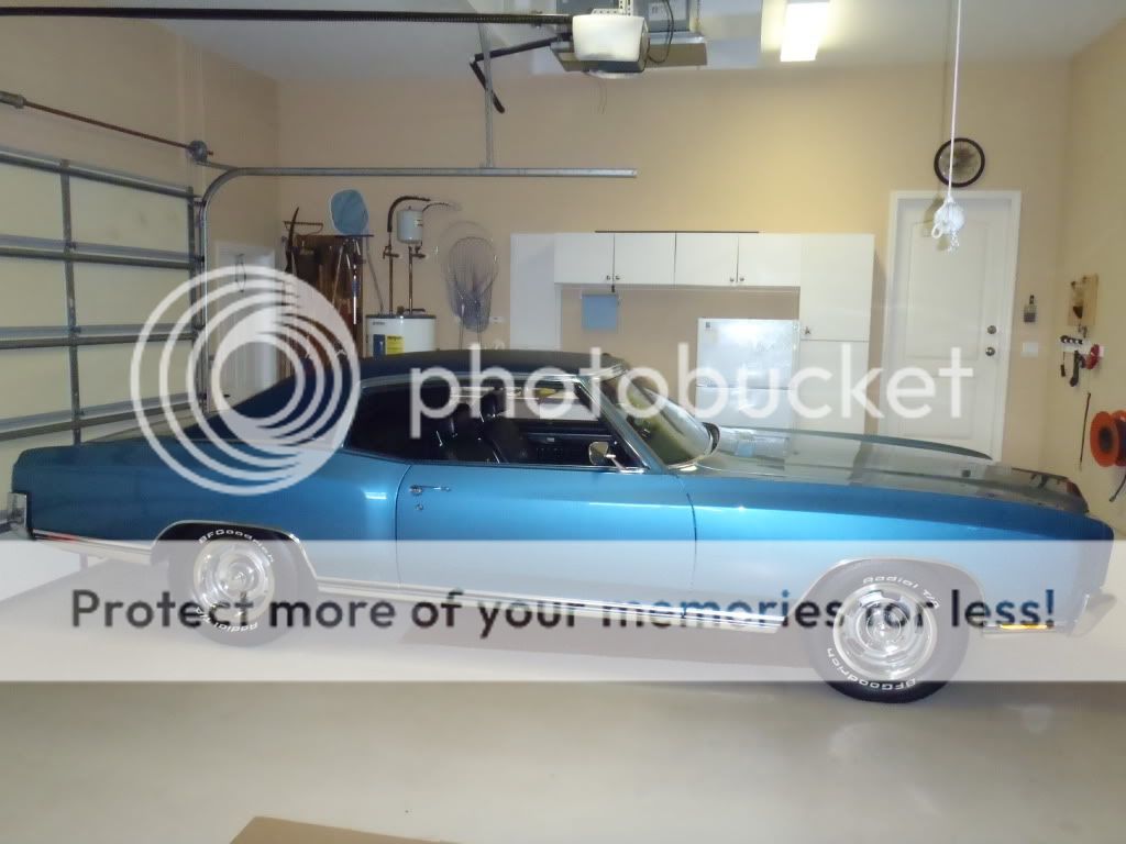

So I would like to start a post, about everything regarding my suspension. I will go about editing it to include more information and making any corrections or adjustments. But this post is going to be my suspension project post. I'll take you guys through my full process of rebuilding my whole suspension and all the suspension mods that will be taking place as well as including a parts and price list in this original post so that if anyone else decides they like the look, or feel of my car, they can see exactly what I have, and how I put it in.
Essentially this is how I would like my suspension, slight lift in the rear to make it look more aggressive, or for drag racing. And a secondary frame airbag suspension in the rear, in case I ever need to tow anything.
So far, here ar the suspension categories I know. Please please please if I'm missing something feel free to write the part that I'm missing so I can do the research. Or if there are any parts you recommmend for this type of set up, go ahead and post it.

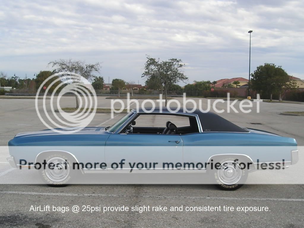

Have you considered the Air Lift 1000 set up for your rear coil springs? For under $100 (possibly including tax and shipping), you can probably satisfy your stated objectives above. Unless you can find or have constructed a Class 2 frame hitch for your Monte, I doubt you will need the heavy duty towing set up you identified in your initial post. On the other hand, if that's what you really want and money's no object, go for it.
I installed the Air Lift 1000 system on my 4-speed car three years ago and have been very pleased with it. While I haven't done any towing or drag racing with it, I have experimented with the air pressure levels in the individual bags to get the ride height/stance and handling I prefer.
When I was running 245-60s all around, I used 25 psi to get a slight rake.
When I switched to 275-60s on the rear and 255-60s on the front, I dropped it to 15 psi in the Air Lift bags to get the stance I wanted. Lots of possibilities ...
